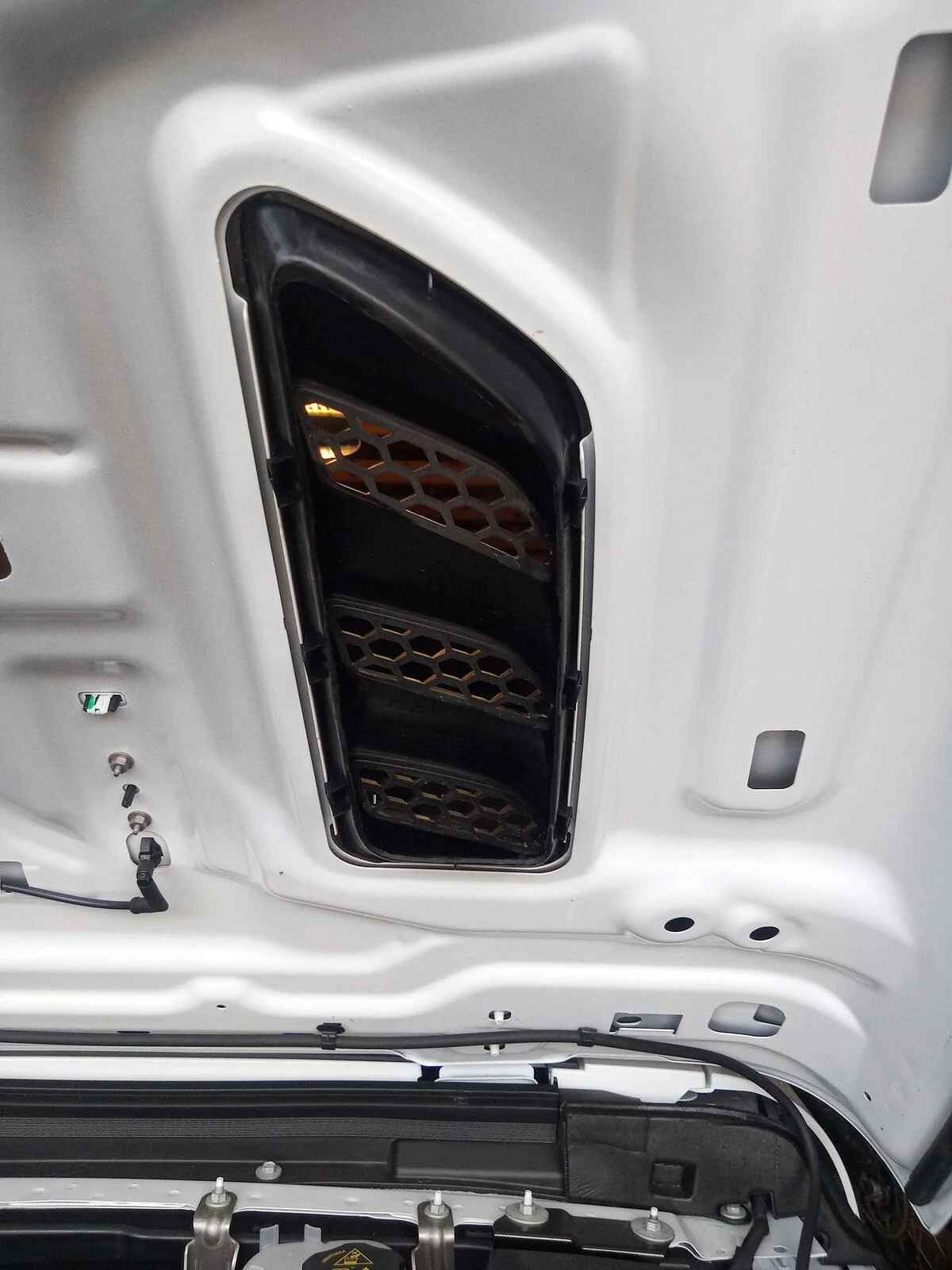

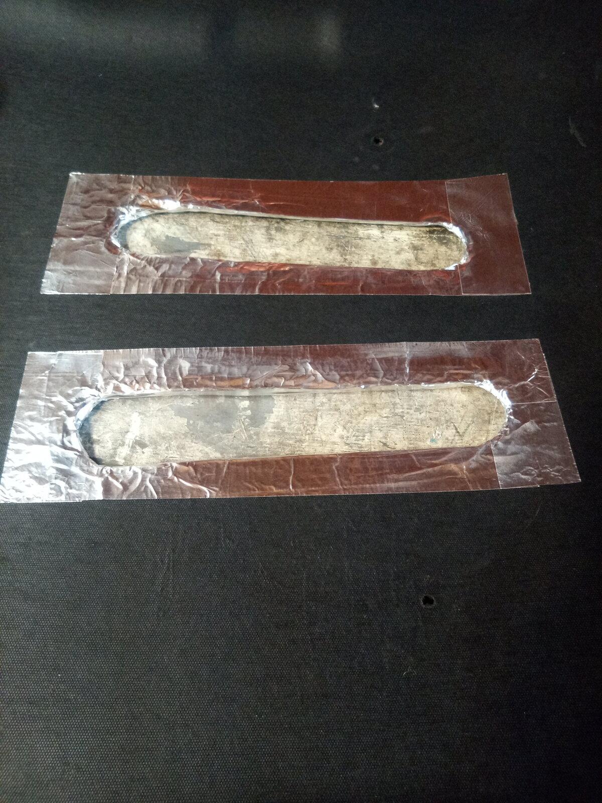

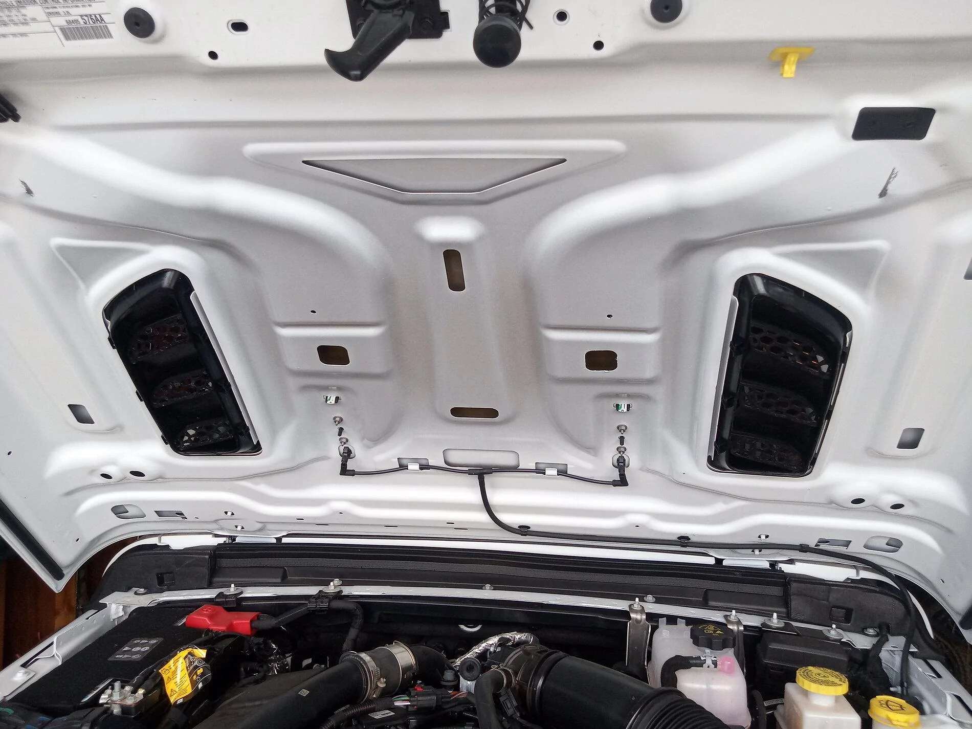

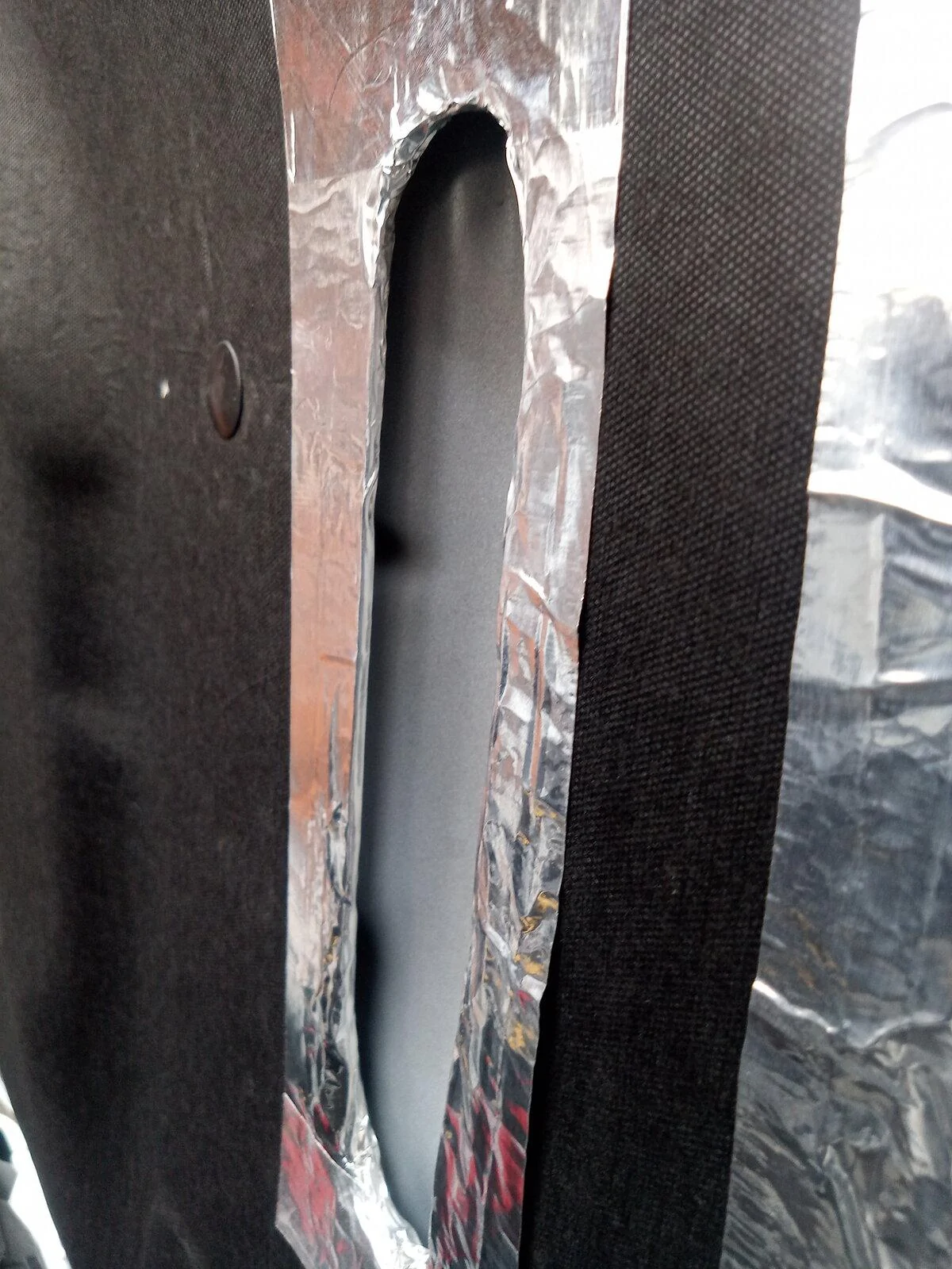

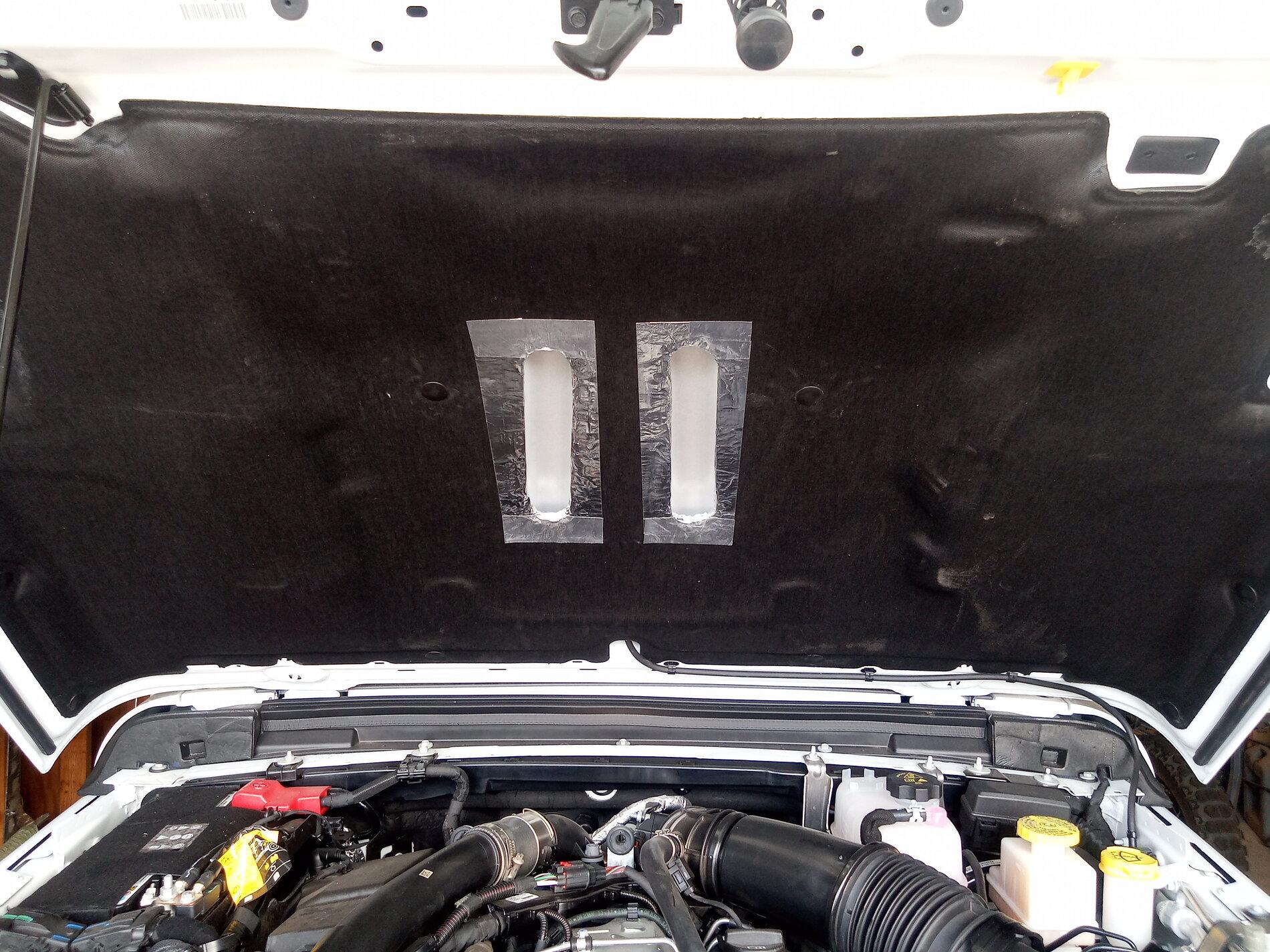

my plan is to pop my ruby vents, cut the bottoms out for full vent and then cut a 3x12 slot down the center of the hood insulation. The slot in the center should give the heat a chance to get pull out the vents but also allow any water ingress from the vents to be sheeted off the back of the insulation to the side of the engine.

Just did a 1000 miles this weekend going from tucson to silverton co (lots of mountains) doing 80, with temps in the high 90's.
Engine and oil temp never crept up and never had a derating after a short stop. I would say it's working for me. Time will tell.

Same time jeep isn't going to throw on a ruby hood on every diesel jt cause that costs more money and the customer won't pay. When I popped the insulation to remove my vents the underside of the hood sure looks designed to take advantage of leting air move through channels stamped in the hood leading to the vents if they were open. The vents were also molded in a way to sure make it easy to cut them open. Some times engineers sneak things into their designs to allow users to mod on their own and deflect MPG/EPA/penalties on to the users and aftermarket.
If they truly didn't think the hood vents would do anything why go through all the trouble of doing a mold where all the grille holes are open and there is a bottom cover plate? It would have been easier to just stamp a single layer faux grill with no holes no bottom plate.
I will try to remember to stick a meat thermometer into the hood vents holes to see how much heat is coming out.
