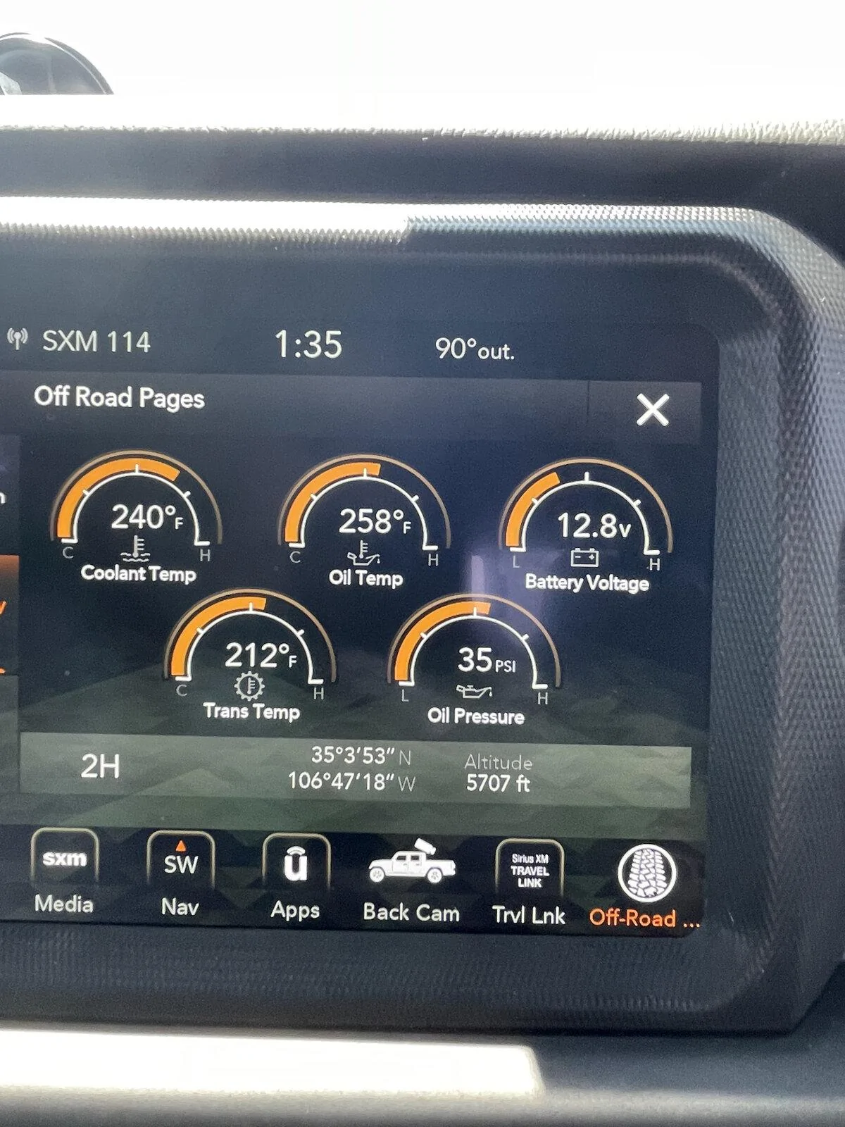

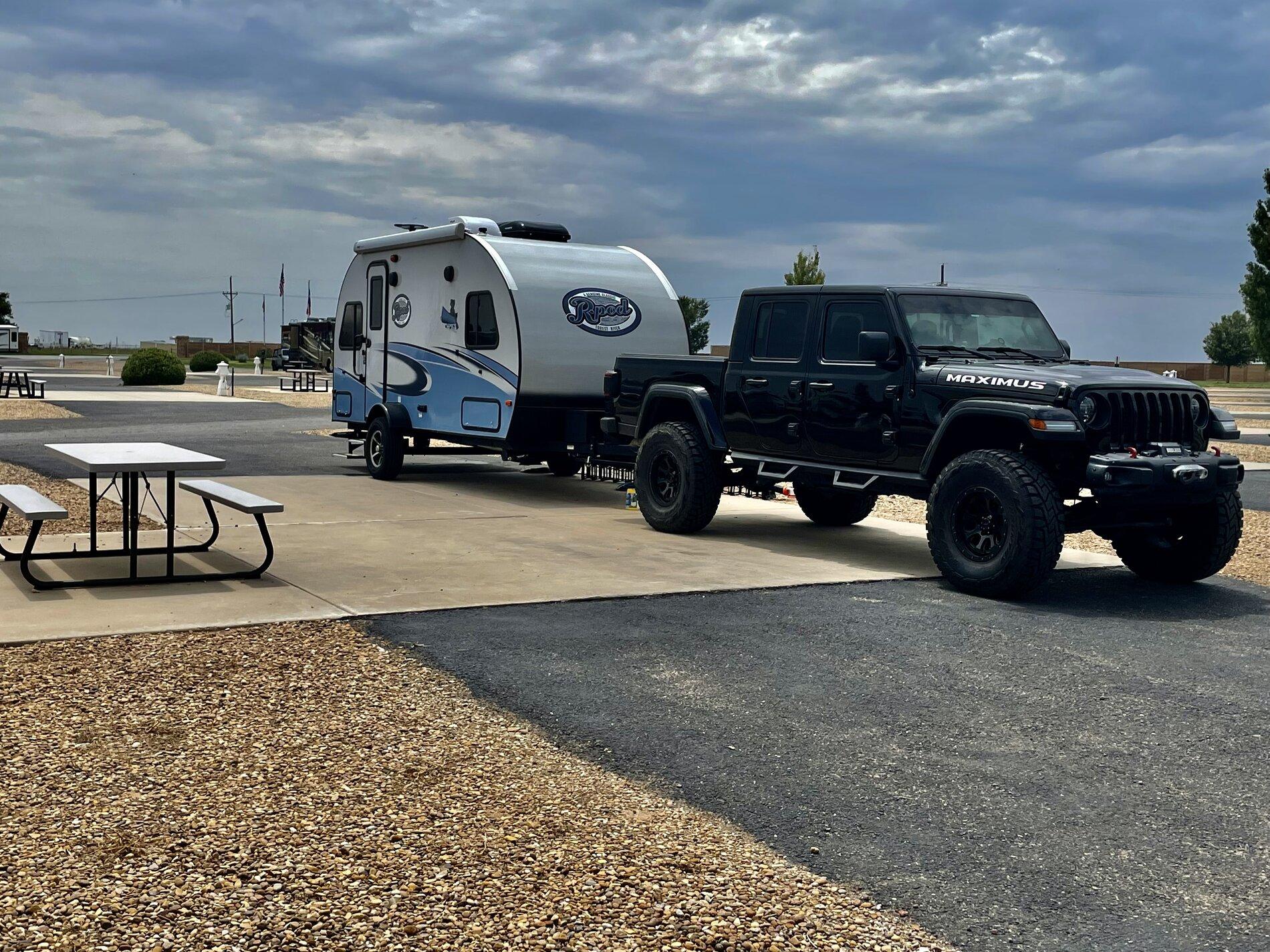

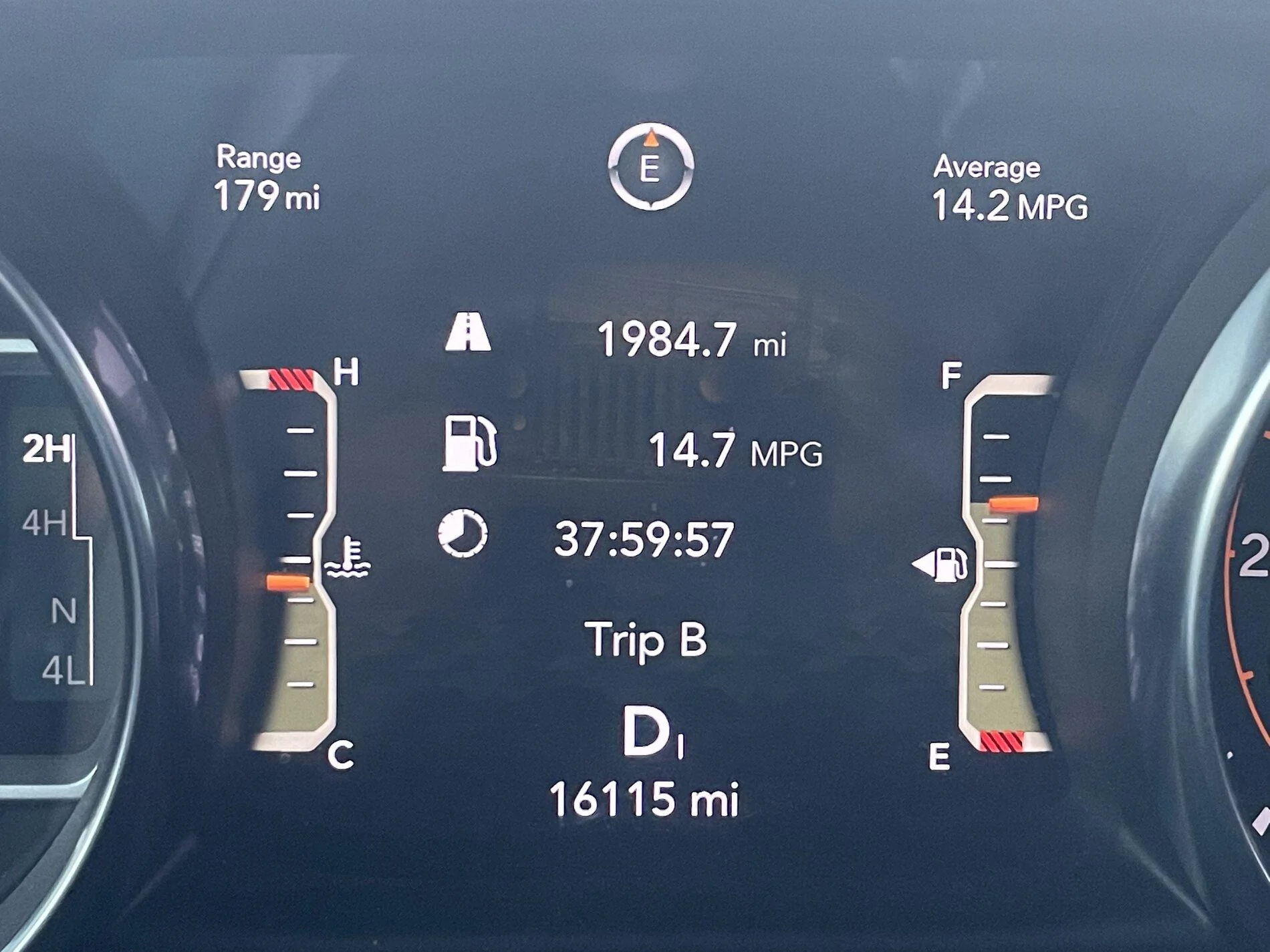

I have 16,000 miles on my JTD. It has a 4” lift and 37’s with stock gears. I left Florida last Sunday and arrived in Moab today. I’m towing a 3,800 lb Rpod 189 and maintain 65 mph without using cruise or the AC. The temps were up to 95 degrees and so far I’ve climbed up to 7k feet. No derating issues but I do monitor the temps.
I typically see temps at:
225 coolant
235-240 oil
208-210 trans
this was the highest temps that I’ve seen and it was after a long grade. Nothing too bad yet, we will see what Colorado brings next week.
I did see decent mileage that I’m happy with.

You were right there........another couple of mins under the load, couple of degrees warmer, or ac on and you would have slowed way down when oil temp reached 260.
I agree 100% and actually expected this to happen. I did notice that the AC would increase the temps a bit and cruise tends to hunt 5-6 gears on a climb.
Trust me I wish it would stay cooler regardless and I’m interested in ways to achieve this. Just posting what I’ve experienced so far.
