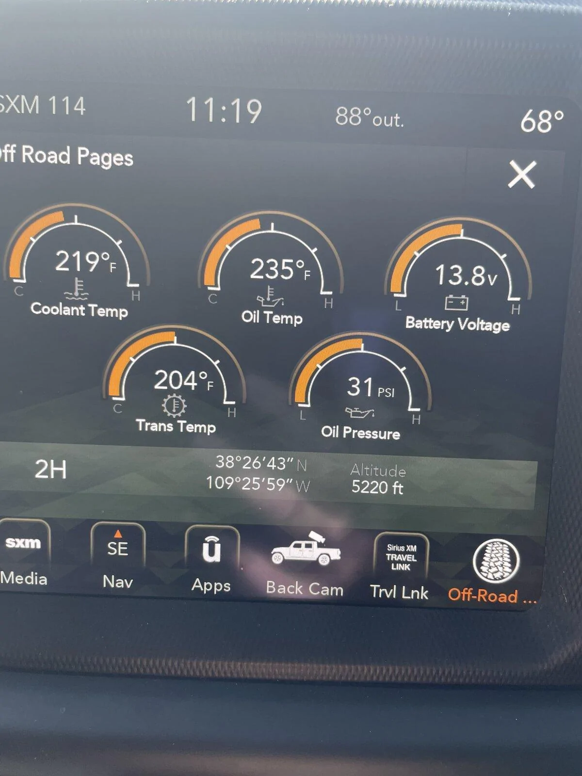

Today I made the drive from Moab out to Elephant Hill to ride that trail. I was surprised at how hot the temps got even without the trailer in tow. This was after a slight grade at 65 mph with the AC on

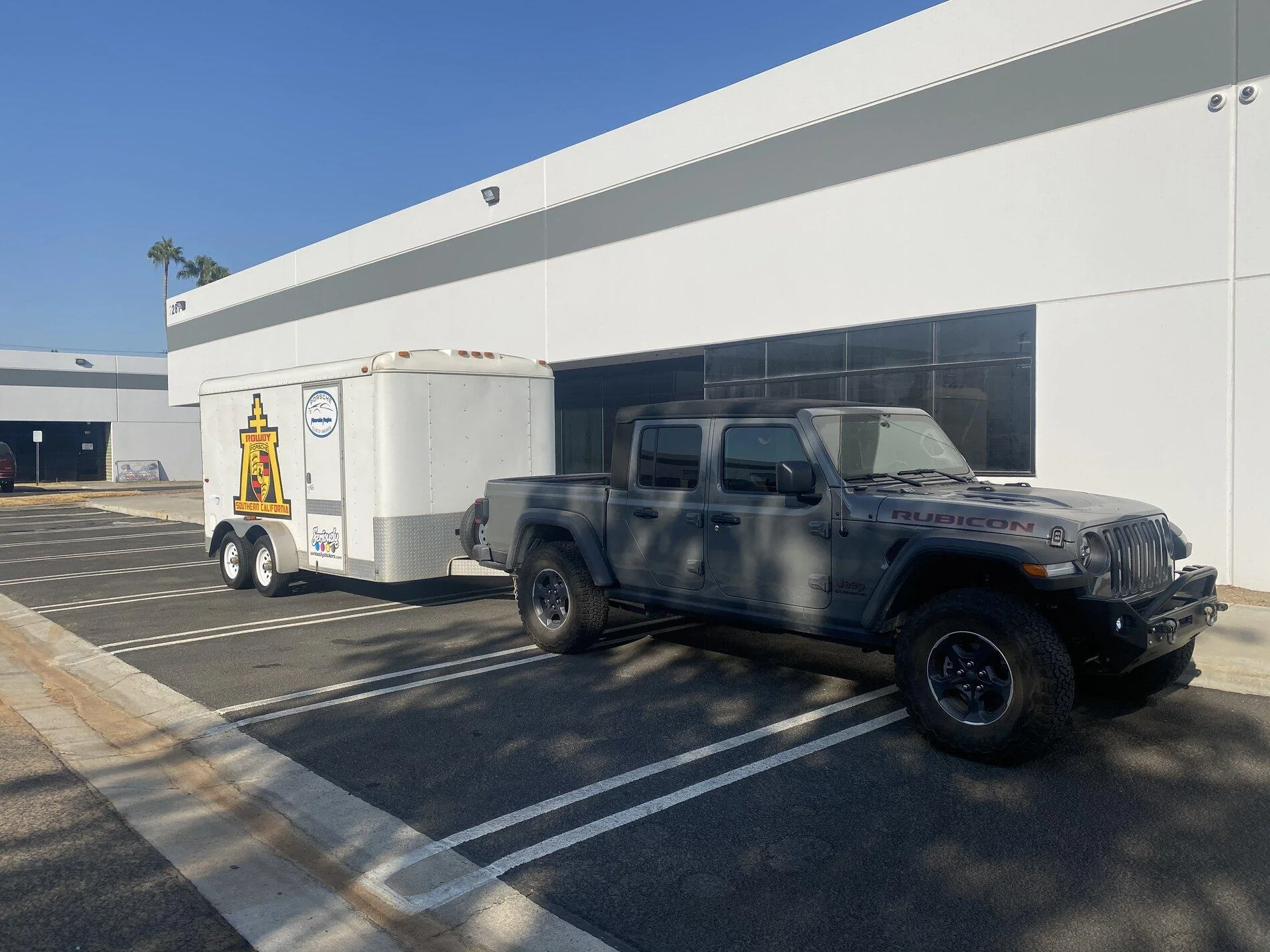

After watching this thread and others like it I had the opportunity to run a similar test with my 2021 JTRD. First off the truck is on 35’s but is otherwise stock and just turned over 12,000 miles. Secondly the trailer was a 16 foot twin axle utility box trailer that added quite a bit of frontal area. Crammed clear full of household goods, washer dryer, fridge raider, books tools etc.Didn’t scale it but had to weigh 5000 pounds at least..
The climb was Colton California, to the top of Cahone pass, roughly a 4000 foot elevation gain in 25 miles the last six of which are 6% grade. Ambient air temperature was 102°.
Highest observed temperatures on the truck or 240 for coolant, 262 oil, 214 trans.
The truck never D rated or even really slow down. I held it at around 65 miles an hour with the AC on and use the manual feature of the transmission to down shift to
maintain the speed without having to use full throttle.
Interestingly I’ve pulled a heavier trailer up that same hill in the winter time and never even paid attention to the temps using seventh and eighth gear to climb with So maybe the secret for me was the fact that I use the gearing to avoid working the truck so hard.
Ran the exact same climb the next day temp still at 102 and push the truck harder but it still didn’t Derate probably because I just can’t make myself use full throttlewhen not needed Anyhow hope this helps
