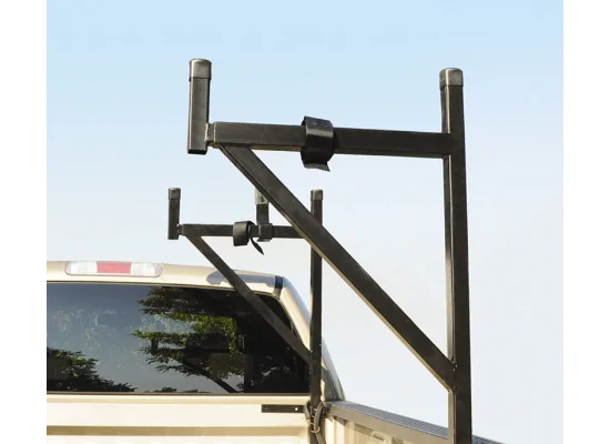

Looking for a way to haul my wife's paddleboard and my surfboards without pulling the back panel on the soft top and passing them through. I used to have this type or rack on several of my pickups growing up and wondered if anyone has or has seen something like this that addressed the wheel well obstruction in the front of the bed, as Thats where the forward rack would be mounted. I might have to contract a fabricator to make something. The best part about these racks in my opinion is that they won't interfere with the soft top and you can take them down very easily below the bed rail when not needed for a clean look.

https://www.etrailer.com/Ladder-Rac...O3ktsMhc1lryLiOxp9-Z5Cl28asarQV8aAmPHEALw_wcB

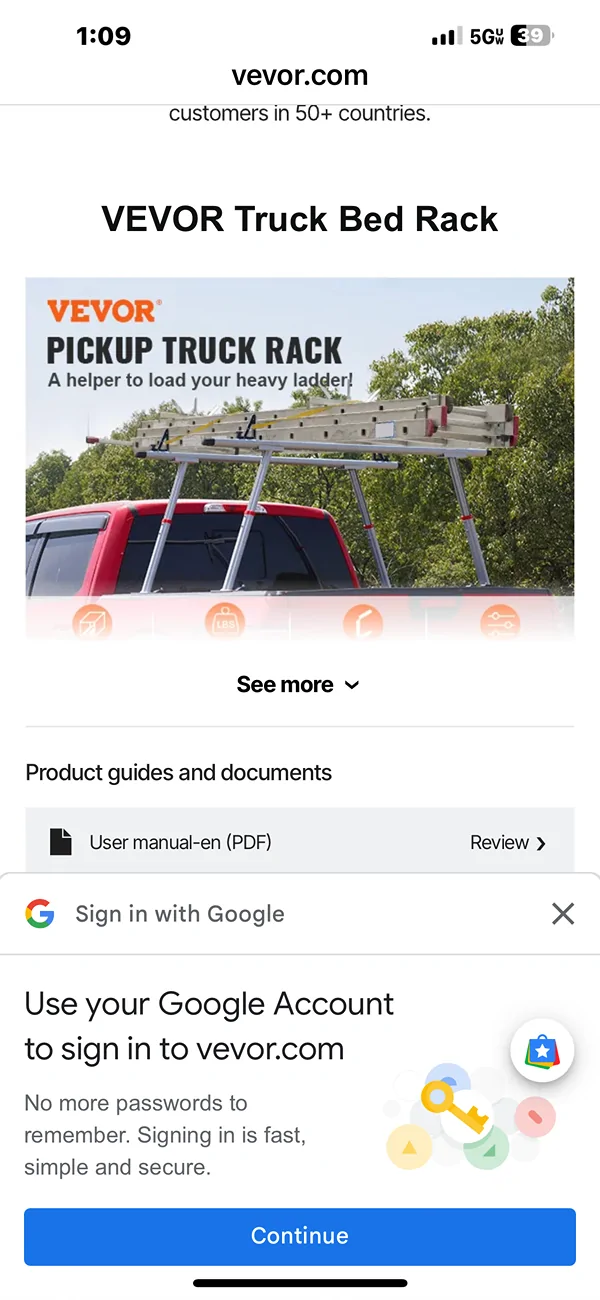

God, Yakima is proud of those racks like $1200, perhaps something like this at $228?

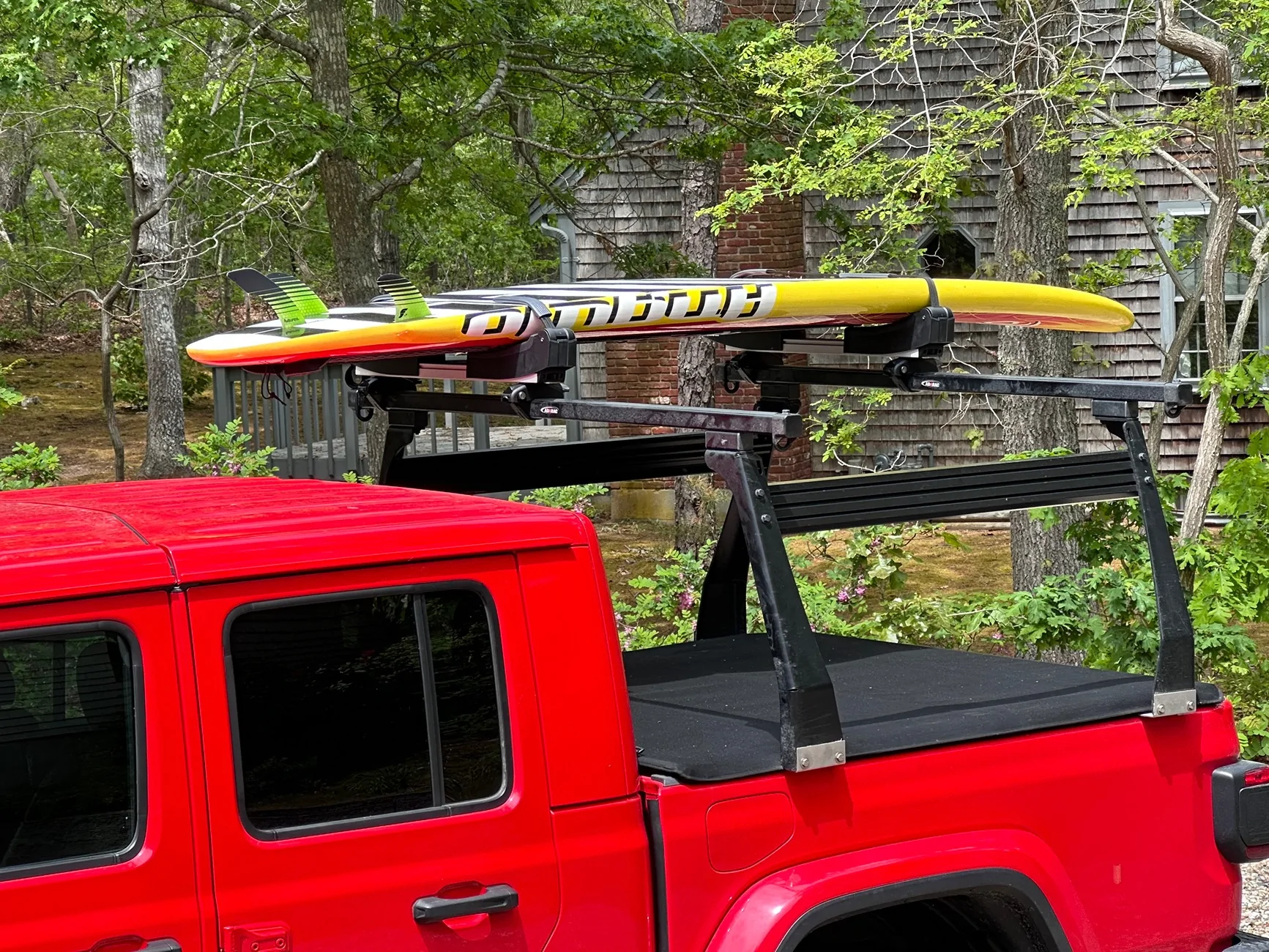

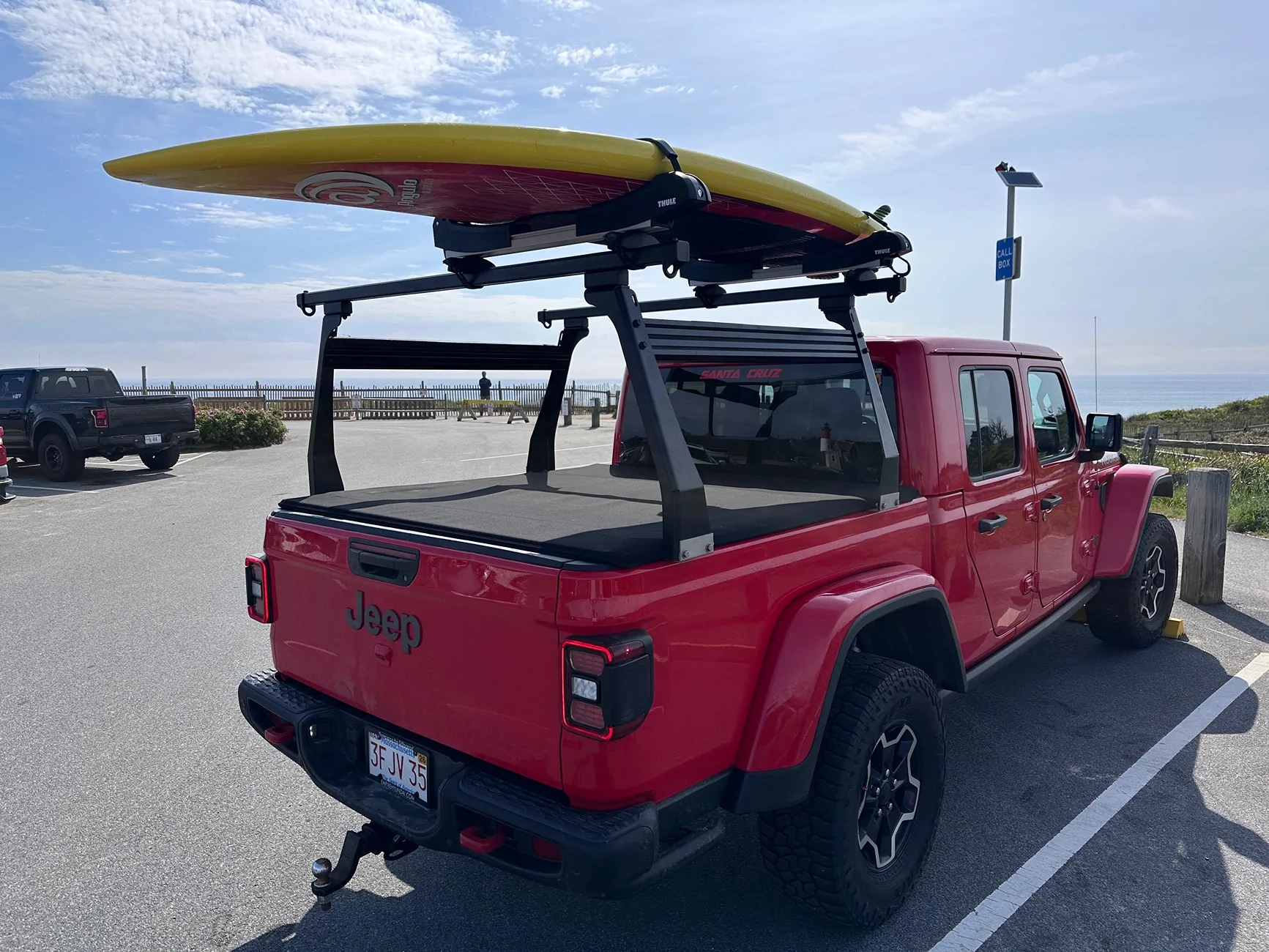

I have a setup that does what you are looking for. I use the Agricover Adirack aluminum series, but ordered the uprights for an F-150. This gives taller uprights and wider crossbars. I added the height extending accessory blocks, and use a Thule SUP Taxi on the cross bars. It provides plenty of clearance for the soft top in the open position. For surfboards, I just use extra thick rack pads on the other side, and it provides enough clearance. In my application, I fabricated custom mounts so the tonneau cover would still work, but the stock bedrail mounts would work fine as well if you don’t care about that. The SUP Taxi is a very nice way to secure the board, quick, easy and locking if you need that. Sorry I don’t have shots with boards on and soft top open, but I used it that way all summer and it was great. Note that I added the Adirack Overlan Rack Accesory (the horizontal aluminum T-slot bars) which really stiffen up the racks and make them super solid. I highly recommend that accessory.

That actually looks pretty good! Thanks for the info, I'll check the system out.
