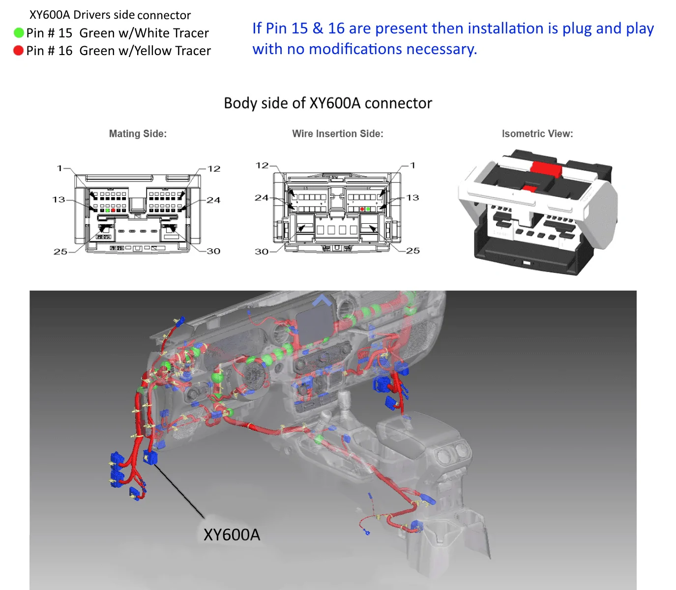

Hi Debra,
When looking at the side with the pins we would want to compare that with left side connector shown below listed as the mating side
Jeep Gladiator Passive Entry / Proximity Keyless Door Entry Install - Success!!! 1695861209777

You're very welcome. As a prerequisite, unplug your door harness at the bottom A pillar and see if you have wires 15 & 16, picture as shown. If you do, then it should be all plug and play, just like mine.

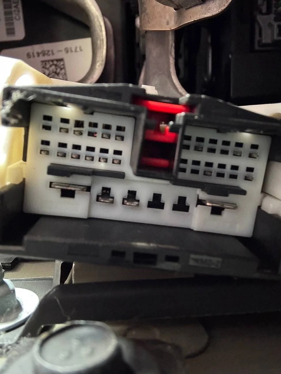

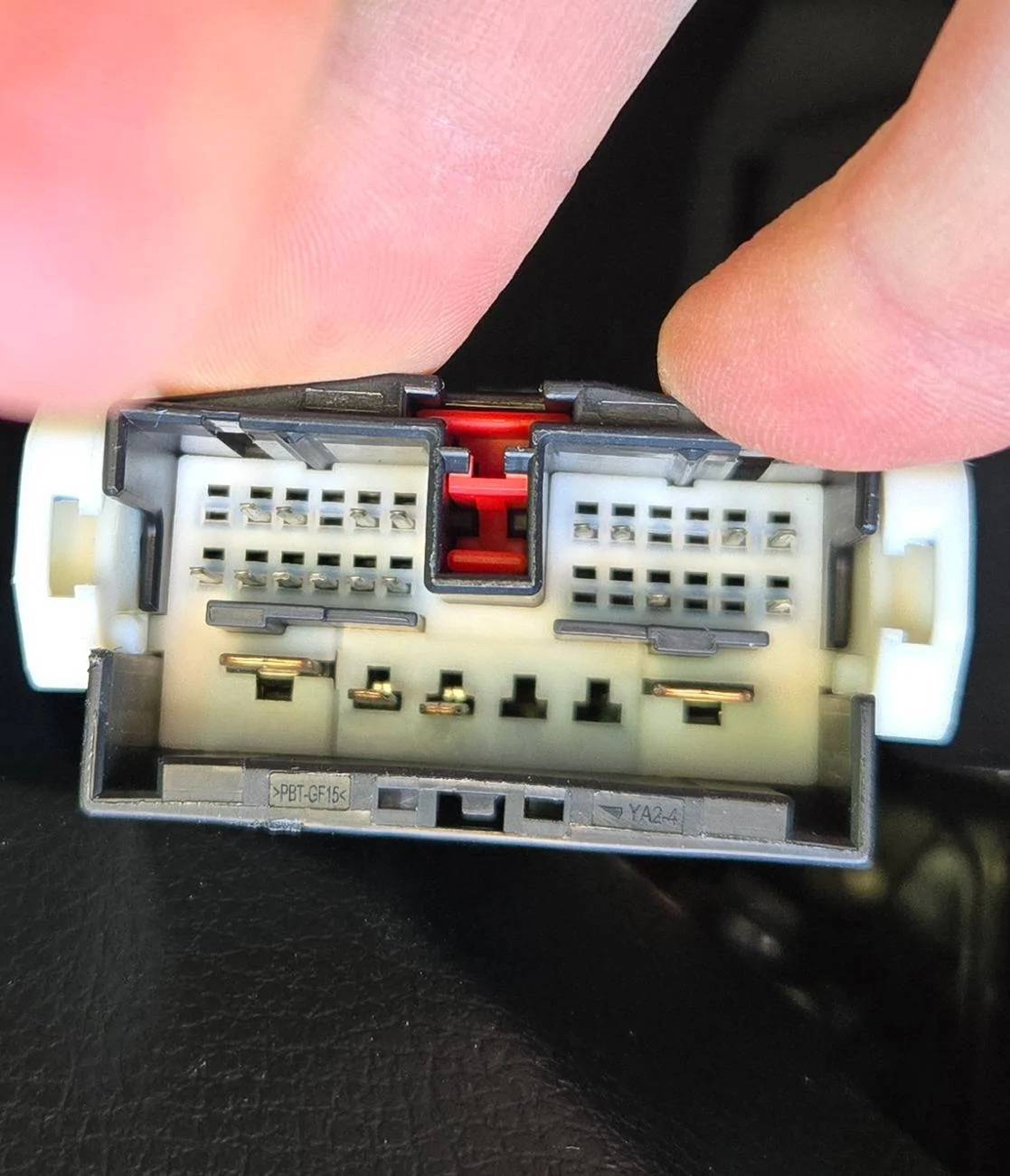

About to attempt this mod but want to verify my vehicle is setup for it first. I think I’m comparing the diagram to my connectors properly, and if so, I do not have PINs 15 and 16, right?
Jeep Gladiator Passive Entry / Proximity Keyless Door Entry Install - Success!!! IMG_9294
Jeep Gladiator Passive Entry / Proximity Keyless Door Entry Install - Success!!! IMG_9291

You do have pins 15/16. It also appears you have a bent pin you would want to address. I will send you a code you can use for our kit.

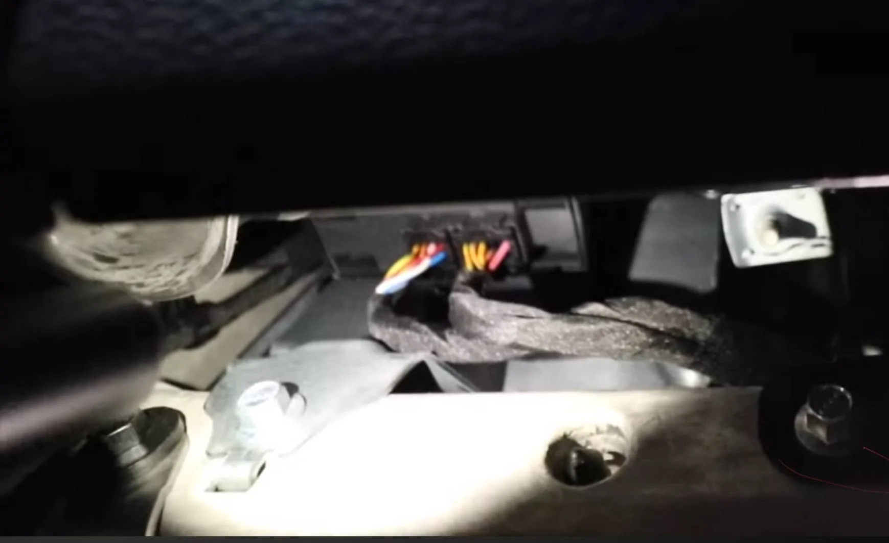

It was these little SoBs, but I finally got them out with some needlenose channel locks. Had to remove the panel under the steering wheel to make more room though, and even then it was a tight squeeze.

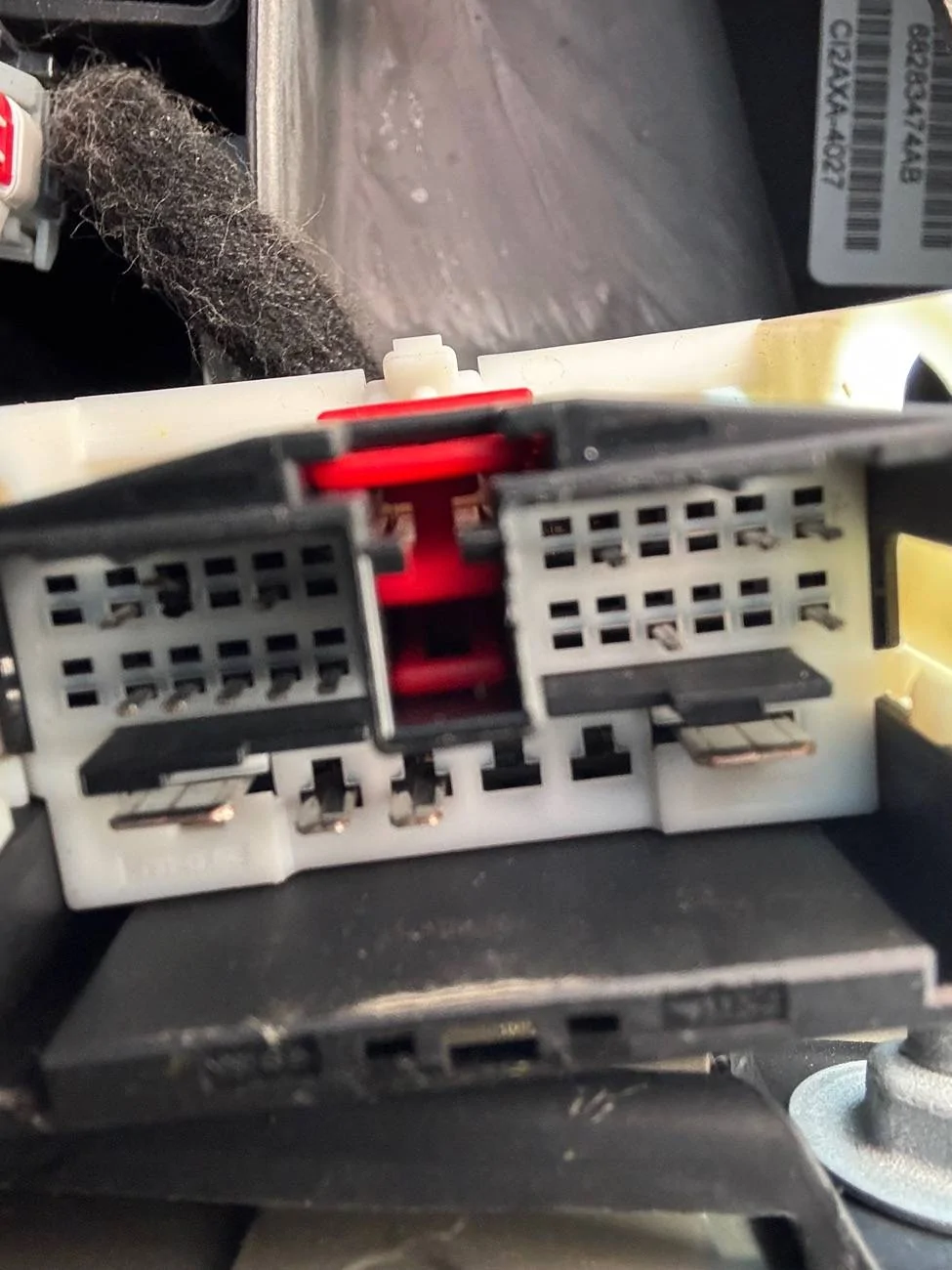

It's looks like i have pins 15 and 16. Is this true ?
Jeep Gladiator Passive Entry / Proximity Keyless Door Entry Install - Success!!! Screenshot_20250220_092241_Gallery
