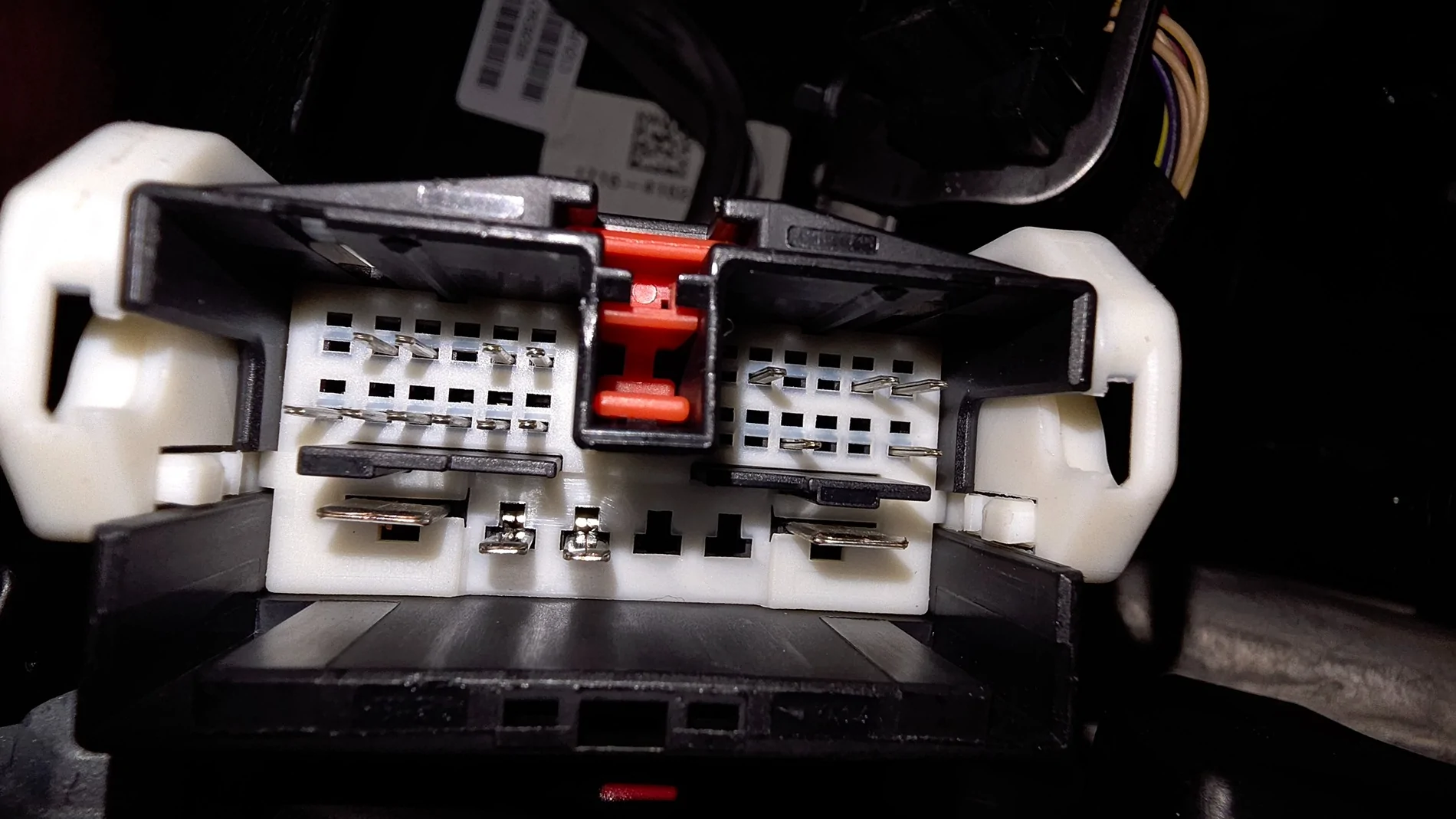

Hi Benny,
Could you please confirm pins 15 & 16 for me? I think they're present.
Jeep Gladiator Passive Entry / Proximity Keyless Door Entry Install - Success!!! 21792
Also I got excited and already ordered the kit. Is it too late to ask for a forum memeber discount? Thank you very much for all your help in this community!
For everyone as a whole, I plan on doing this with a tazer mini. If the pins are there, and I install the handles and harness', is it then as simple as navigating the tazer menu to enable this setting and requires no dealer intervention? Thank you all very much!

Hi Benny,
You have pins 15 and 16.
Is it a 2024 or newer ? Seems like all the 24s + are wired for them .
I used jscan to program . It was pretty simple.
Thank you very much for confirming! It's a 2023 Sport S Package. Mainly I was going to use the tazer because I've read about all the other things you can do with it. Does the jscan offer the same modification options?

Hi Benny,
Hi David,
Assuming the photo is not inverted you have the required circuits. I am sorry but we cannot apply discounts to past orders. In the future DM me directly for any other parts needs.
