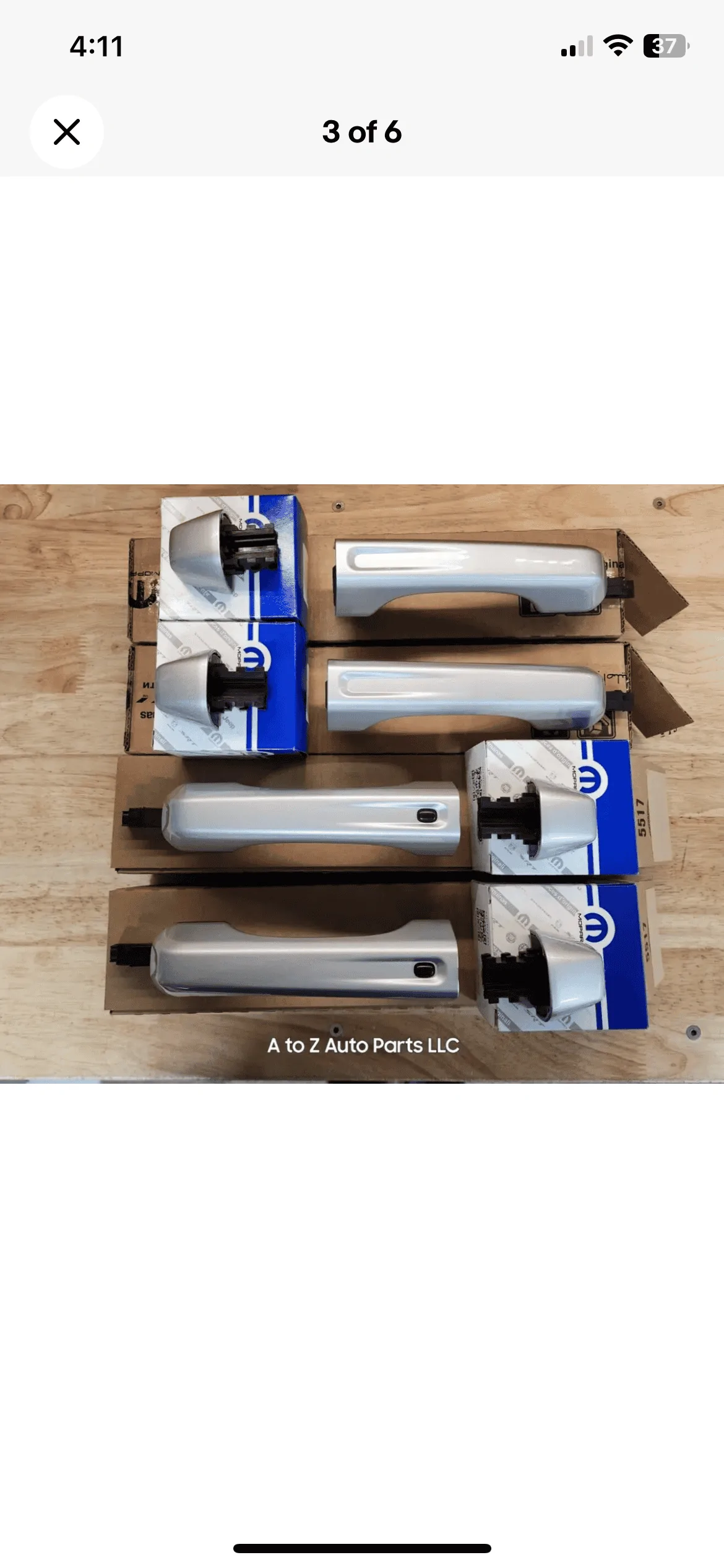

Technically you if the front handle fits the rear, than run 2 wires and splice it into the front handle wires at the door harness.
Edit: According to the photo. F/R handles might be the same. Fitment wise.

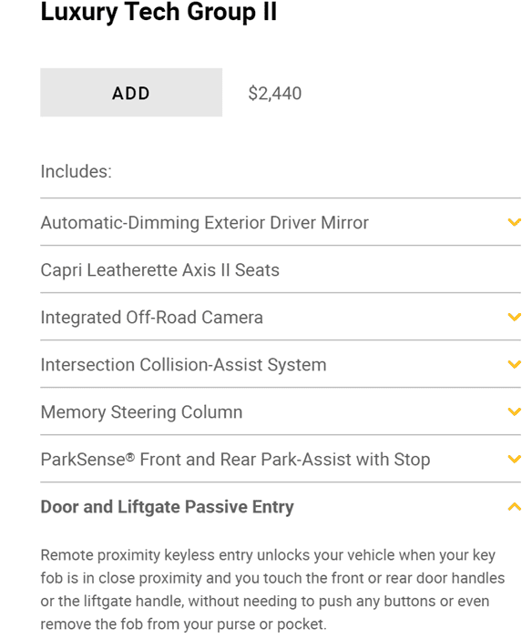

I believe it is if you look at the Lux Tech Group II on a Grand Cherokee LTD.

Ah, then they've either changed things, or added a package.
My wife always got the most "automatic" type stuff she could and if she could have gotten that, she would have.
OK, current offerings I am corrected.
