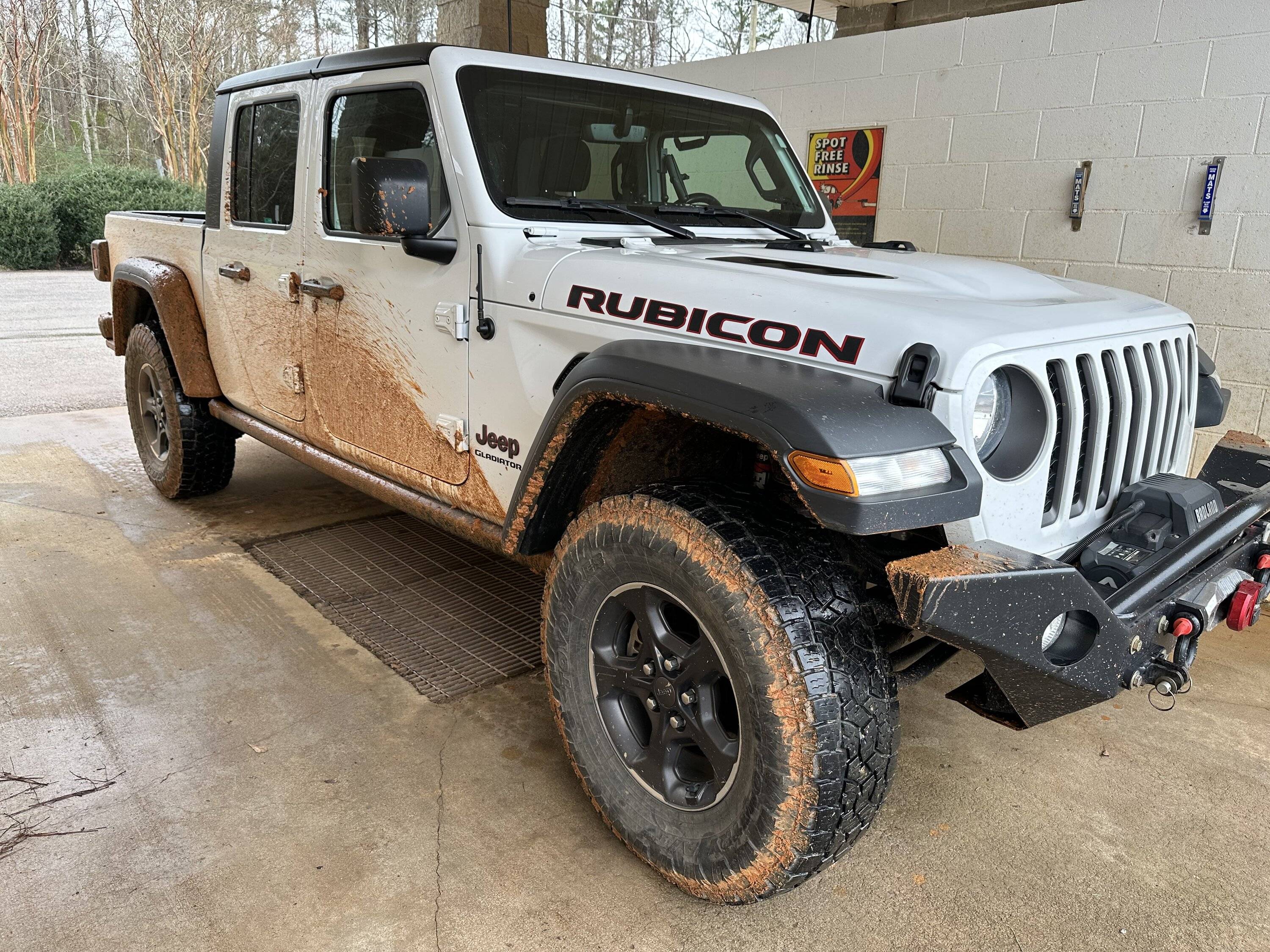

Went wheeling today. Never once thought about Stop/Start. :)
The last place you want that kicking in........... or any distractions, for that matter. Enjoy the drive and view.
