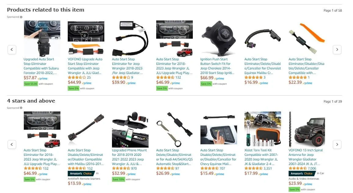

The SmartStopStart device installs under the dash on the left of the steering wheel, like a Tasar. BTW, it is no fun reaching into that spot to remove/replace the plugs. :) I think there are other ways to make the Jeep think you pushed the button. Some seem to install below the radio, inline with the stop/start switch.

I looked on Amazon at some of the devices that fit behind the center panel and install inline with the start stop switch. these are the devices where I read bad reviews. The SmartStopStart device installs under the dash on the left of the steering wheel, like a Tasar. BTW, it is no fun reaching into that spot to remove/replace the plugs. :)

you are making me think about switch function when I could be playing video games. It seems to me like there are multiple ways to accomplish the “turn off the stop start button” automatically. The timer method you are writing about would be a device inline with the switch. The Jeep defaults to on when it starts and the device “pushes the button” to turn stop/start off. I expect that some of the device reliability issues when using this method comes not from the device itself, but from variations of the Jeep starting/boot up procedure, possibly caused by the changing conditions of the components involved in the start.
The SmartStopStart device remembers the last condition of the stop/start button and makes a decision on any necessary action for the next start. In other words, you can set the stop/start button to “on” or “off” and that setting will repeat on all future starts until you change it again.
