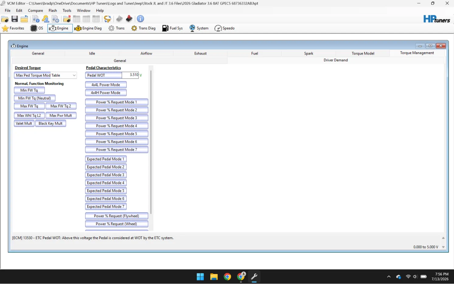

In an effort to back up what I mentioned, here is a breakdown of the pedal tables, and a demonstration of what pedal manipulators do to your Jeep, for those who like good data.....again, there is no substitute for good tuning.....a few of my Gladiator customers (@zuki_dan @DronePilot) had a throttle controller in place before my stuff. And FWIW, I actually tell people to get a PM if they want some extra pedal feel without a tune.
PC and PM and other similar devices operate under one principle. They manipulate the 5 volt canbus signal from the pedal to the ECU. Their circuitry sits in between your pedal and the ECU. The pedal will output a certain voltage between 0 and 5 volts. The throttle controller will convert that value to a higher voltage value for more throttle response, or a lower value for the ECO modes. The sensation as a result "feels" like more torque, but it is just the ECU commanding whatever power it is set to command at lets say 1.0 volts instead of .8 volts.
What is nice about the PM is it gets it's power from the OBD2 port and does not only rely on the power at the pedal itself. This is a great fail safe and a great innovation on their part. Likewise, since it is plugged into the OBD, it can sense when reverse is selected and go back to a normal soft throttle for reverse.
Here is what throttle maps look like to your tuner, mind you, this is the actual data within the ECU and not what a device is interpreting. I used a 2026 Gladiator 3.6 as reference here, but they are the same from 2020 to 2026 for the 3.6 although not every OS has these tables defined....
Jeep Gladiator Pedal Monster 3.6, I'm converted. Screenshot 2026-07-13 195636
The above picture is the Engine>Torque Management>Driver Demand section of a factory tune file Mode 1 is used for normal drive mode. Modes 5-7 are used for off road plus or 4LO typically, depending on year. Power % request is the percentage of available torque you can command. If the torque isn't actually possible, it will never reach this target. Expected pedal is the pedal at which the ECU expects the pedal to be for that power % request. These tables must be directly inverse of each other or else limp mode will occur. These tables can't be modified by any device and can only change via tuning.
At the top there, you'll see Pedal WOT set to 3.510 volts. This is the voltage output from the pedal that the engine considers wide open throttle. On these Jeeps, pedal to the floor is usually 4.1 volts, so from the factory, technically WOT is happening before your pedal is to the floor. As far as tuning goes, any tuner can go in and lower this WOT voltage amount and achieve the exact same thing your throttle controller is doing. All your throttle controller is doing is tricking the ECU outputting a higher voltage.

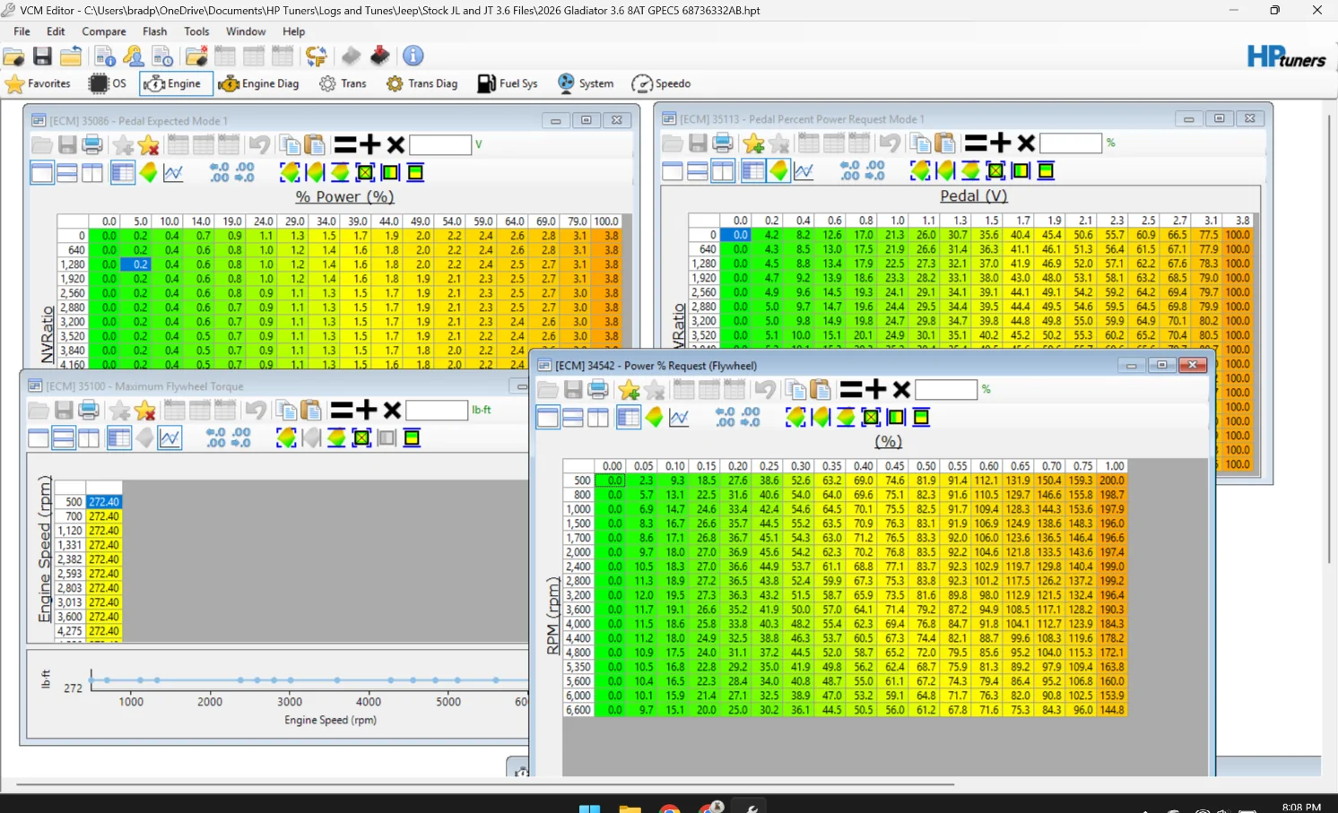

Now lets talk about torque. On stock tuning, maximum torque is set at 272 pound feet, and there are several multipliers and other limiters in place that keep the engine from even achieving that most of the time. Simply upping these numbers by themselves will not get you more torque without the proper VVT and spark timing changes to actually achieve requested torque. I opened up all related tables I could fit for this picture so you can see.........
Jeep Gladiator Pedal Monster 3.6, I'm converted. Screenshot 2026-07-13 200820

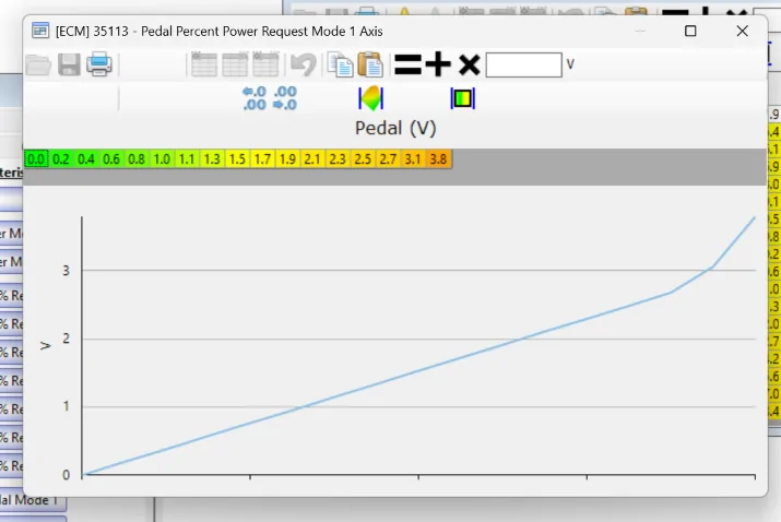

This table cross references the power % request mentioned earlier. Your throttle controller is not changing any of these commands or limits. You can't make more torque without tuning. Period.
Here is a visual representation of the voltage output from your throttle on a stock tune, and the same table as what you may find on a pedal manipulator in it's "sport setting"

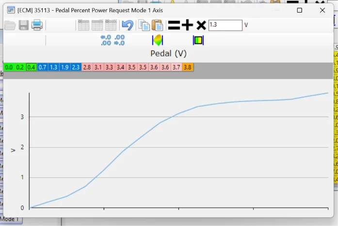

STOCK
Jeep Gladiator Pedal Monster 3.6, I'm converted. Screenshot 2026-07-13 201139
Manipulated by a throttle controller (just for demonstration, your controller isn't actually changing this):
Jeep Gladiator Pedal Monster 3.6, I'm converted. Screenshot 2026-07-13 201331
Hope this helps explain to people weighing the whole tune vs. throttle controller thing. For the price, PM is a great option. But don't get it twisted, it is not adding torque.
