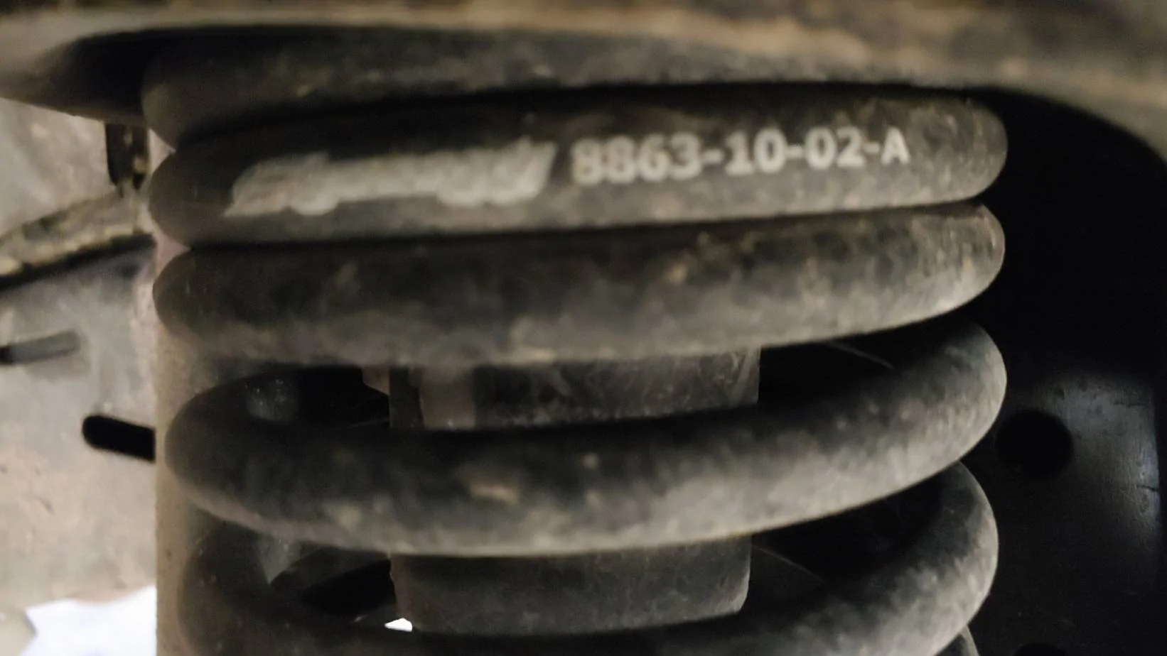

There is also a -01 (left) and -02 (right) suffix on the spring part number and they need to be installed on the correct side. Synergy does something unique in that they shave flat the bottom spring coil that sits on their supplied polymer pad. Part number is on the spring is suppose to face out parallel to the wheel and side body lines.
Yes and I have to admit that when I put mine in, I didn't get them exactly squared as far as the part numbers being directly outward.
I miscalculated where to put the strut compressors and when I got the springs in place, the long parts of the compressors hit the truck's suspension and I forgot to turn the springs a bit when I released the compressors. These springs are long springs - they allow a lot of flex as far as axle droop but that means it's a bit tighter going in or out than some other springs that lift by "stiffness".
Oh, well - that will be resolved when these get replaced with the 2" springs.
These are "guaranteed to not bow". Most coil springs don't push outward with equal force all the way around the circumference of the spring.
Install them correctly, print straight out, on the correct sides with the axle pretty well centered under the truck, they should stay straight.
Needs to be turned toward the viewer's left, it's a few degrees off.

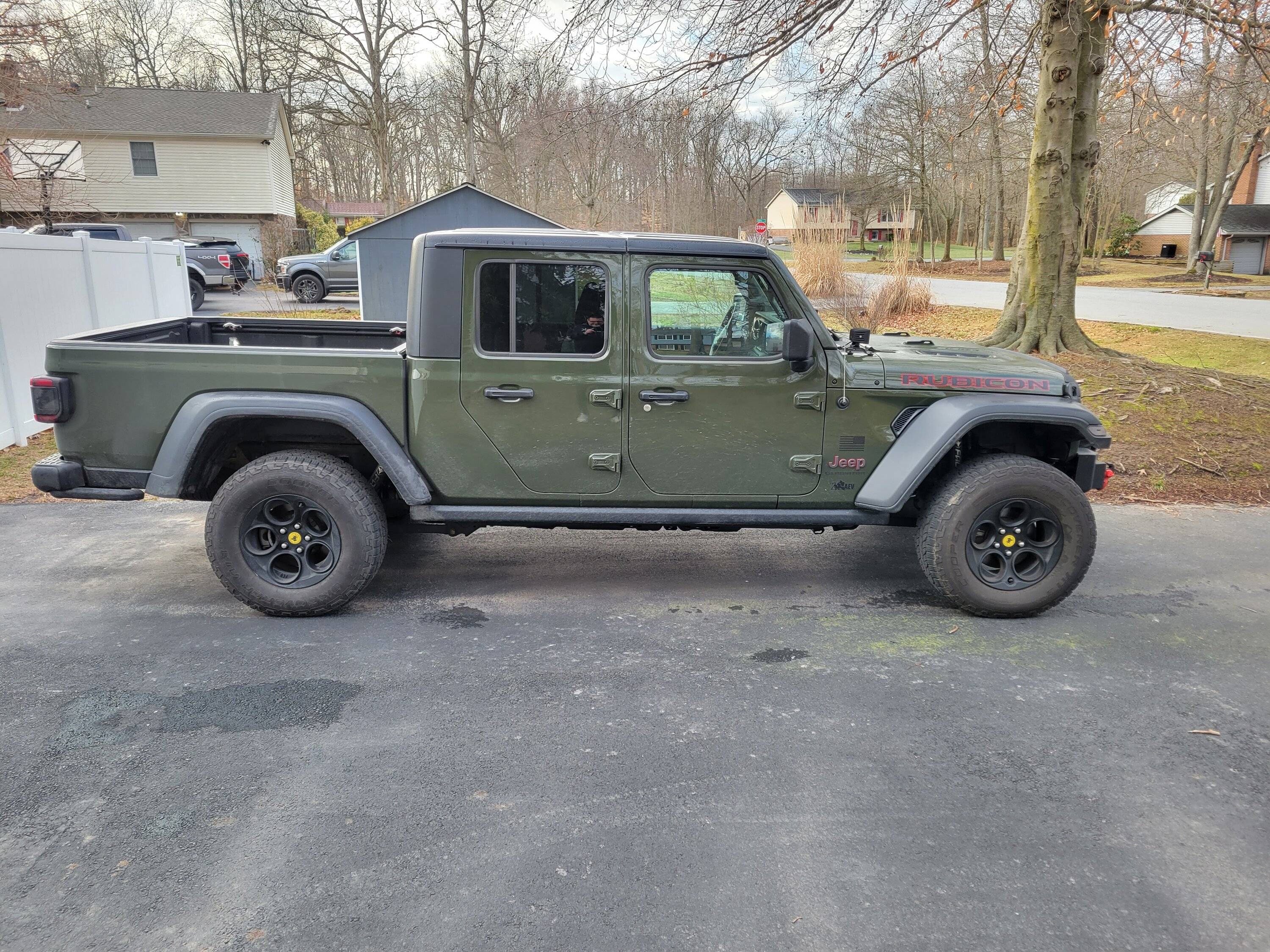

Jeep Gladiator Peer Review: About to pull the trigger on this lift setup 20230127_083449
PS - big thanks to Hootbro for his experience and knowledge on these particular springs - very very helpful. I like the springs - a lot - I just miscalculated on my needs and the weight of my truck vs. a JLU on which the ratings are based.
