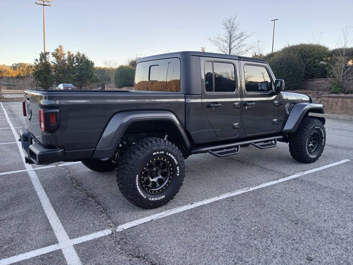

Synergy LCAs installed last Monday. Took a weekend trip to north GA this weekend. Tracked and drove great.
