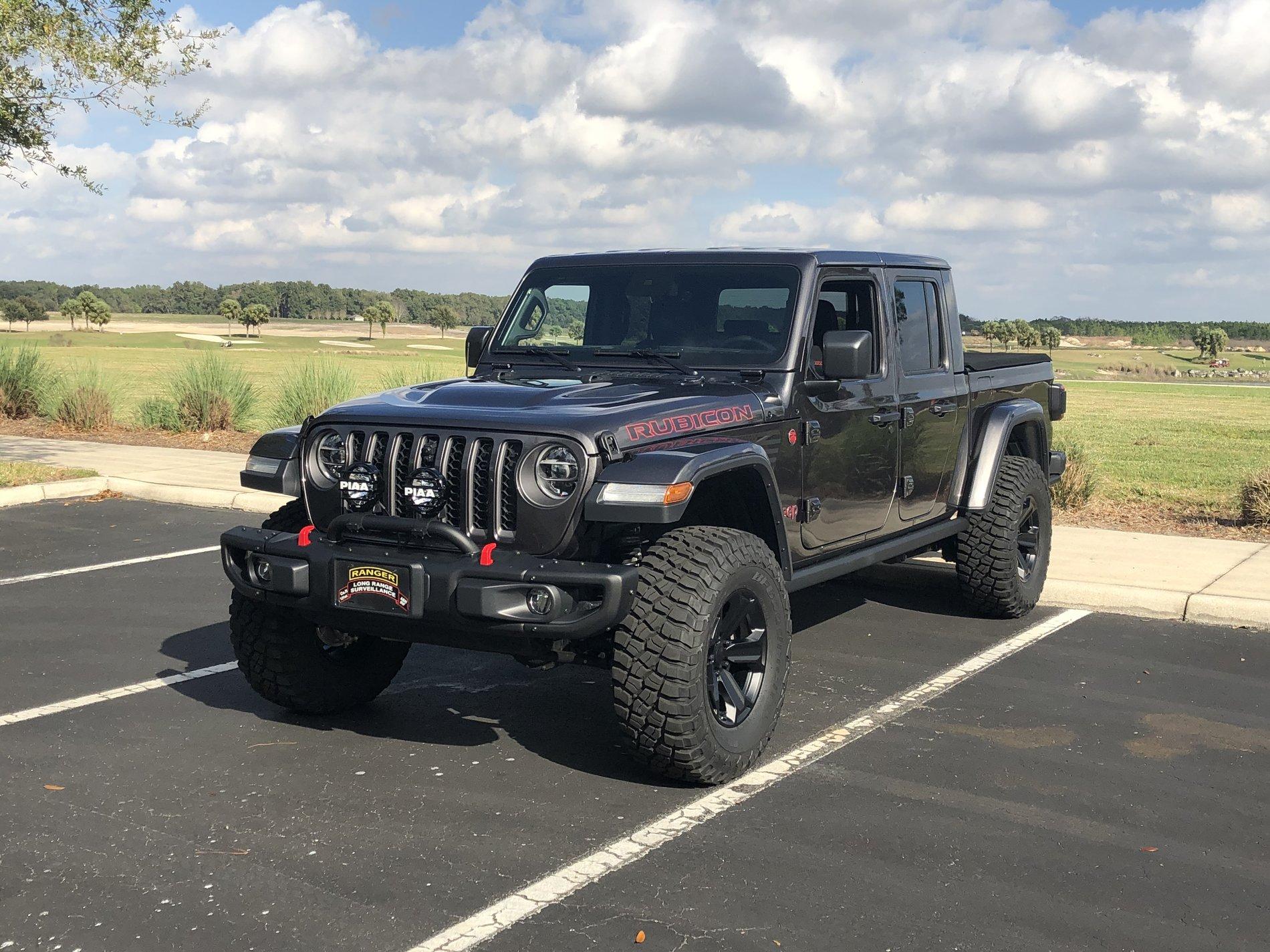

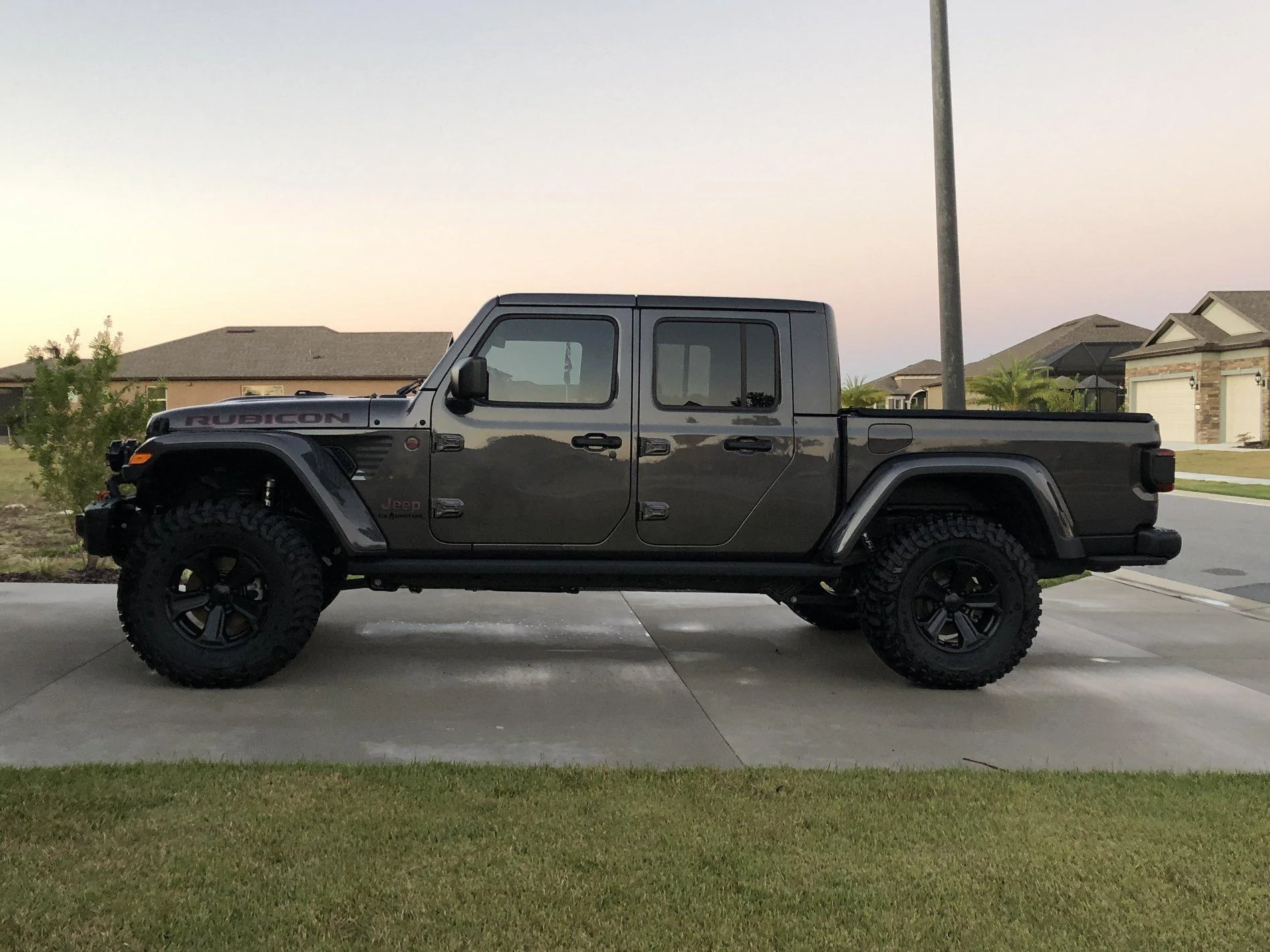

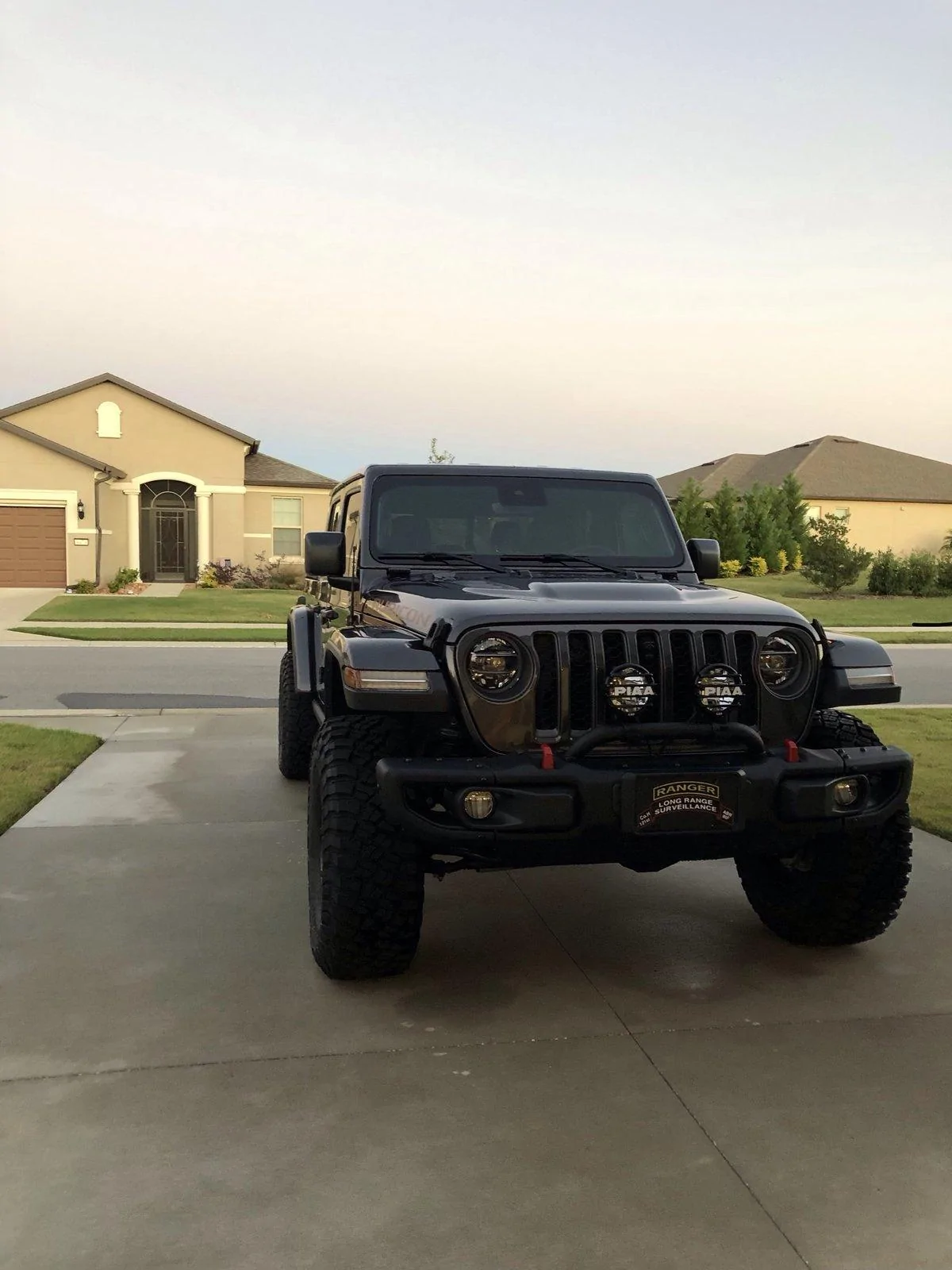

Just recently installed new wheels and tires. Went with 35” BFG Mud Terrain KM3’s on Quadratec Recon 17 x 8.5 wheels. Put on the Teraflex 1.5 inch front spacer and Daystar .75 spacer in rear. Also added the Falcon shocks and steering stabilizer and the Steer Smarts Yeti HD adjustable track bar. That track bar is as solid as they come. Photo was taken in my driveway which has a slight incline and gives the impression the front is rather high; however, on level ground, the truck sits almost perfectly level with maybe a quarter of an inch forward rake. Even with the KM3’s, it drives incredibly smooth with absolutely no shake or vibration. With the Falcon shocks, there is a noticeable difference in the handling compared to the stock setup.

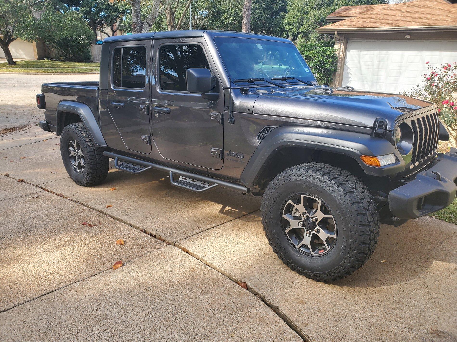

1.5 inch Daystar level with Mickey Thompson ATZ in 315/70R17. Think I may go to a 3.5 inch lift soon, seen several on here with either the RC 3.5 (cheaper option) or the JKS 3.5 (leaning toward this one) that look pretty good on 35s.

Looks great! Have you noticed your fuel economy suffering much?

Believe it or not but I’ve seen NO decrease in gas mileage. I just put over 1500 highway miles on it visiting our kids in Georgia and Tennessee over the holidays since the installation and that’s what I’m basing this on. I noticed prior to changing out the 33’s for 35’s I travelled between Ocala and Gainesville frequently, which is very flat interstate and with cruise control set at 75 mph, the tachometer maintained a steady 2100 to 2200 rpm’s. With the 35’s, that same stretch of road going 75, my tach is showing a steady 2000 to 2100 rpm’s. I’m no engineer, but I believe the 4.10 gears with 35” tires is a perfect “sweet spot”. I know the KM3’s are heavier than the stock 33” AT’s and maybe it’s the engine is broke in (9000 miles), but I love the tires and they ride better and almost as quiet than my Toyo RT’s I had on my ‘17 Rubicon. Was a little skeptical about going with the mud terrain tires because I’m not a really serious off roader but I absolutely love these tires and they look cool as hell!

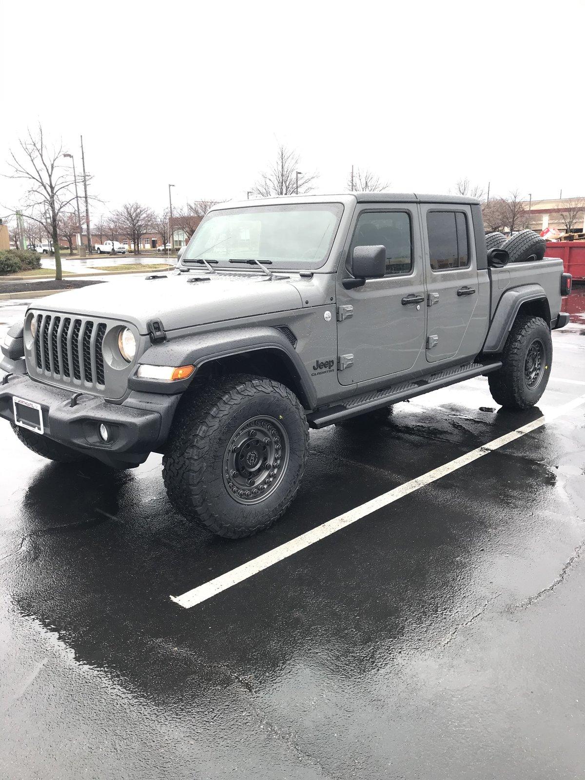

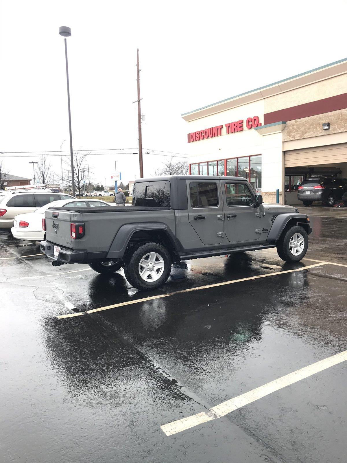

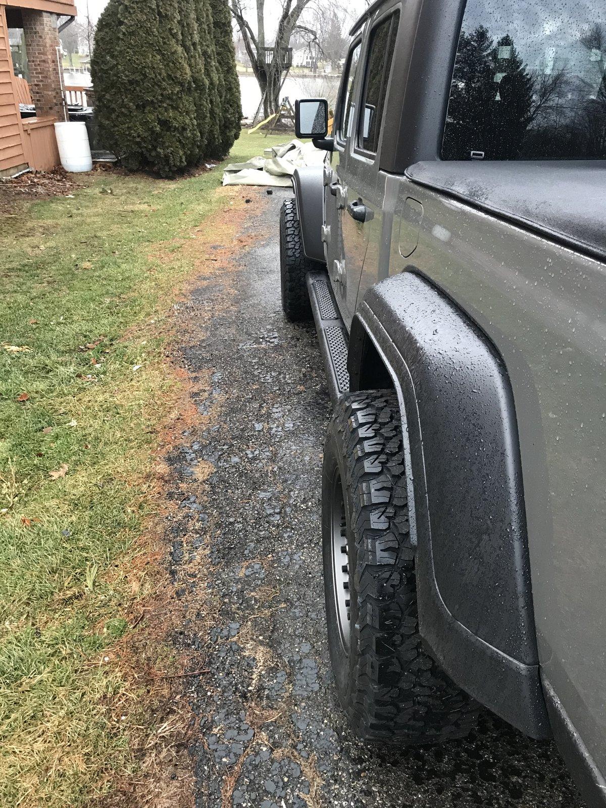

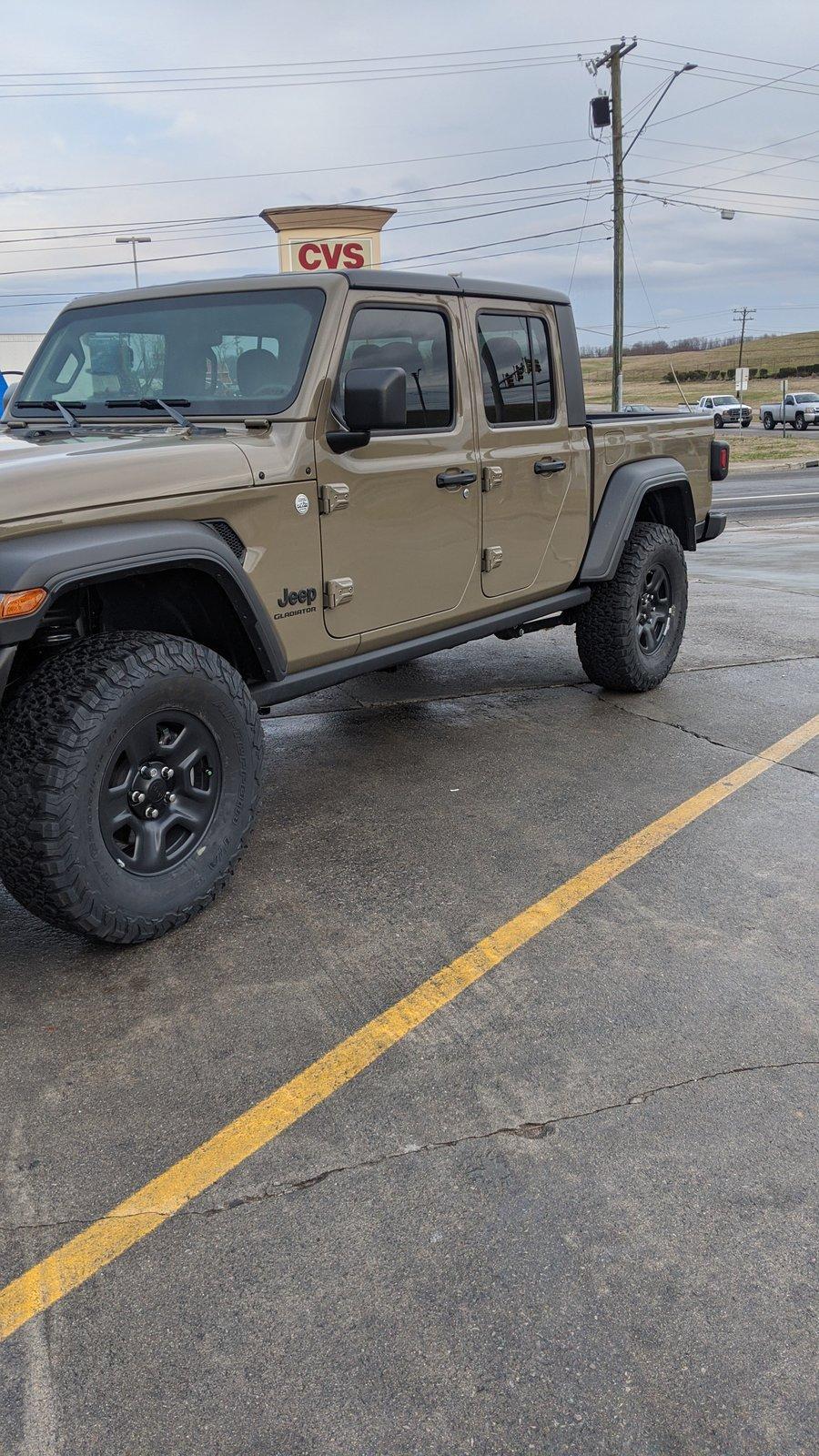

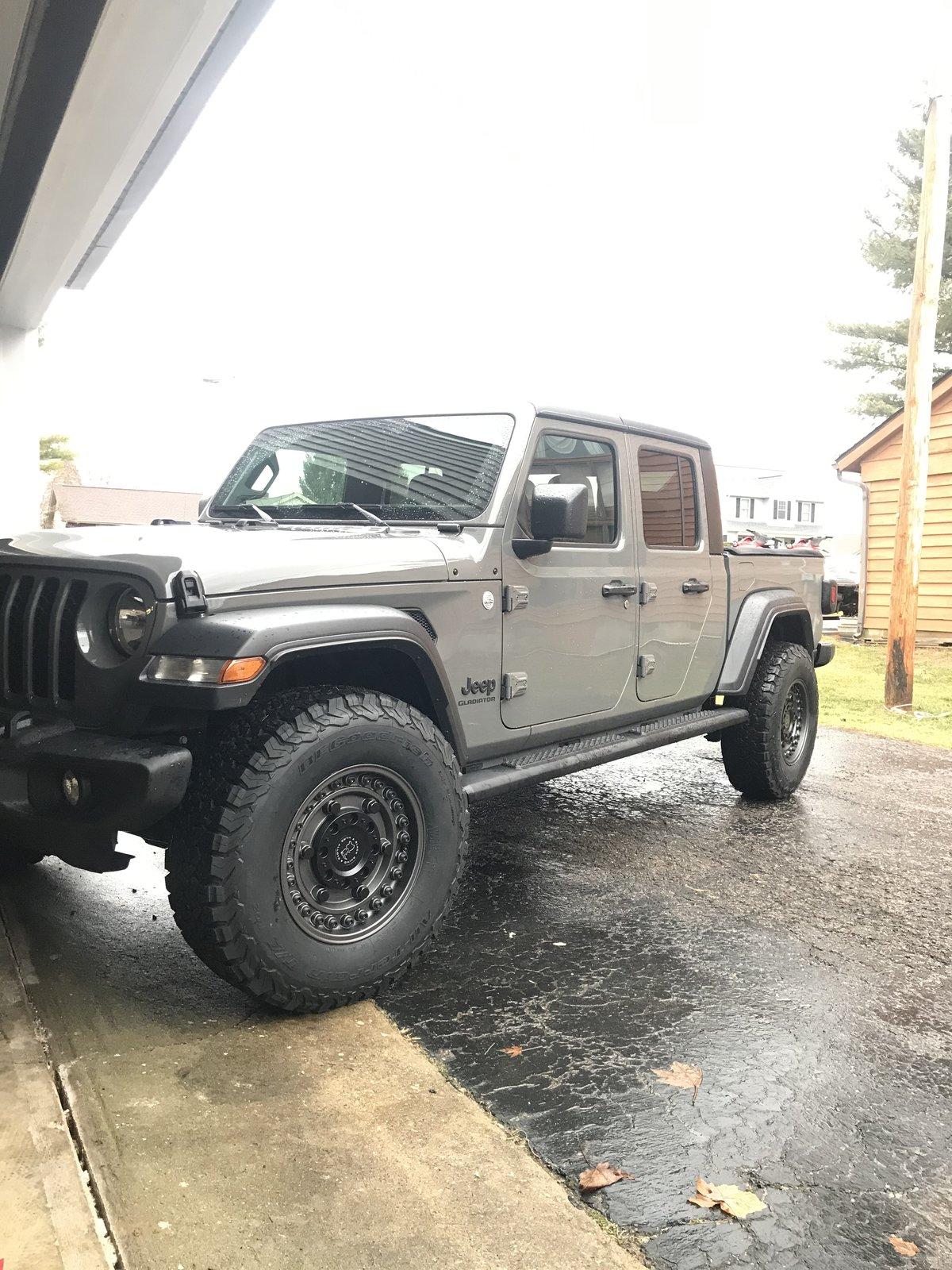

I just put KO2 285/75R17 tires with Black Rhino Armory wheels on my Sport with Max Tow package. The tires measured just over 33.25” when mounted on the JT. No lift or spacers added. I had to take off the part of the front bumper and air dam directly in front of the tires. There was serious rubbing, even before full lock out. Now that those are off there is plenty of clearance for an even larger tire.
The tires stick out about 1.5” from the fenders. I picked these tires bc I was hoping for a narrower look, compared to my JK that had 35s on it. I can’t tell much difference looking at these.
I haven’t noticed any real change in handling or acceleration with the larger tires. My JK had a 4” lift and was noticeably different than stock and not enjoyable to drive on long trips. Overall I am really happy with this set up. The dash is showing I am down about 1mpg on average(15.7) But the larger tires could be misleading the actual mpg and speed.

Any lift at all in the pictures?
