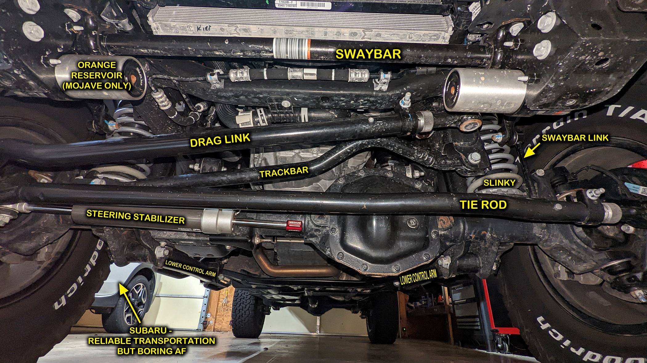

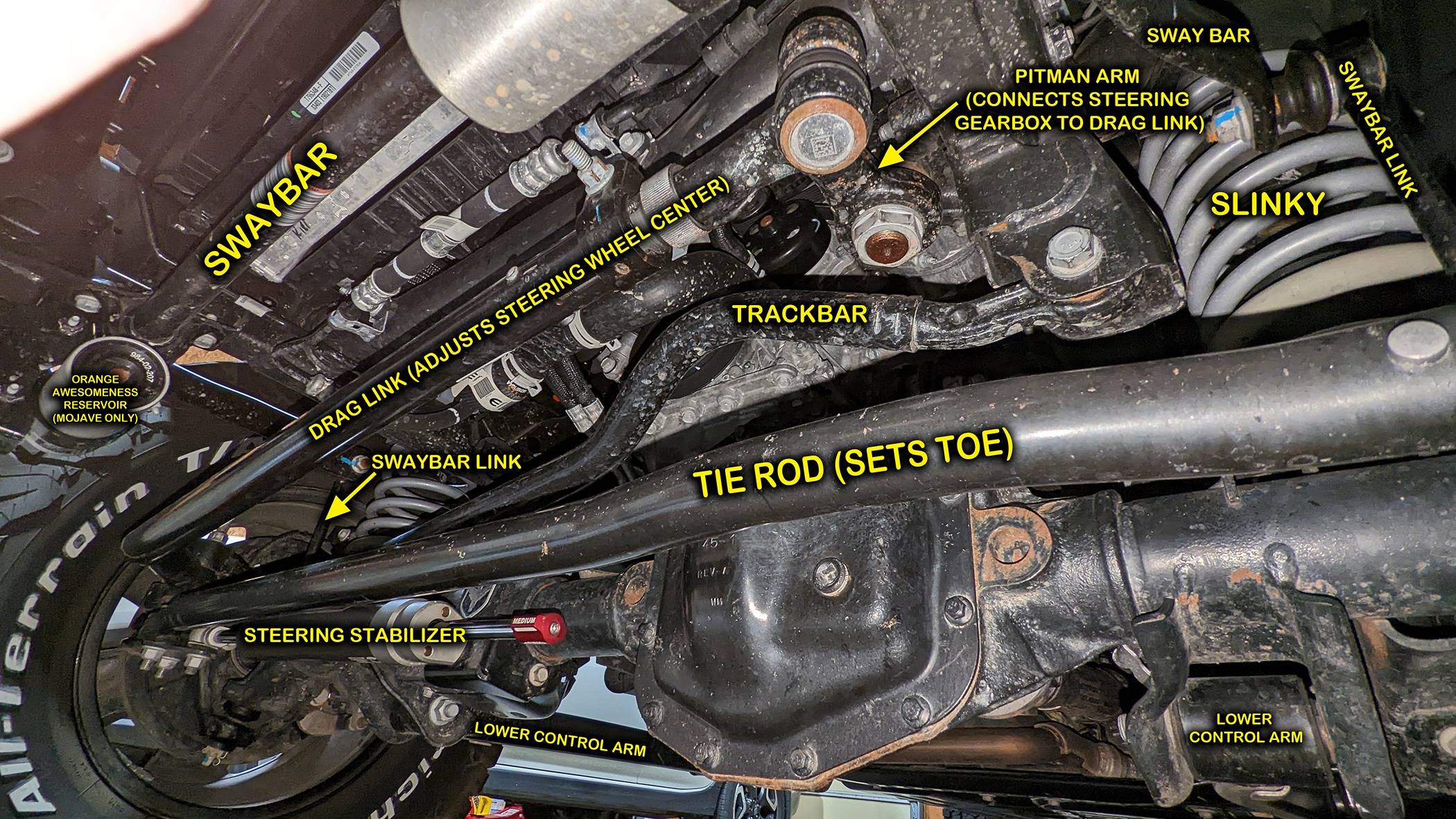

Especially after you upgrade with lift and tires, do these:
âś… Check all components for proper torque
âś… Adjust the steering gearbox pre-load IF the steering wheel moves more that a clock position right of left before it alters your path
âś… Upgrade the steering stabilizer to Fox or Falcon adjustable
âś… Install Metalcloak Sector Shaft Brace
âś… Install Mopar longer control arms or geometry correction brackets to improve positive caster
âś… Learn how to do your own alignments (easy on a Jeep)
âś… Forget you ever heard "It's a Jeep thing", because it doesn't have to be

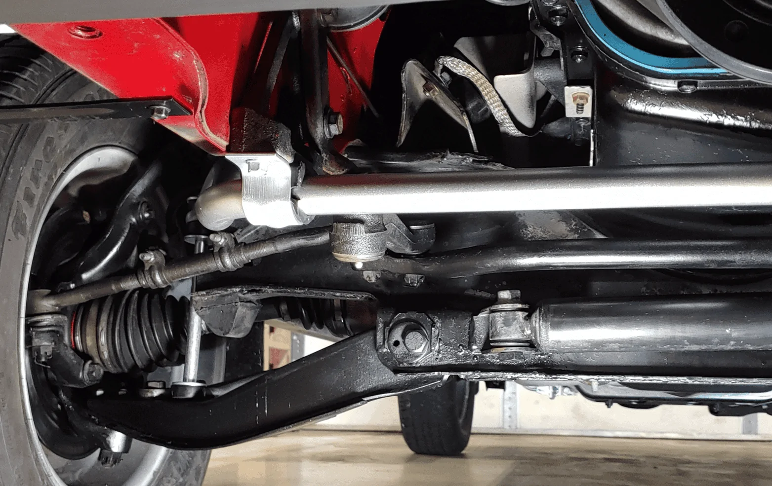

If you take the steering of a JT and the steering of a car with IFS, if all else was equal, there's no reason for any difference in the "play" or "delay" in steering. The steering works the same, there are the same angles working for and against directional changes.
Remember my quest to outrun the storm here a while back, in and out of traffic, getting around anything I could, dodging road debris. There was no problem with steering performance. And there should not be. If anything, there may be more slop in a traditional IFS system because of the multitude of joints involved. You have a joint at the pitman end of the drag link over to the right knuckle. That's two, then you have a joint from right end of tie rod at the right knuckle over to the left knuckle, another joint. 4 joints and otherwise rigid links (supposedly.......)
4 joints compared to the IFS with pitman to drag link joint, idler arm will have a joint, then a joint at each end of the left and right tie rods for 4 more joints. Any play in any of those spots means slop.
The steering gear is the same.

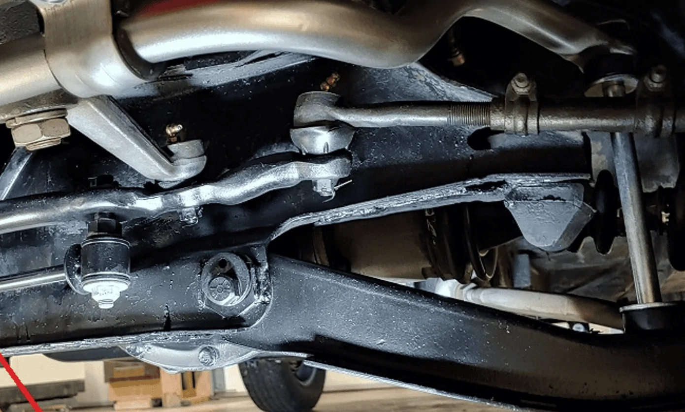

There's 3 joints for each picture (left outer tie rod joint is out of the frame of the picture0
So 6 joints, not to mention the pivot point of the idler arm which is a bushing that can wear and get loose (and often does have some play, even when new)
If the steering is "loose" - don't blame it on the solid axle itself. Think of the fantastic riding and handling WJ (or the fine ZJ which was almost as good)
Both solid axles, neither had any play at all in the steering and response was immediate, swift.
