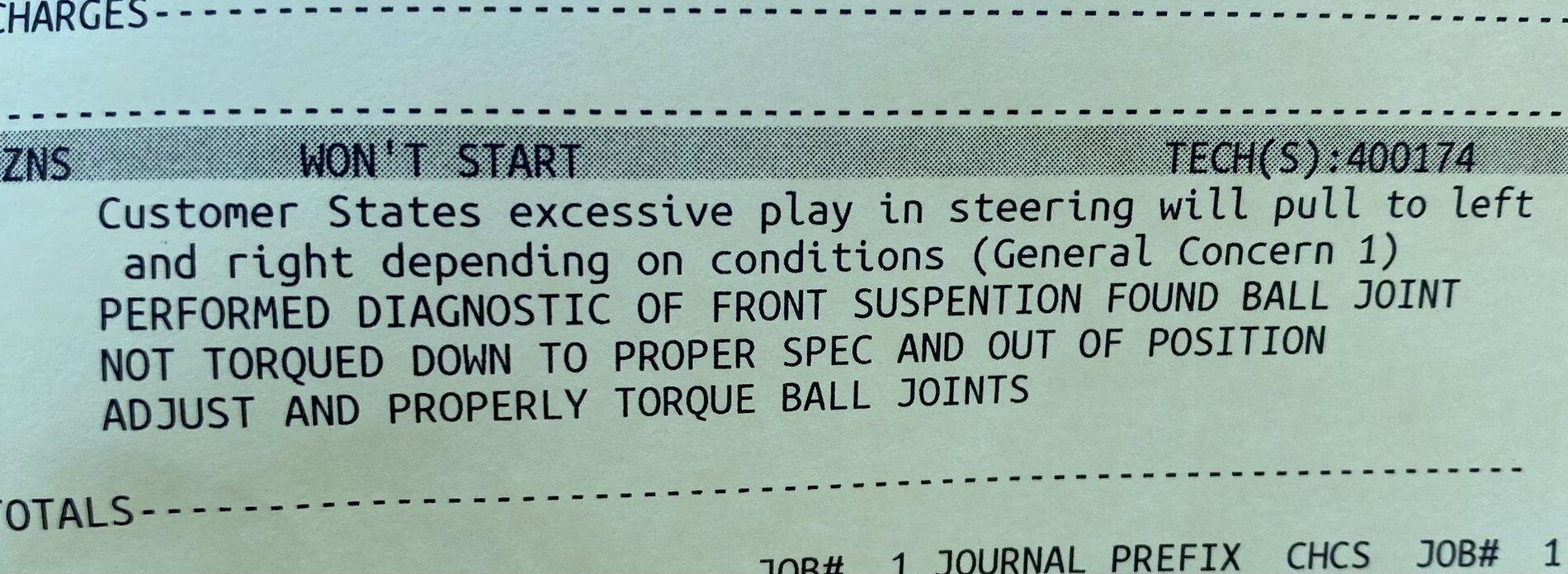

Well here’s the diagnosis. If it’s true, then it’s a little concerning having components not torqued correctly from the factory. But even with that, the problem still exists…..
Jeep Gladiator Play In Steering 0877ECED-2E3A-47D8-AEEC-0944B19BF4FD
Did you ask if the tech road tested before AND after?
Get it on an alignment rack, go from there.
Unfortunately, that has been discovered on quite a few JLs and JTs.

So if something has become "out of position" due to insufficient torque at the factory, then it sounds like its moot for the customer to go over his truck and torque everything to spec since we probably can't measure what might be out of position.
The ball joints aren’t really ā€œpositionedā€, they’re just pressed in there. You can tighten the castle nut, replace the cottter pin, and move on.

Next dealer! Get that rig on a alignment rack and get some data.
Actual numbers vs factory recommended.
It may just need the sector shaft preload screw adjustment. I developed some play in my new steel box, and the adjustment did the trick. Jeep steering boxes have pretty much always been this way to some extent.

Talked to another dealer today. He laughed at the original dealers diagnosis. Said one has nothing to with the other. Getting an appt scheduled. We’ll see how this one goes.
