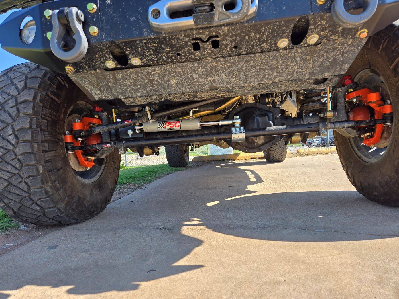

I did the same a while back and couldn't be happier. Even with 38's on beadlocks aired waaaay down, it's still a breeze to steer, even with the front diff locked. I smile, but still cringe as it wasn't a cheap upgrade. I added Reed knuckles and Baller' joints at the same time. My only real regret is not getting the knuckles in black...
looks like mine :) and yup, you're right.. ain't nothing cheap about jeep. Got the Steer Smarts Tie Rod, Drag link and track bar also, just not all installed yet.

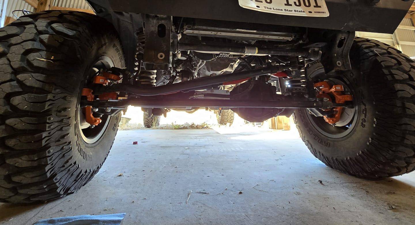

My front end looks very similar, RCVs, Reids, Dynatrac BJs, Rockjock steering, beadlocks and 38s...
Right now I'm running the Apex steering boost kit. It is doing OK, but not really meeting demand on full trail days aired down. Can you link the exact kit you are using from PSC? They have a few options and I want one that gives me the best feel on road as this is still my DD.
I used a RAM and hoses from West Texas Offroad,
https://www.westtexasoffroad.com/product-page/redneck-ram-hydro-assist-kit
Steering gear from PSC
https://www.pscmotorsports.com/all-...2021-jt/xd-power-steering-gearbox/sg691r.html
ram mount kit if using the Stock tie Rod
MB36AK 1 Ea 140.00 Ea 140.00
Mounting Bracket Kit , Jeep JL Tie Rod For Dana 30/44 Axle (Hardware
Included)
MB37AK 1 Ea 185.00 Ea 185.00
Mounting Bracket Kit, Steering Assist Cylinder for 2018 Jeep JL with OE Dana
30/44 (Short)
Since you are using a different tie Rod you will need to fab your own mounts or purchase one like this from Next Venture Motorsports
https://nextventuremotorsports.com/...-steering/products/jl-hydro-assist-axle-mount
A note about the Above Bracket. -- it does not allow the ram to be horizontal with the tie rod, well, it did not on mine anyway. :) There are some youtube videos about modifying the bracket and why the ram needs to be horizontal. Check litebrite videos about 5 or 6 yrs ago from when they had the ram and box done at WTO.
plus the tie rod mount - https://www.northridge4x4.com/part/...lync-ram-assist-tie-rod-clamp-bracket-1-625in
I also added the steersmarts brace for the steering gear.
https://www.northridge4x4.com/part/...-w-frame-side-track-bar-reinforcement-bracket
last but not least is the Steering fluid.
https://www.amazon.com/dp/B0089LTVIY?ref=ppx_yo2ov_dt_b_fed_asin_title&th=1
the install can be done in a day. good to have a helping hand when swapping the steering gear.
hoper this helps :)
