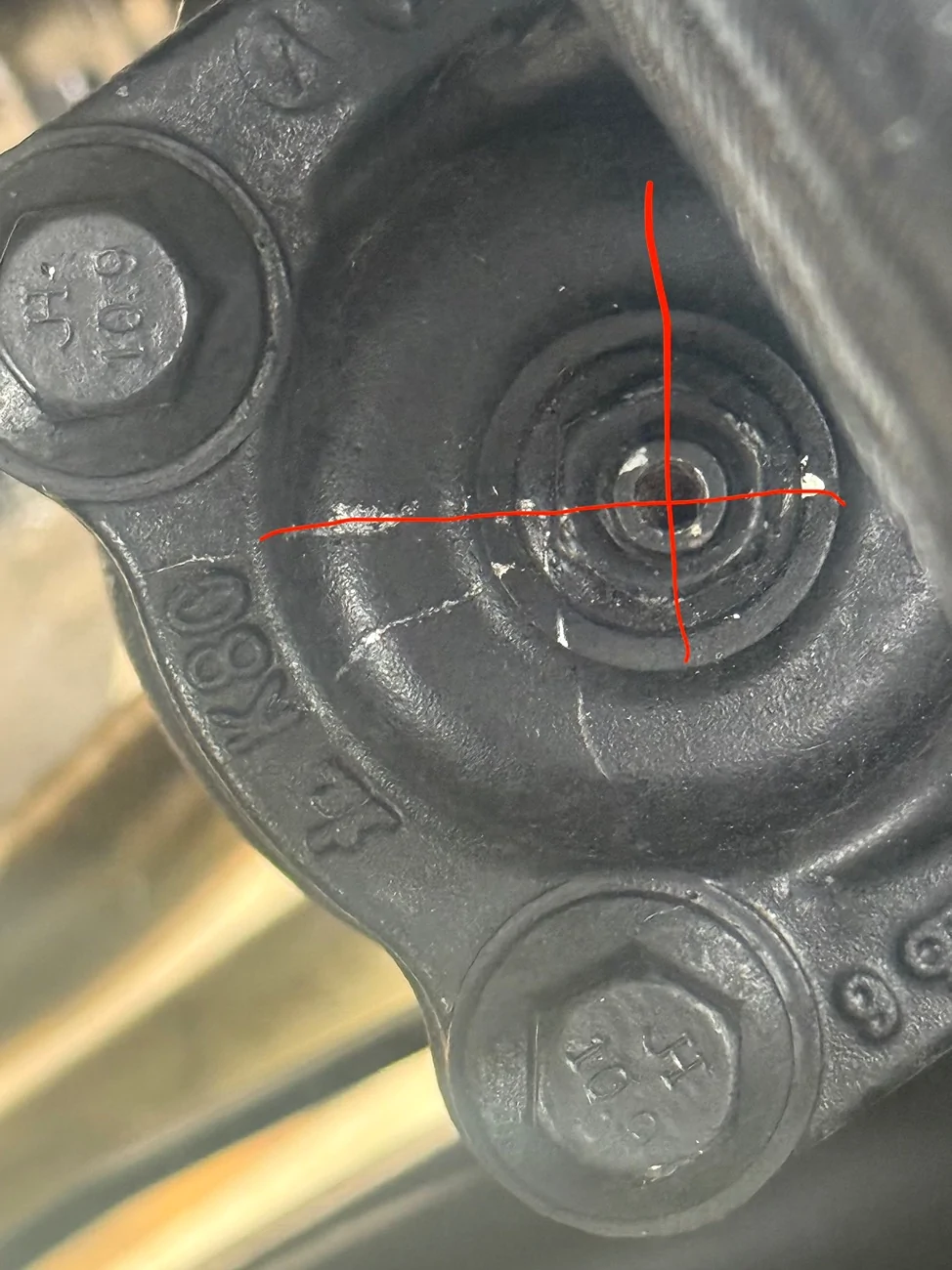

I ended up deciding to try and move mine 1/8 turn. I’m a little worried as I’ve read that the nut is initially hard to break free due to the loctite. Not sure if someone has messed with it before or not. I also didn’t have any paint marks like I had seen in some videos. I put a breaker bar on mine and it really didn’t turn hard. It wasn’t finger tight by any means but wasn’t hard to get off as other have indicated. The horizontal red line is where I started and the vertical is what I estimated to be 1/4 turn. I’d say I’m half way so 1/8. Will report after driving if I notice any issues.

Normal yes, to a degree. Pretty much every vehicle I’ve driven doesn’t have as much movement in the wheel as this gladiator during winds or road crown and I’d say its ever so slightly better than a 2nd gen dodge HD with arguably the worst steering of any vehicle in the last 30 years.
I will add that I did some driving after the adjustment and the play is reduced. While not race car tight, it is better. The hard part is identifying how much play is there and what’s “normal”. what I’ve noticed is you pretty much have to measure it with the vehicle off and rotate the wheel until you feel a slight stiffness indicating that you’re low engaging the linkage as a whole. With the vehicle running it softens the steering quite a bit and you can easily turn the Steering wheel into territory where the wheels are actually turning a slight amount which is no longer free play and just the “mush” of this vehicles solid axle steering. Solid axle vehicles will always have a mushy/soft feel that requires more input than traditional rack and pinion setups. I like to think of it as rack and pinion is like .75:1 and solid axle is like .2-.25:1. It just requires more steering wheel movement to achieve the same tire movement.
But that’s different than dead space or free play where nothing is actually happening.

The slow steering response is also due to big tires. Glad the box adjustment helped. It makes a huge different on mine.
The problem is there dead space in the steering. You move the steering wheel and the pitman arm is not moving. Indicating there is slop in the box. Tightening the nut seemed to help some. Not perfect, but I doubt it ever could be
