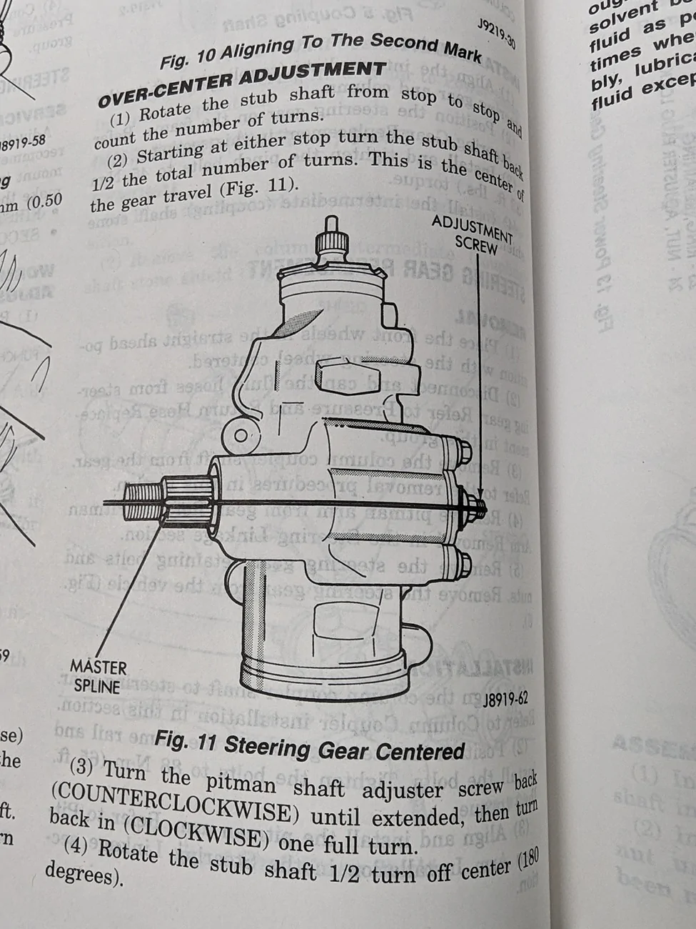

The adjustment people keep talking about - you are turning a wedge that pushes the sector gear against the rack, or let's it move away from the rack. In other words, you are tipping the sector shaft top toward the rack, giving it more pressure or less pressure. I suspect what people are really feeling isn't play that's removed, it's more akin to a heavy steering dampener - it prevents the steering wheel from moving so easily due to the pressure on the gears, so it FEELS LIKE the steering is more solid.
Too much and you wear out the worm, balls, rack and sector - and can cause it to not want to return to center as easily (so people may then up the caster to compensate or force it)
Too little and yes, you can introduce play, but it's so small, the amount so little.

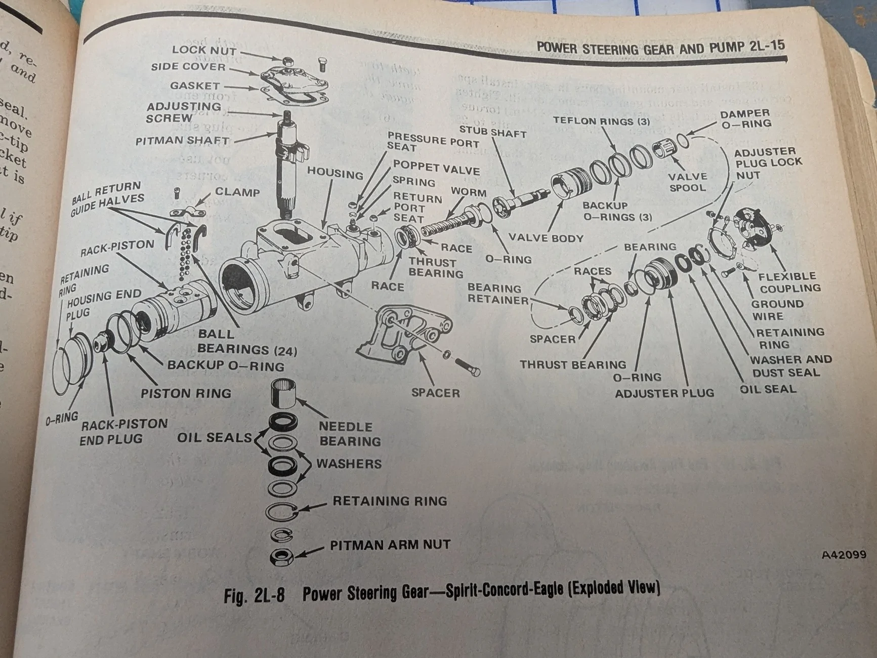

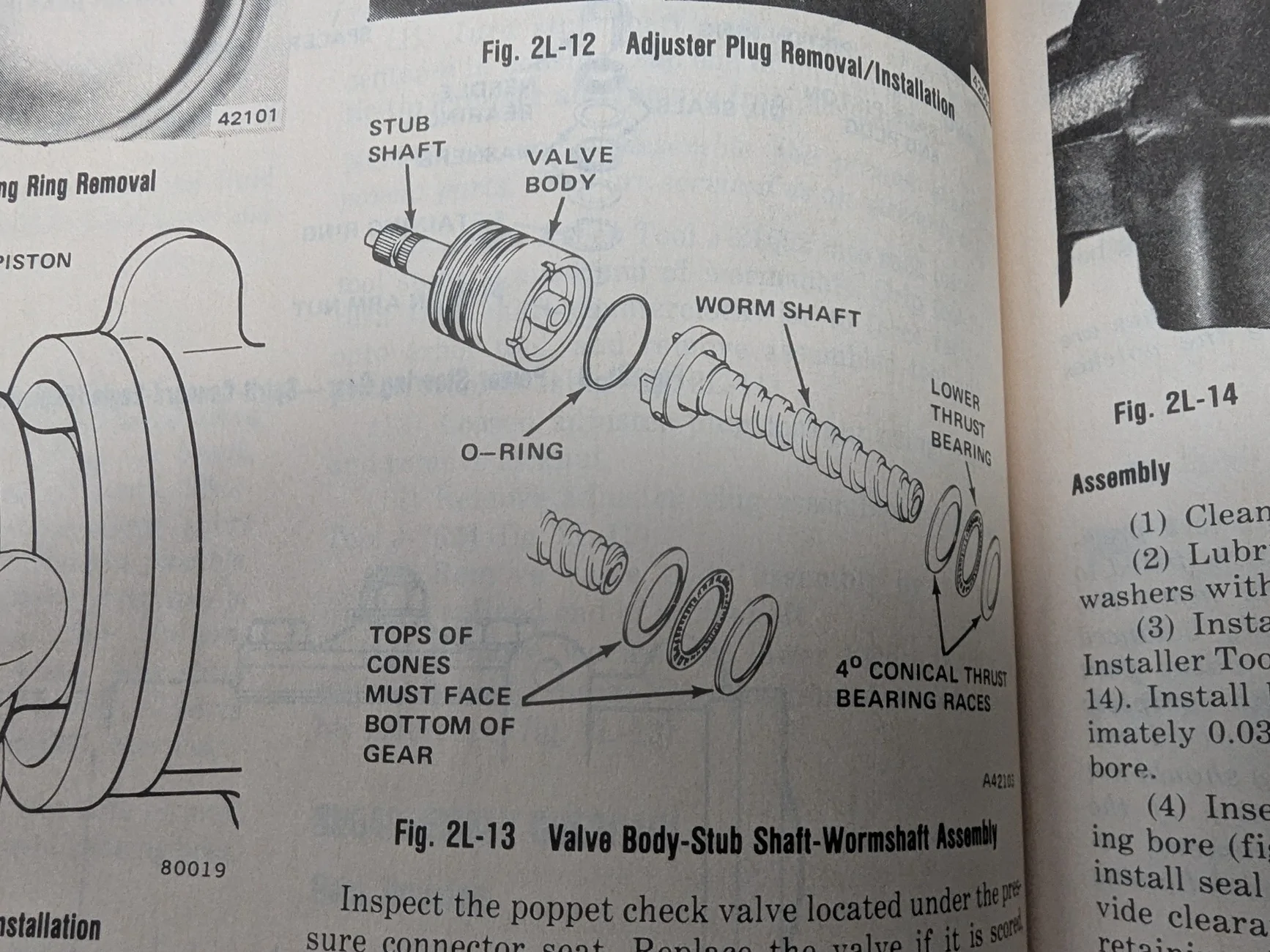

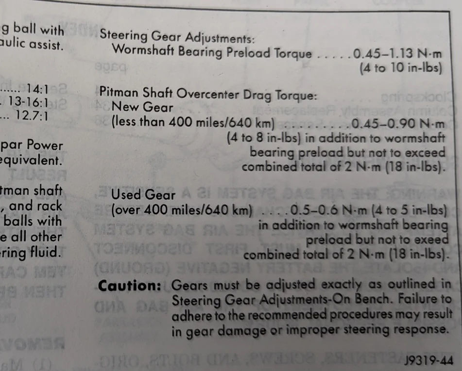

This shows the worm shaft - no gear touches that, a series of balls run in that worm/track ->
Jeep Gladiator Can steering wheel play be reduced/eliminated? PXL_20251125_190841148

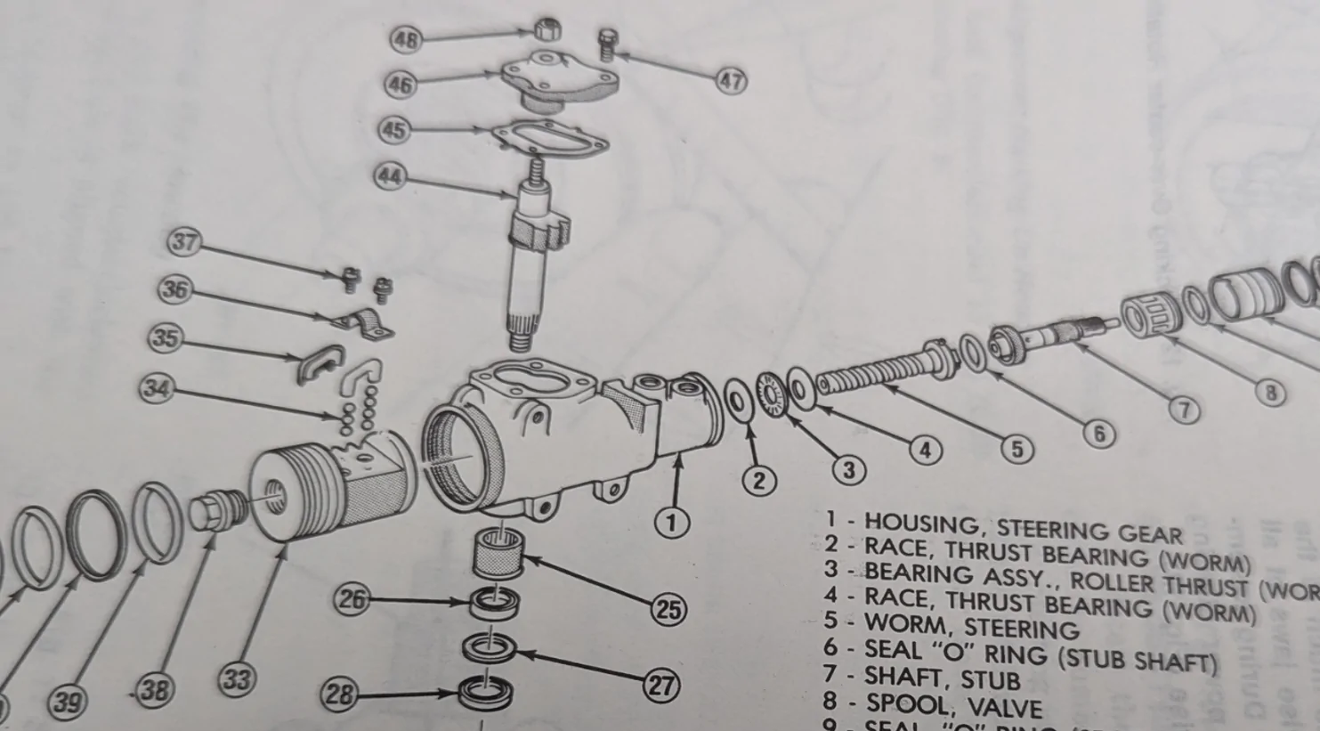

Here, number 33 is the rack that runs on the balls that run in the worm shaft-
44 is the pitman shaft with the sector gear that runs in the rack that runs on the balls that runs on the worm................the adjustment moves the rack closer to the rack for a bit of preload.
Jeep Gladiator Can steering wheel play be reduced/eliminated? 1764098466388-xt
What's really interesting is that the images reflect the current steering gear, meaning nothing has changed for decades. MOPAR continued to use the same text and images that AMC used in their TSMs for their own TSM
Jeep Gladiator Can steering wheel play be reduced/eliminated? PXL_20251125_190825011
And yes - this was part of my college and training, so yes, I've had them apart, rebuilt them and so on. It's not a lot of fun.
