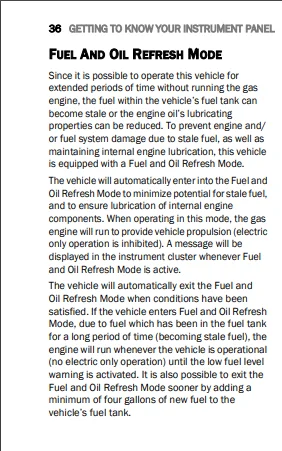

Does yours state fuel and oil refresh mode? Here is the post by jeep cares on the 4xe forum.

Here is a link to one (of many) posts on the subject and they all are the same basically. If you are getting fuel and oil refresh mode then you need to get the oil to 210 for 20 continuous minutes or it won't clear. Mopar makes a winter front for the 4xe to help with this but if you are getting FORM its working as designed sadly.

Jeep cares grabbed it from somewhere, I don't know where but it seems to be documented. The picture I posted is straight from jeep cares and they had other notes explaining that short trips in the cold trigger it more and that you may need to get the engine to operating temperature for at least 20 minutes
