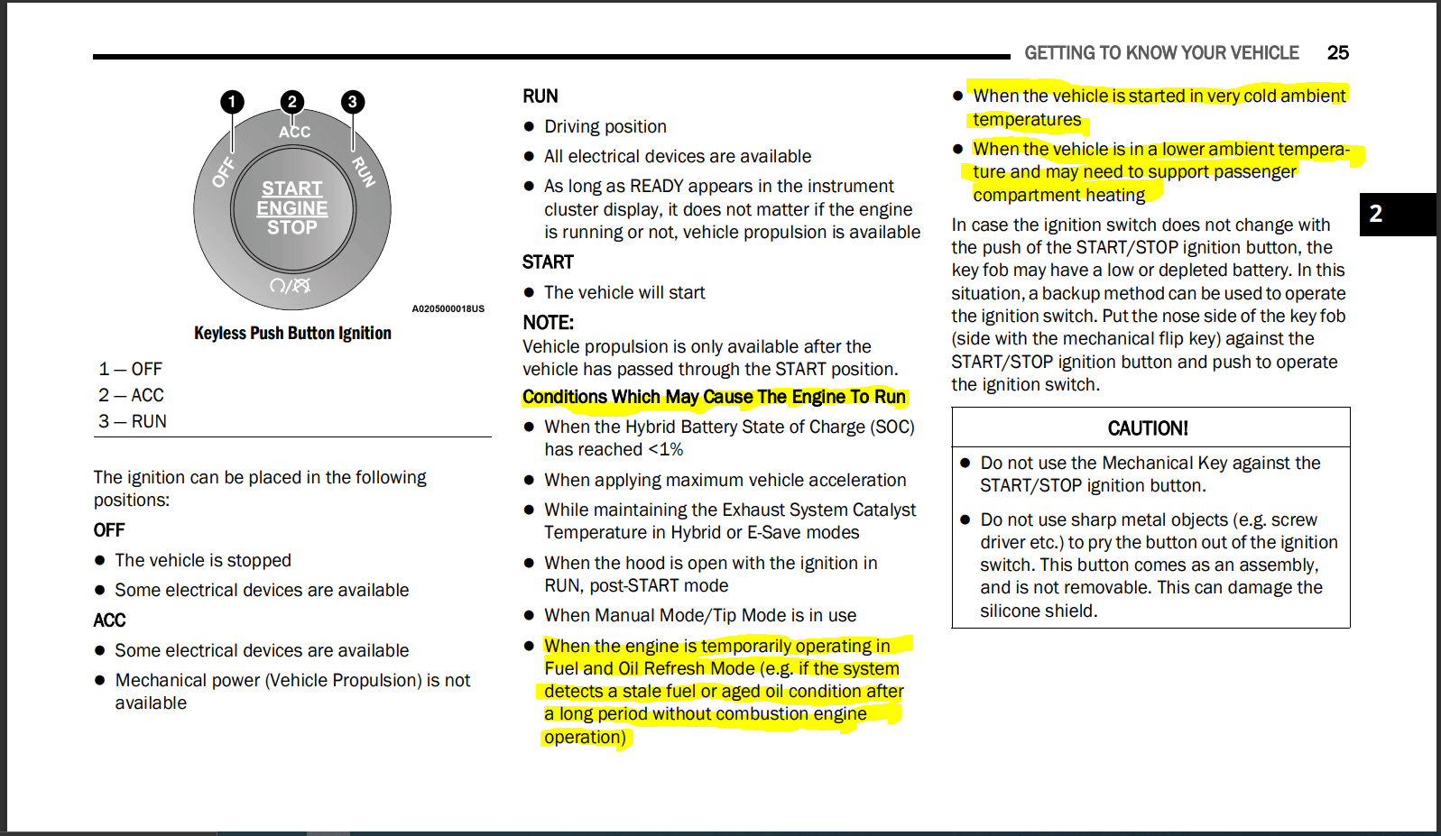

It doesn’t use electric at all. Meaning gas only. Fully charged, 15-25 miles per day of driving, and it comes home with a full charge. In hybrid mode, which is the only option as electric is unavailable, you can watch the power draw. It uses all power from ICE, and almost none to absolutely none from the batteries.

Dude. Please read the entire thread. We pre start it plugged in, so the cabin is 70+ degrees before we unplug and drive away. Fuel and gas refresh is 100% of the time, even after 80 miles of driving with ICE at 75mph. You’ll also notice earlier in the thread that I’ve read the manual cover to cover, and your highlights aren’t applicable.
Thats 3 reasons why it would run the engine. Did you ask the dealer to change the oil? sounds like a sensor could be bad. Just trying to help figure out a 4xE issue on a Gladiator forum so calm down. You posted on a public site if you don't want help then you should have direct message jeep cares instead.
I was pretty clear that I’m all ears if someone has a suggestion that hasn’t been addressed. The three reasons in the manual are not what’s happening to our vehicle. I was clear on the conditions in the thread. Thanks.

Have you run the gas tank to nearly empty? None of the previous "conditions" you've mentioned your Jeep was in would have cleared this case.
From page 37 of the 4xe Supplement:
If the vehicle enters Fuel and Oil Refresh Mode, due to fuel which has been in the fuel tank for a long period of time (becoming stale fuel), the engine will run whenever the vehicle is operational (no electric only operation) until the low fuel level warning is activated. It is also possible to exit the Fuel and Oil Refresh Mode sooner by adding a minimum of four gallons of new fuel to the vehicle’s fuel tank.

Yes and yes. Tried letting it get low, then topped it off with far more than 4 gallons, as it takes 17.5. and was down to a 1/4.
