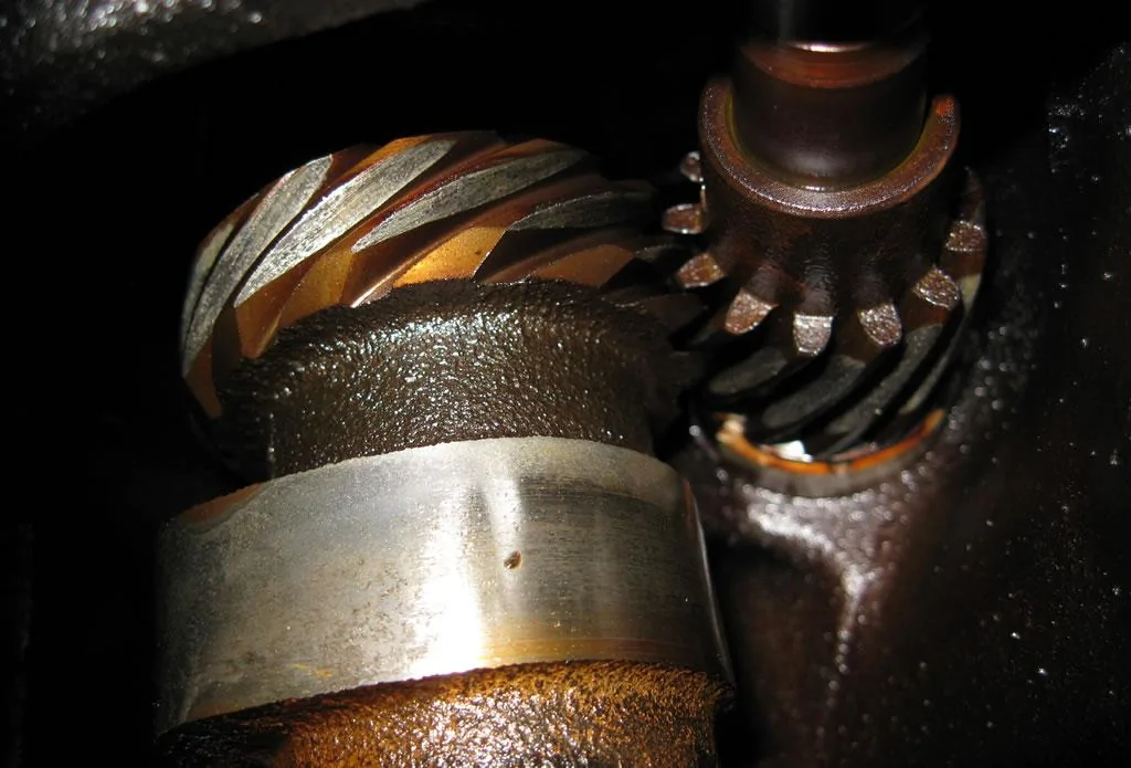

So this whole warming the internal combustion engine thing, does not make since to me, and wveryone talking about heating and cooling needing the ice are just incorrect. One of the big technology pieces of the 4xe is the electric heating and cooling module under the passenger side floorboard, which has and engine oil coolant circuit as well as one for the cabin. It warms the jeep faster than the ICE can. Neat little unit.
How do they account for the engine never warming up and being like any engine that's only ever started and run for short periods of time but never warmed enough to heat the oil and remove contamination? Engines that never reach operating temperatures for 15-20 minutes die early deaths. I've proof in my garage and have seen instances of vehicles driven for only 15 minutes and then shut down, week after week.
It monitors fuel and oil, and has a runtime routine to ensure both are circulated a minimum amount of time per runtime. It will indicate on the dash while in this mode. Forget what it says exactly as I don't see it much cause I like the power from using the full drive system. ICE and electric together. Here is a picture of the heating cooling unit I was talking about. They have thought about the cold oil start and have addressed it .

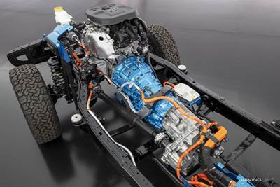

Jeep Gladiator Please Respond @jeepcares - Major Issue w/ 4xE Brand New jp021_344wrekb0vavpbb58dp3ltc9jof5bfh1

Your proof is AMC oil pans from the 70’s and 80’s. Things have changed a bit. I too had a CJ7 with an original AMC 304. I’d never expect it to do what modern engines can. Sounded amazing though.
That hasn't changed. You don't warm the oil to boil out the contamination, you ruin parts. There's pictures out there on the web of etched bearings from the acids that form. That hasn't changed much over the years.
Oil is better, filters are better, but contamination and moisture are still a problem.
I still rebuild and restore cars and rebuild engines and see what happens.
This should never happen->
Jeep Gladiator Please Respond @jeepcares - Major Issue w/ 4xE Brand New cam-dist-gear-0055
