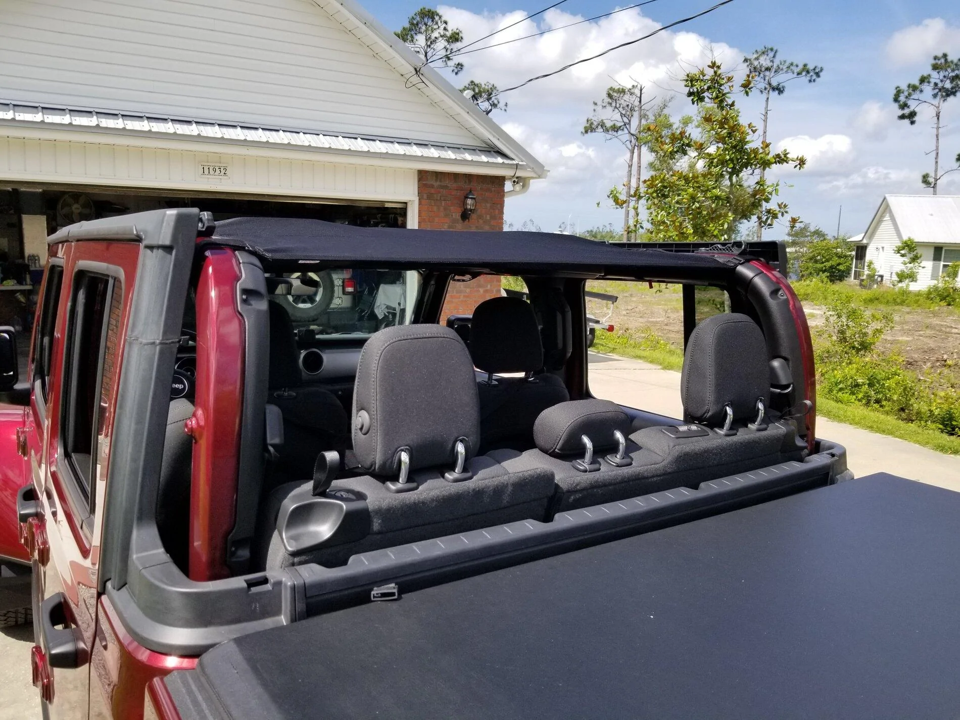

I'll be honest, I don't see why they couldn't have made it like the Wrangler 2 door top.
"Sunrider" position like it currently is that works when you have anything in the bed AND the slider that brings it down onto the bed rails.
I assume they would have to tweak the design a bit to clear the rear doors (perhaps more an issue than I give credit for) and maybe have it set a little further back, but it sure seems like the basic design would work.
this only doable because it doesn’t have back doors. The back soft window is removed easily… back doors not so much. That grey bar wouldn’t work with the JT and door. Plus it would be blocking the back window, which would likely need to be removed. I honestly think picture#2 looks about the same as #1.
You likely have to make the "slider" bars longer to clear the rear doors and their surrounds.
I still think it is possible, but it would also mean that the roof will sit even further into the bed area.
This might be the real reason they are not doing it.
Not sure what you mean by "blocking the back window, which would likely need to be removed".
Assuming you are talking about the rear corners & soft rear window, those absolutely would have to be removed.
Just like how the side windows and rear window is removed on a Wrangler to drop the top all the way back.
Yes, this is EXACTLY what I want. As someone said, the rear doors become an issue, but I think moving the pivot back a little further is doable.
People keep saying have the top drop into the bed. No, just have it flop on the bed rails like it does on wranglers. It wouldn't compromise the bed at all unless your load is higher then the rails. And if you need the bed rail height exceeded, leave it up in sunrider position. It's very doable.

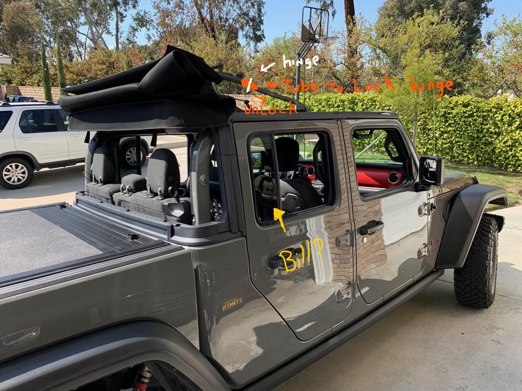

Instead of moving the pivot back more, Allow the last bar to slide back about one foot farther then take that long last bar that the top is connected to and make it two bars with a hinge in the middle. when droping the top you would slide a locking tube from over the hinge to let it fold down, then to put the top up just straighten the bar and slide the tube back into a locking position.
Jeep Gladiator Please tell me there's other soft top options Inked ST open_LI
Once the whole top and bar slides back about one more foot that hinge would be just about over the back of the roll bar and allow the top to tuck in just behind the existing top but still up out of the view of the rear view mirror. It would bring the top out of the rough air and drop it behind itself quieting up the ride as well.
