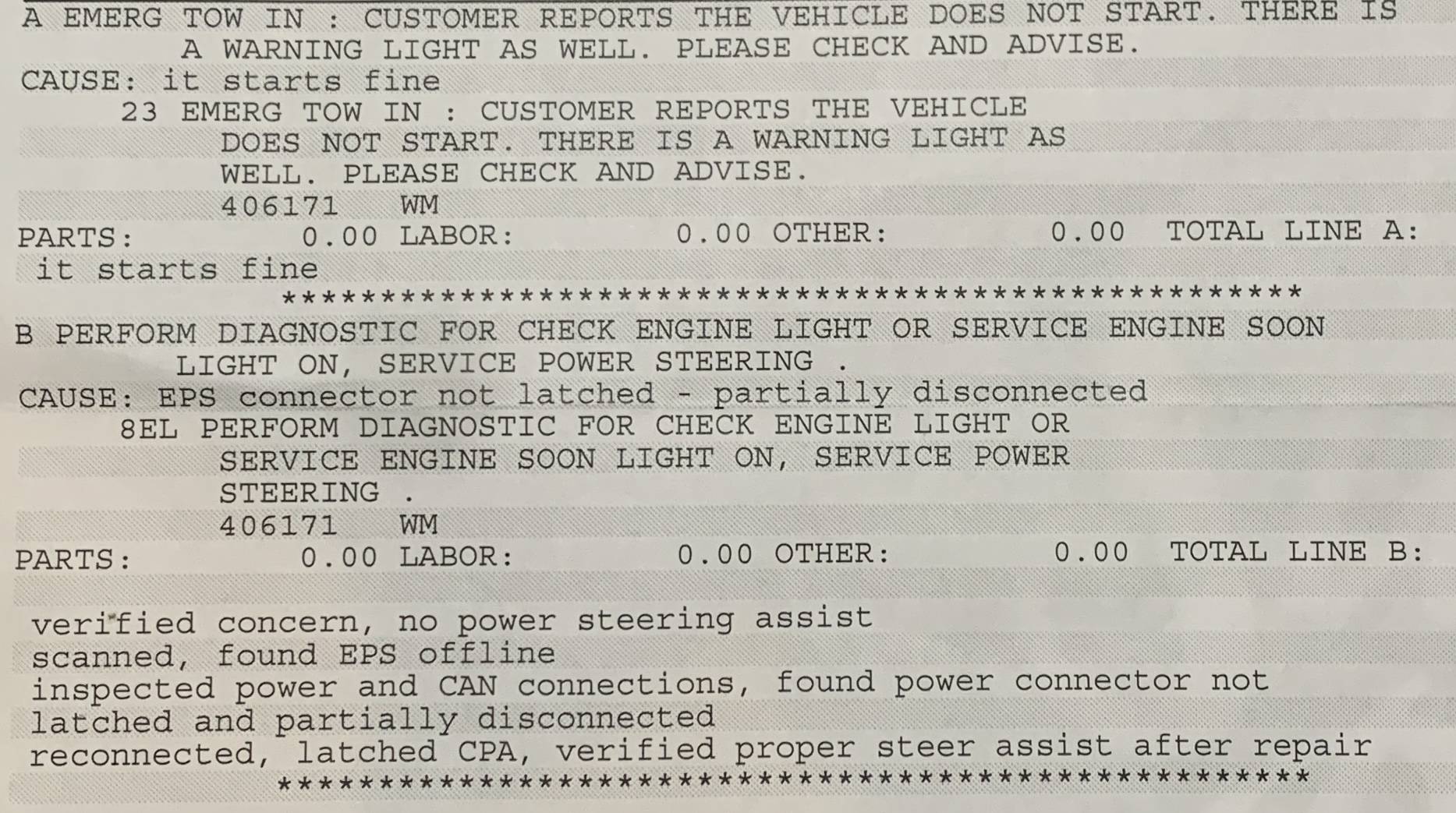

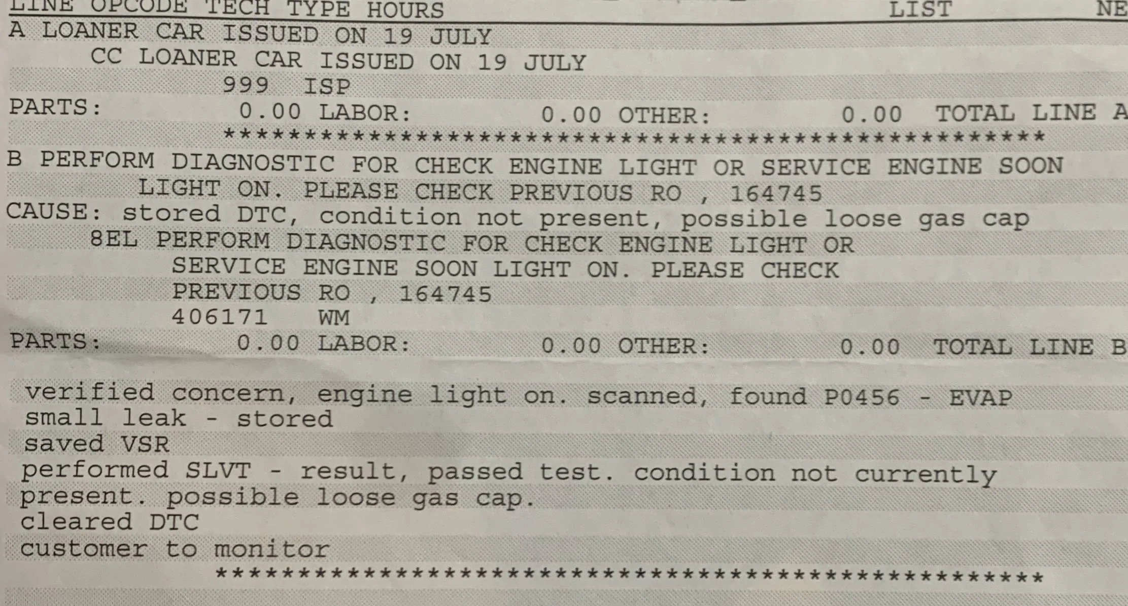

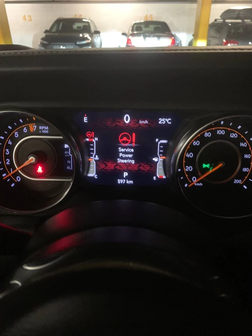

I purchased a 2023 Gladiator on June 26th, and after driving it for 5 days, the steering wheel alarm and powertrain alarm came on simultaneously on the highway. The steering wheel locked, and I had to park on the side of the road. The vehicle was towed to the dealer for repairs, but I was unable to drive for four days. After getting the vehicle back and driving it home, the powertrain alarm went off again the next day. This left me unable to drive for another three days. I asked the dealership representative to refund or exchange the vehicle, but they refused, saying it was a minor problem. Now, all alarms have disappeared, but when reversing, the camera screen shakes a lot, and sometimes the guide lines disappear. They say this is also a natural phenomenon. What actions should I take? I live in Canada, and this is my first car. I can't drive long distances because I'm anxious.

When you mention the second time the "Powertrain Alarm" was the vehicle actually un-drivable or were you just to nervous to drive it? EVAP small leak codes usually do not make a vehicle un-drivable.

When the steering wheel service alarm came on, the wheel locked, and I couldn't drive the vehicle. After the first repairs for the steering wheel alarm and powertrain alarm were completed, the second powertrain alarm came on. Although the vehicle was drivable, the dealership mechanic advised that there could be significant issues with the powertrain alarm and recommended towing the vehicle after stopping.

Invest in a cheap OBDII scanner/reader to keep in the truck. Can pick one up for like $20 or so on Amazon. Not every code thrown and CEL is one that has you in dire straights .

I have never tried to lock the string wheel .The service string wheel alarm came on 5 days after purchase

Power steering issue...........hmmmm.....smells like bad ground......judging with the other issues......just a thought.
