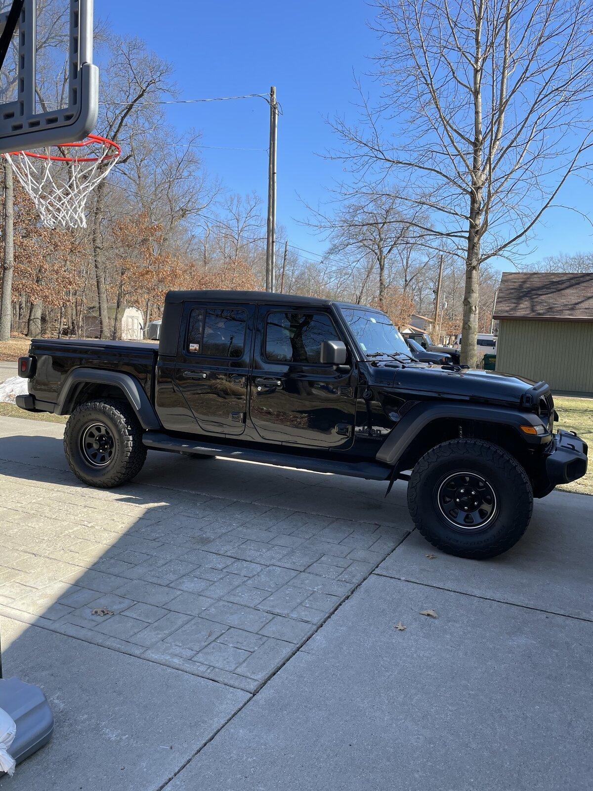

Thanks for the input guys i ended up finding that most people ended up adding or wanting the additional 3/4” in the rear so just went ahead with the 1” to give me a little bit of wiggle room(exactly 1/2” lower in front) when carrying/towing heavy loads. Came out awesome!

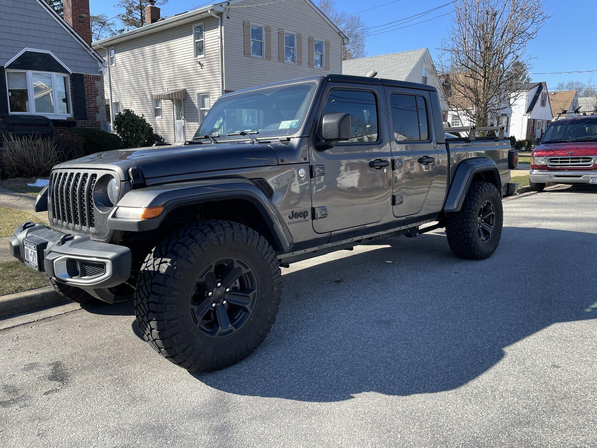

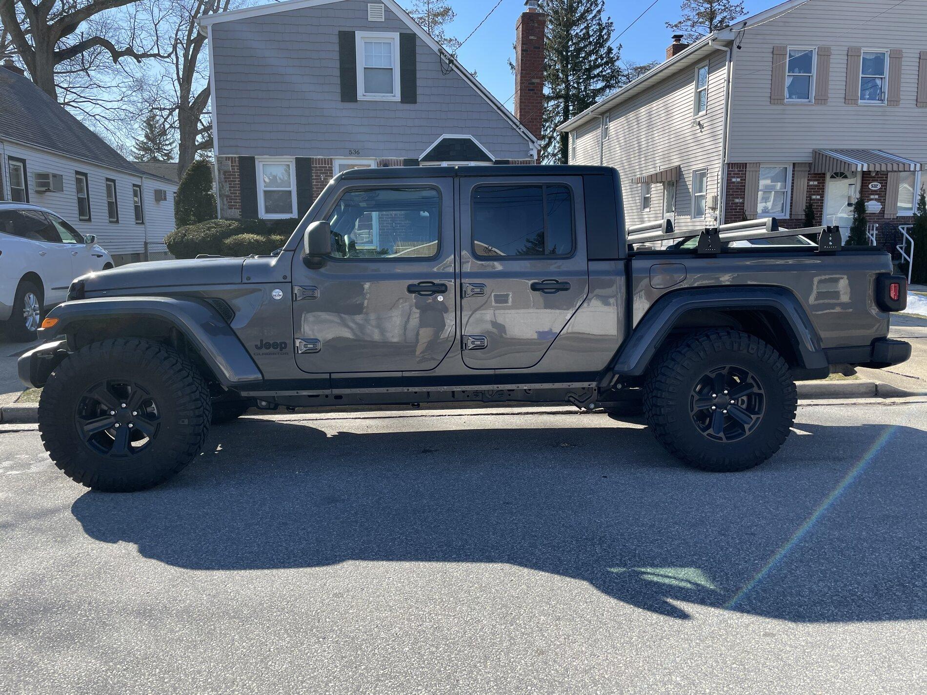

I went with the 1-1/2" Teraflex and i still have just a slight rake, not much but i think it worked out perfect IMO!
