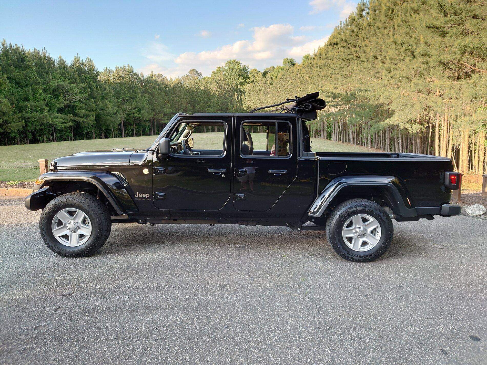

Max tow with LE front springs, 340 and 343, Rubicon shocks, Daystar 1.5” front and .75 rear spacers, Mopar LCAs from the 2” lift kit. 34” Toyo tires.
That looks good and is just about exactly what I'm thinking for my Max Tow.
LE springs?
How much actual lift did you see?
Thanks!

likely referring to the launch edition which would just be standard rubicon springs.

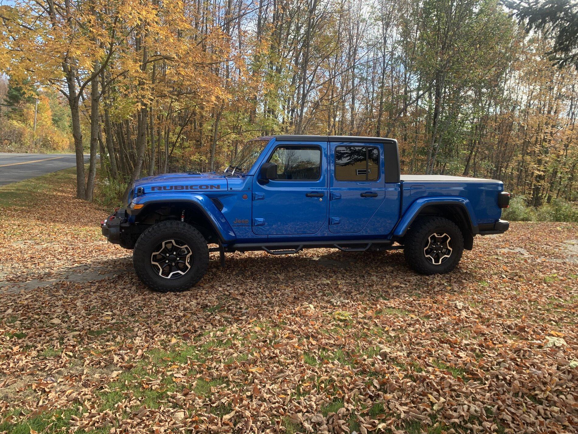

Springs were from a launch edition, the numbers are pretty high, 340 and 343, gained 1" over the sport springs. I have since also added Daystar correction spacers, Rubicon Express 2" front shock extensions and a Fox TS steering stabilizer.

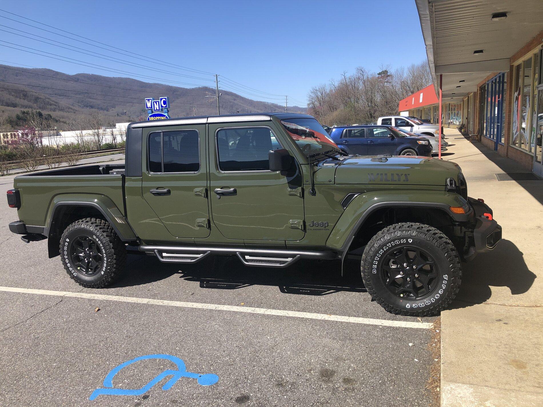

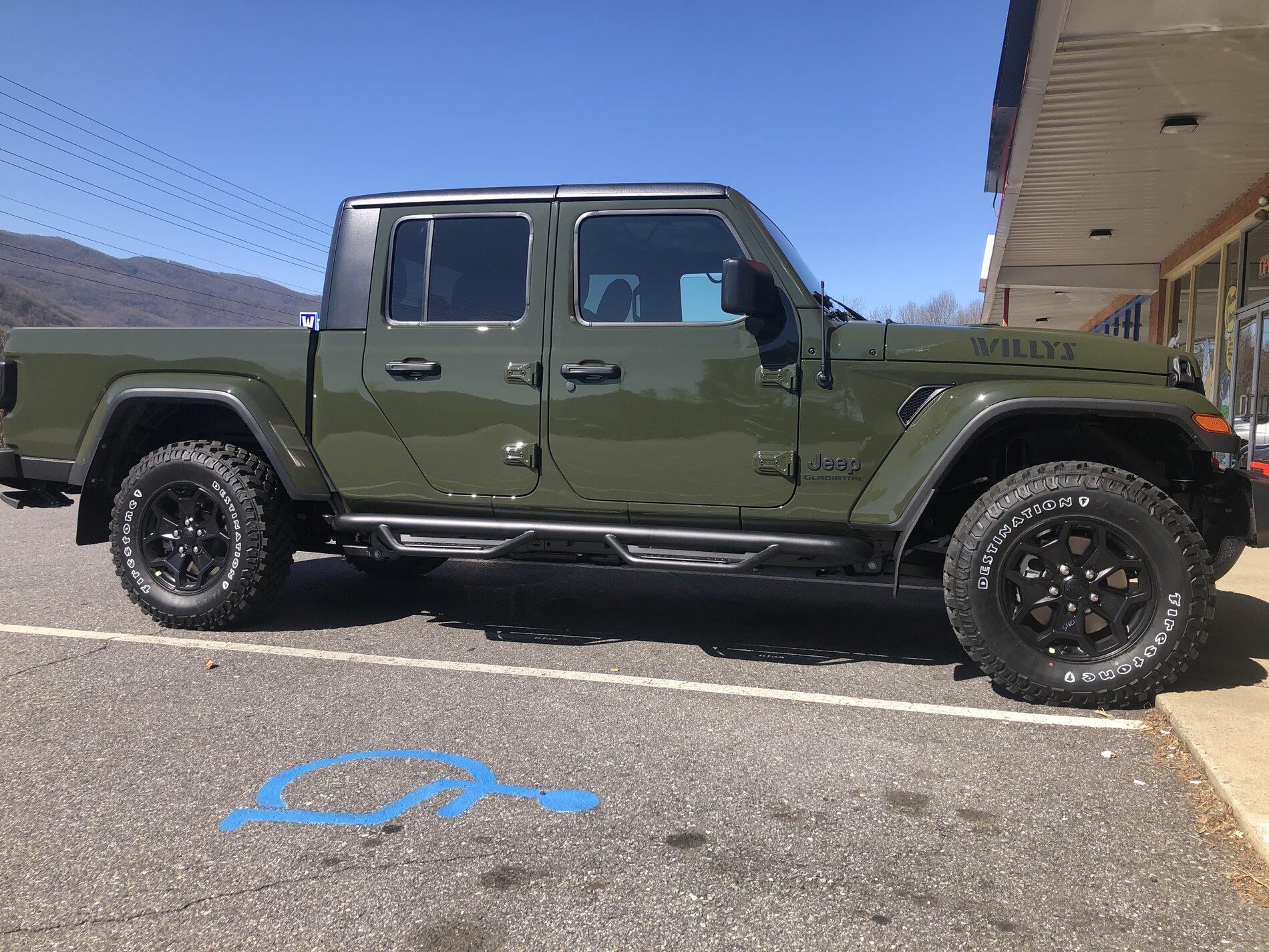

I went 1” check out the pics sits perfect...exactly 1/2” higher in the rear. I would say do the full 1-1/2” if planning for steel bumper/winch.
With my Sport S Max Tow, with the 1.5" installed my rear is still .5" higher with a full fuel tank.
I ordered the Mopar LCAs just to be on the safe side. I also ordered Bilstein 5100 shocks and steering damper for 0-2" of lift.
My goal was to simply fit 33s at full articulation and to get rid of the rake look.i have wheels and 33s in the mail.
It's crazy how many different options of factory springs there are.
