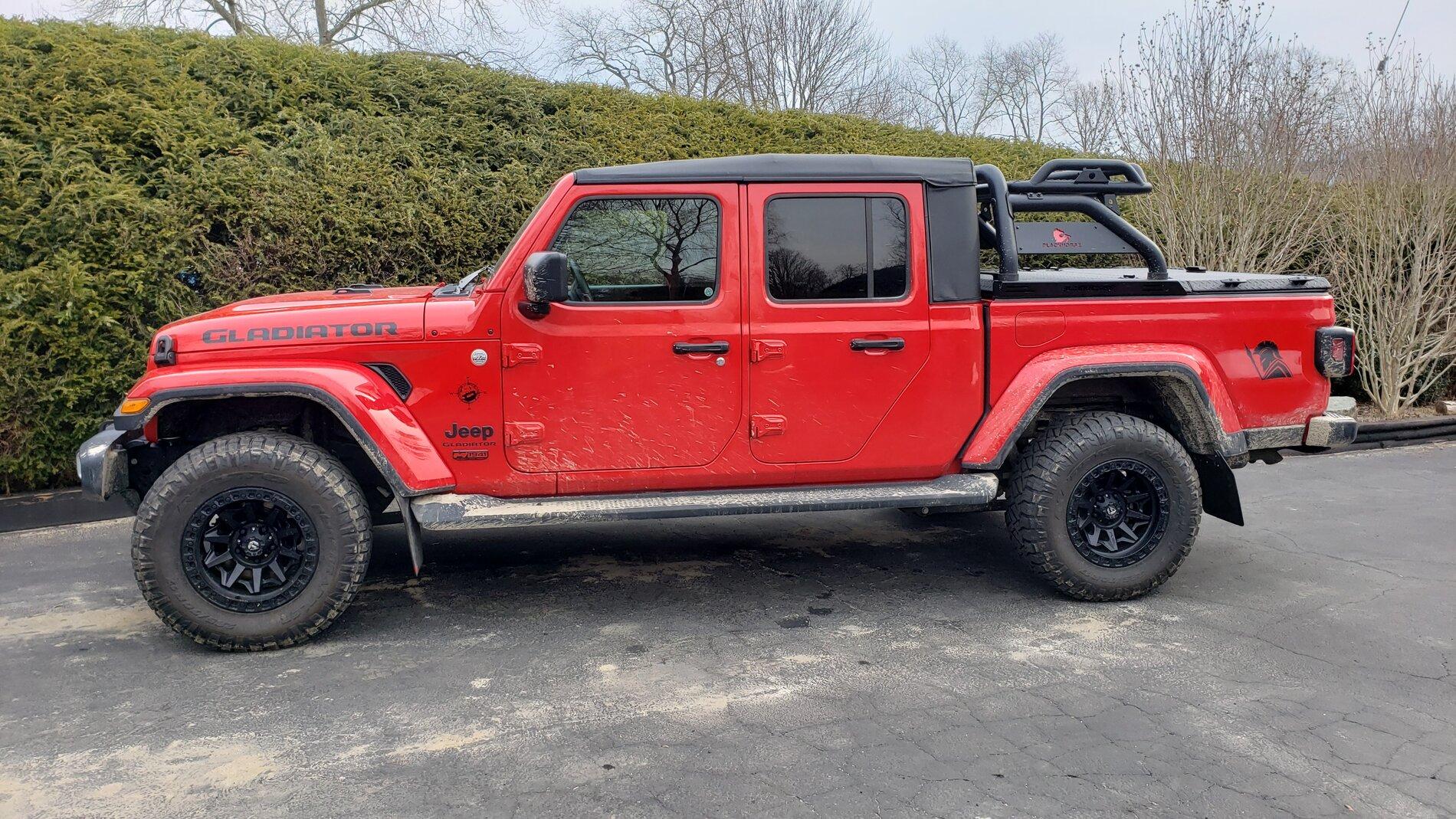

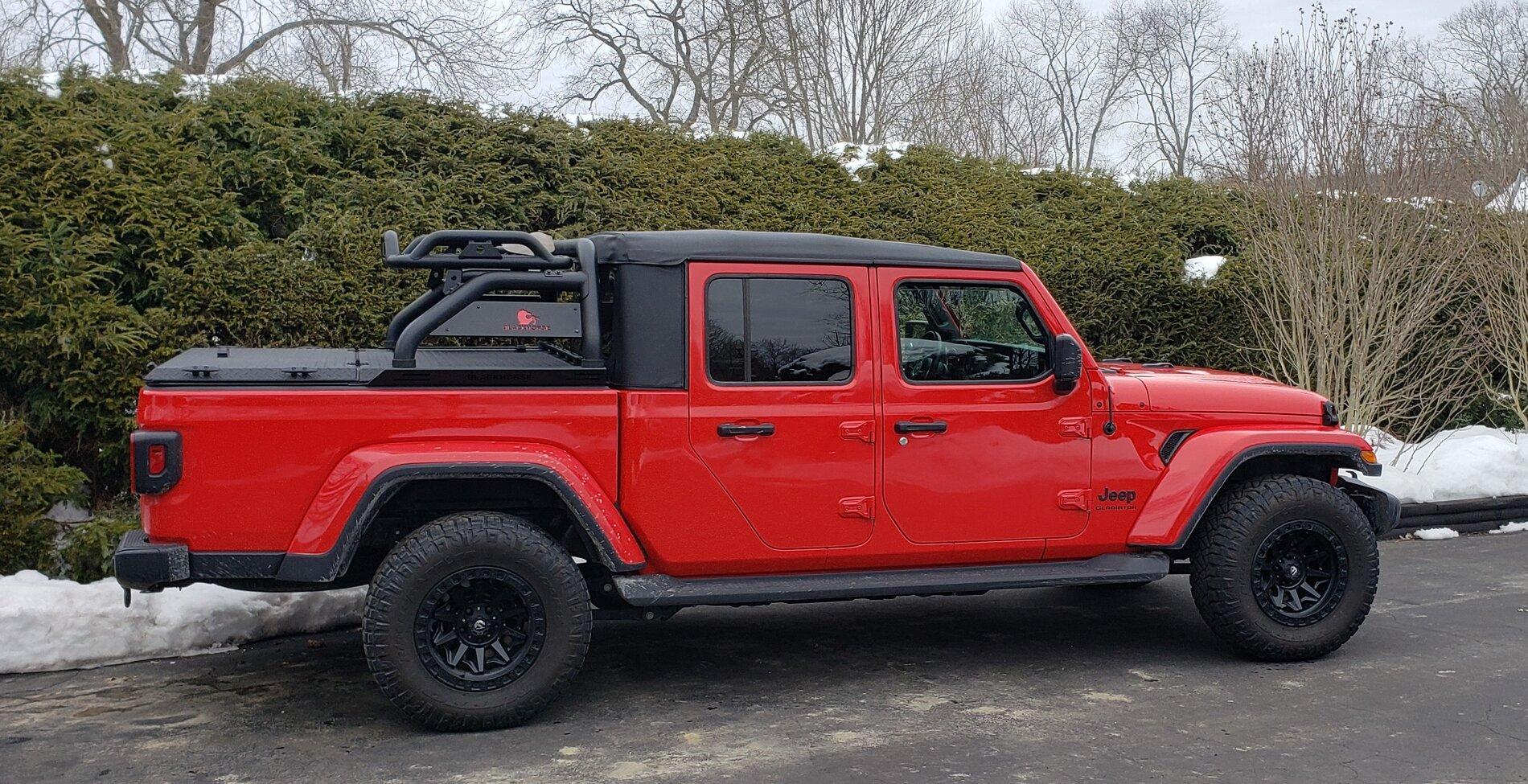

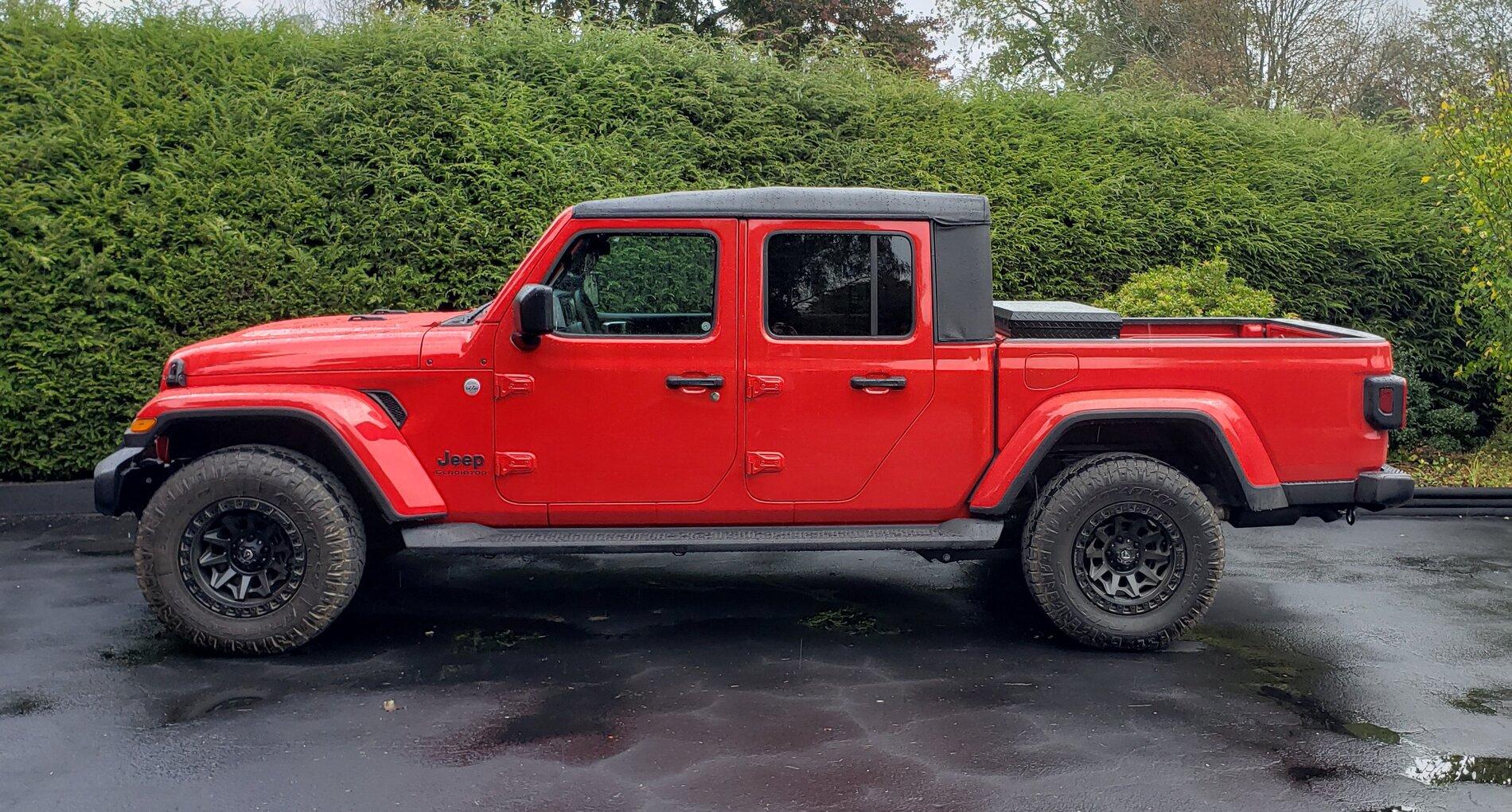

Honestly, I think most of us do it for the looks. In stock form the front end, on some more than others really looks like its sagging. The pic where its facing right really shows it. The one facing left, all plain is in stock form doesnt show it as clearly. The last one, with the roll bar, is with a 1.5 in the front and 1 3/8 in the back. I did the back because with the roll bar and diamondback cover and gear, she settled about an inch. Because we run a solid axle, the lift doesn't affect the alignment at all. The only thing affected is the movement of the track bar which could affect the steering wheel position. But, for a 1.5, it doesn't and there isn't anything else to do, just stick the hockey pucks in there! I did it in my driveway, front and back in about 4 hours. And before anyone fires back, yes, it does help to fit a 35, no argument, of course, there. FWIW, i am running 285/70r17, a 32.7. And will definitely nudge it to a 285/75r17, a 33.8.
