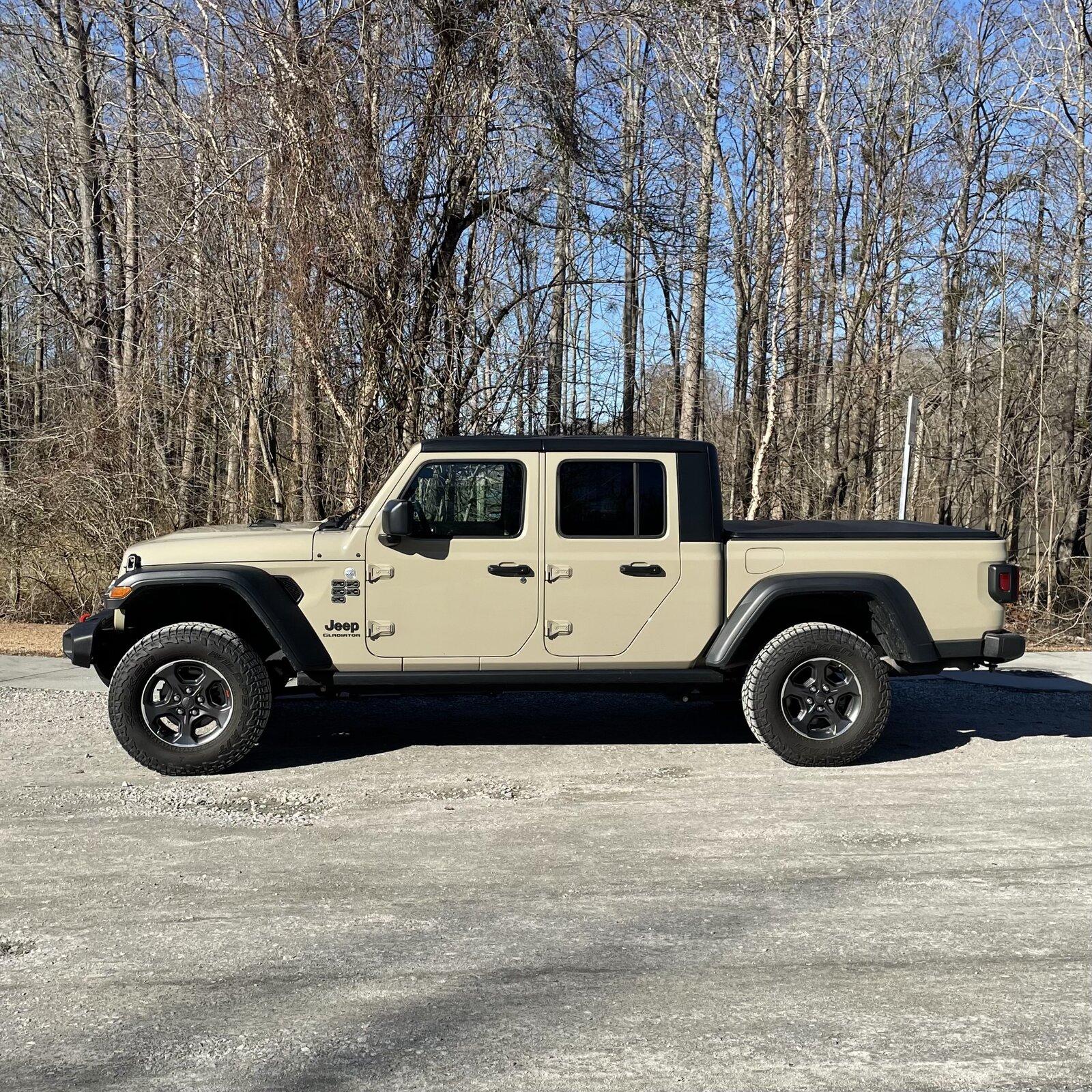

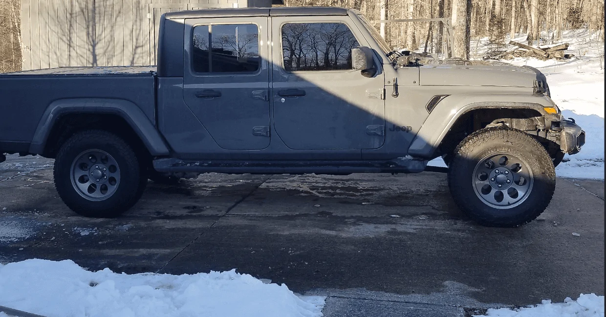

Do you have a pic without the bed loaded?
Just went and snapped one. I went with the Rancho kit as I heard too many people complaining about the additional sag when they added a bumper/winch with the Daystar kit. The updated springs should prevent that and keep it pretty much where it is now.

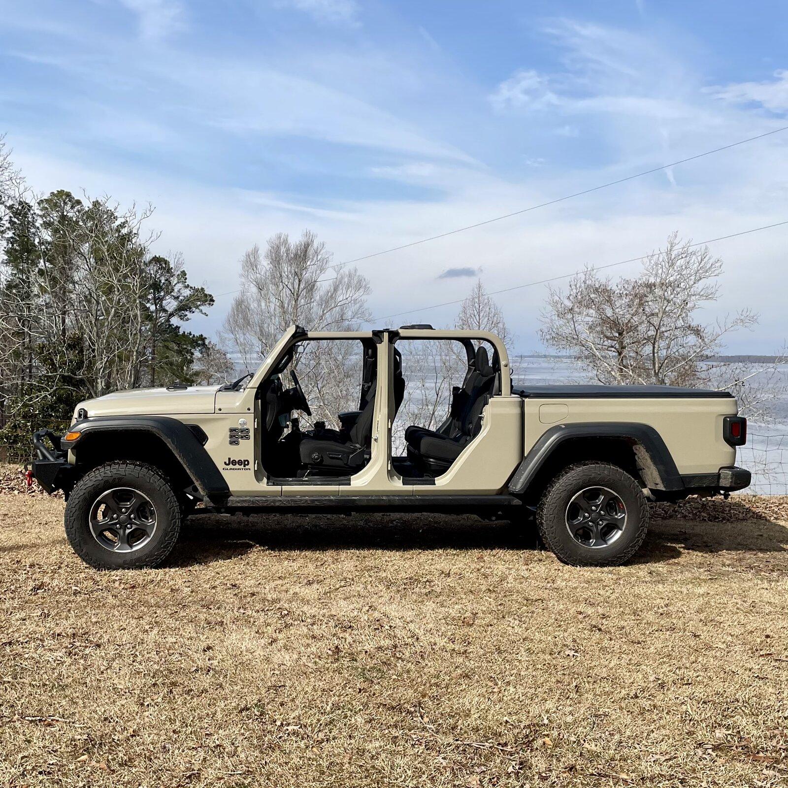

What steel bumper did you go with? Is your Rubicon gas or diesel?

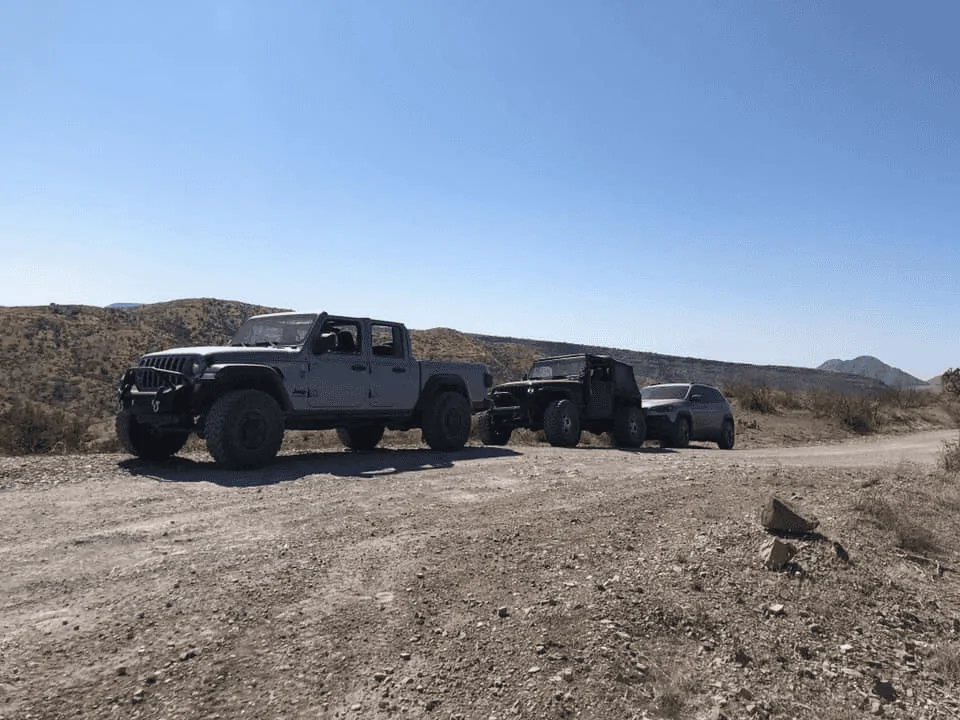

Fab Fours stubby. I have a gas Sport S with Rubicon suspension swapped in
Jeep Gladiator Poll: Do full 1.5” or just 1” for teraflex leveling kit? 1614804469627

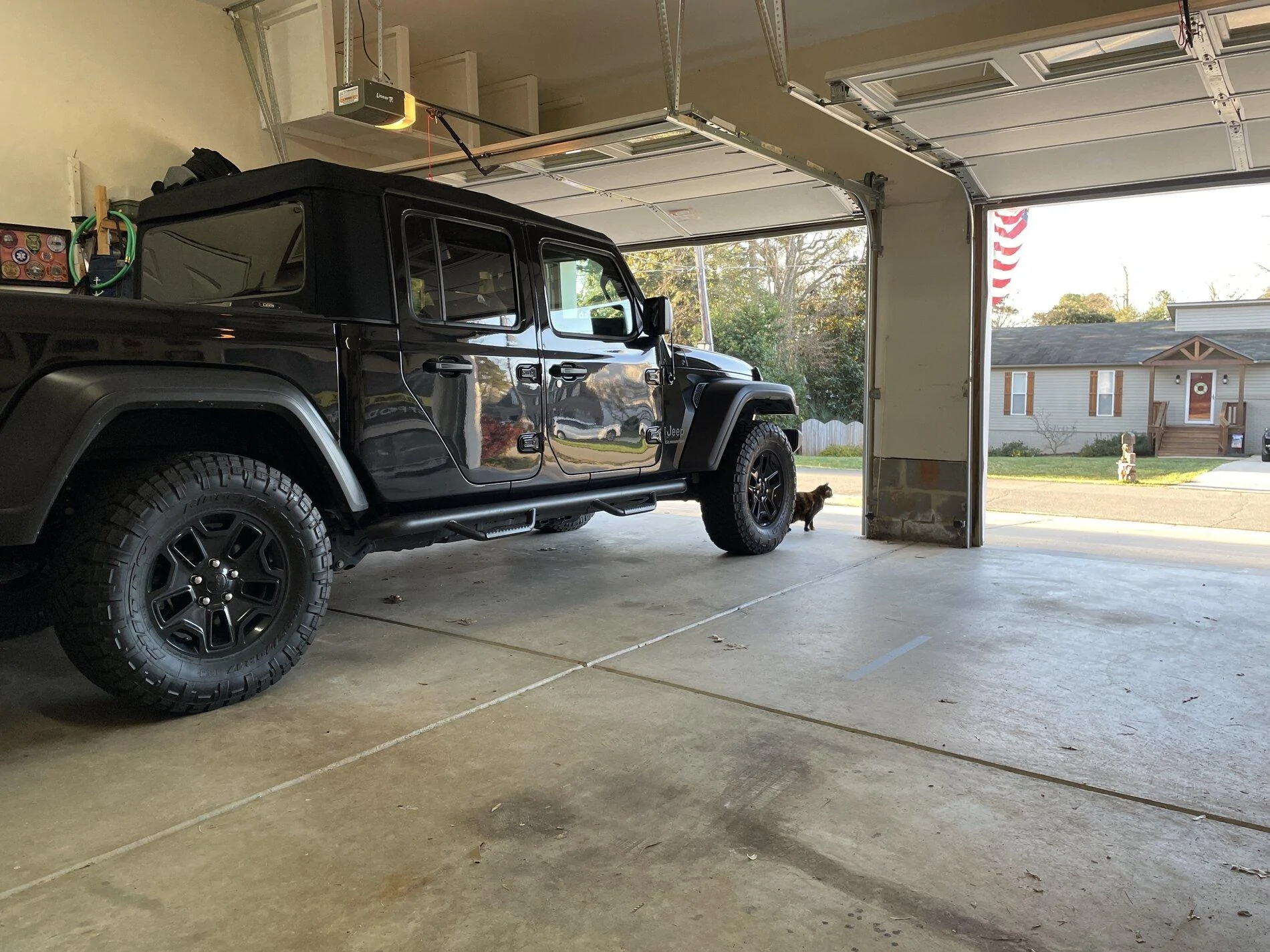

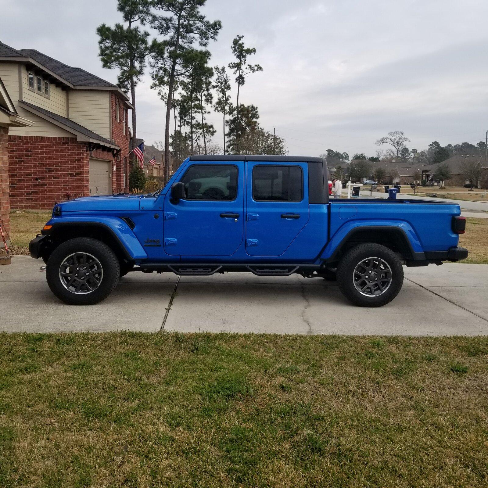

Thanks for the input guys i ended up finding that most people ended up adding or wanting the additional 3/4” in the rear so just went ahead with the 1” to give me a little bit of wiggle room(exactly 1/2” lower in front) when carrying/towing heavy loads. Came out awesome!
Jeep Gladiator Poll: Do full 1.5” or just 1” for teraflex leveling kit? image

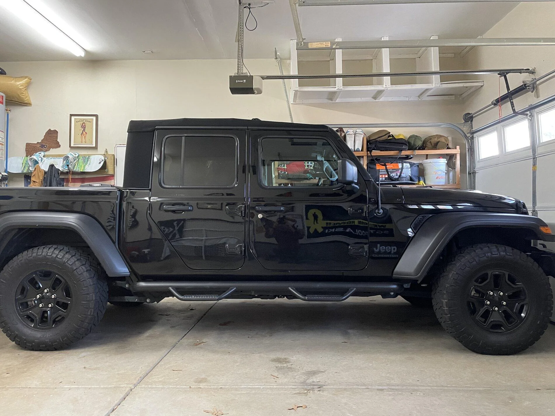

I would go 1" (I'm thinking that as well on my Sport S). I actually like a little rake and loathe the Tacoma pre-runner look on a daily driver (that's just my opinion).
I went 1” check out the pics sits perfect...exactly 1/2” higher in the rear. I would say do the full 1-1/2” if planning for steel bumper/winch.

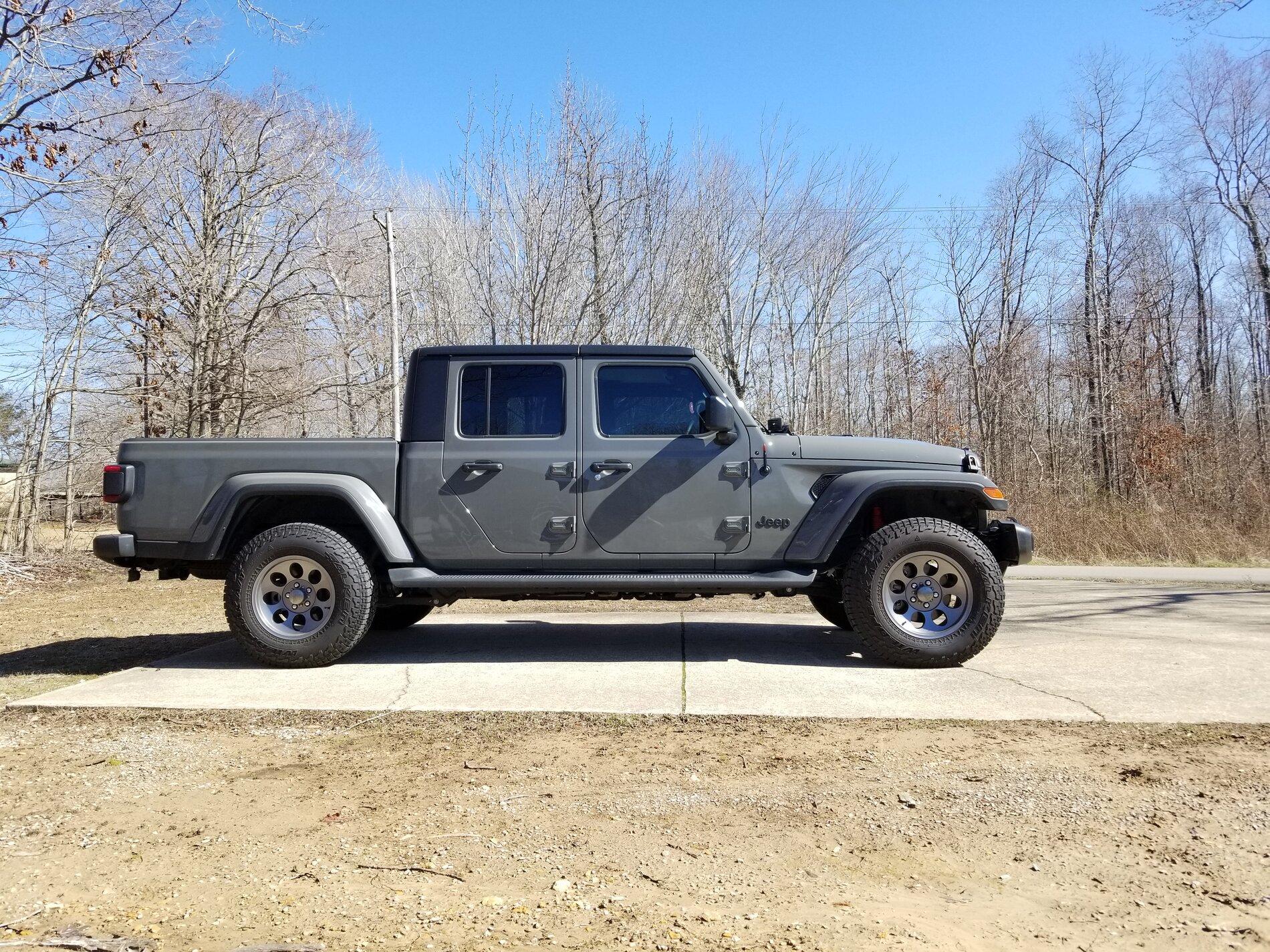

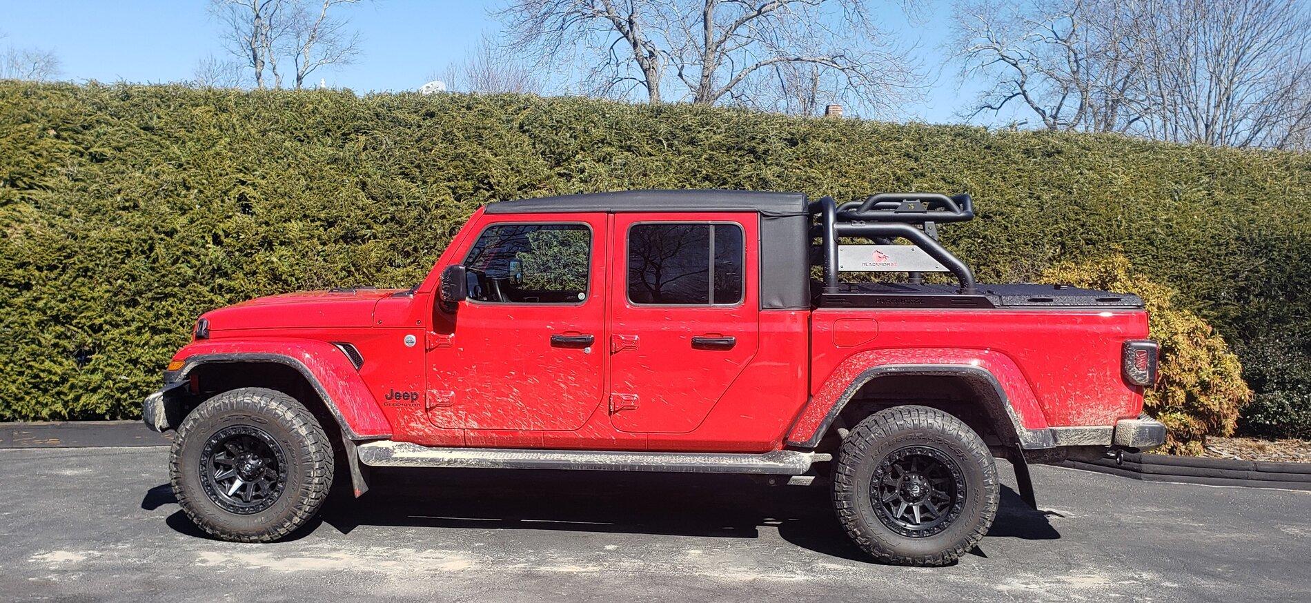

Sport S and did the Rancho 1.5" Level it! kit...going to add a 3/4" spacer in the rear as I belive it sits a bit high in the front. this photo makes it seem like there's more front end lift as it generally looks perfectly level, but I have about 400lbs of concrete bags in the bed:
Jeep Gladiator Poll: Do full 1.5” or just 1” for teraflex leveling kit? AE69221A-61FE-44FF-864E-D0422CBCD30D
I’m highly considering the rancho 1.5 for my Sport S max tow. Sitting on 33x12.5x17. Would you recommend it for light off roading. Did you change out control arms or track bar ? Thanks

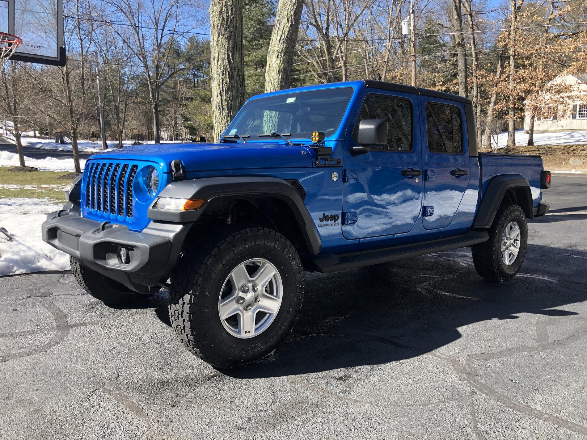

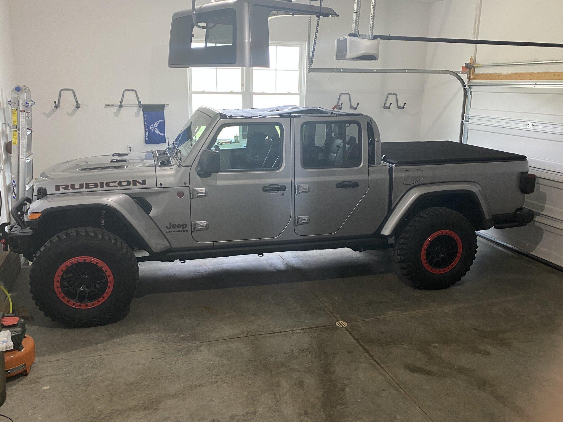

Max tow with LE front springs, 340 and 343, Rubicon shocks, Daystar 1.5” front and .75 rear spacers, Mopar LCAs from the 2” lift kit. 34” Toyo tires.

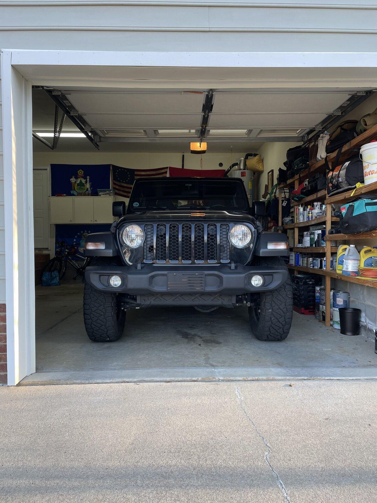

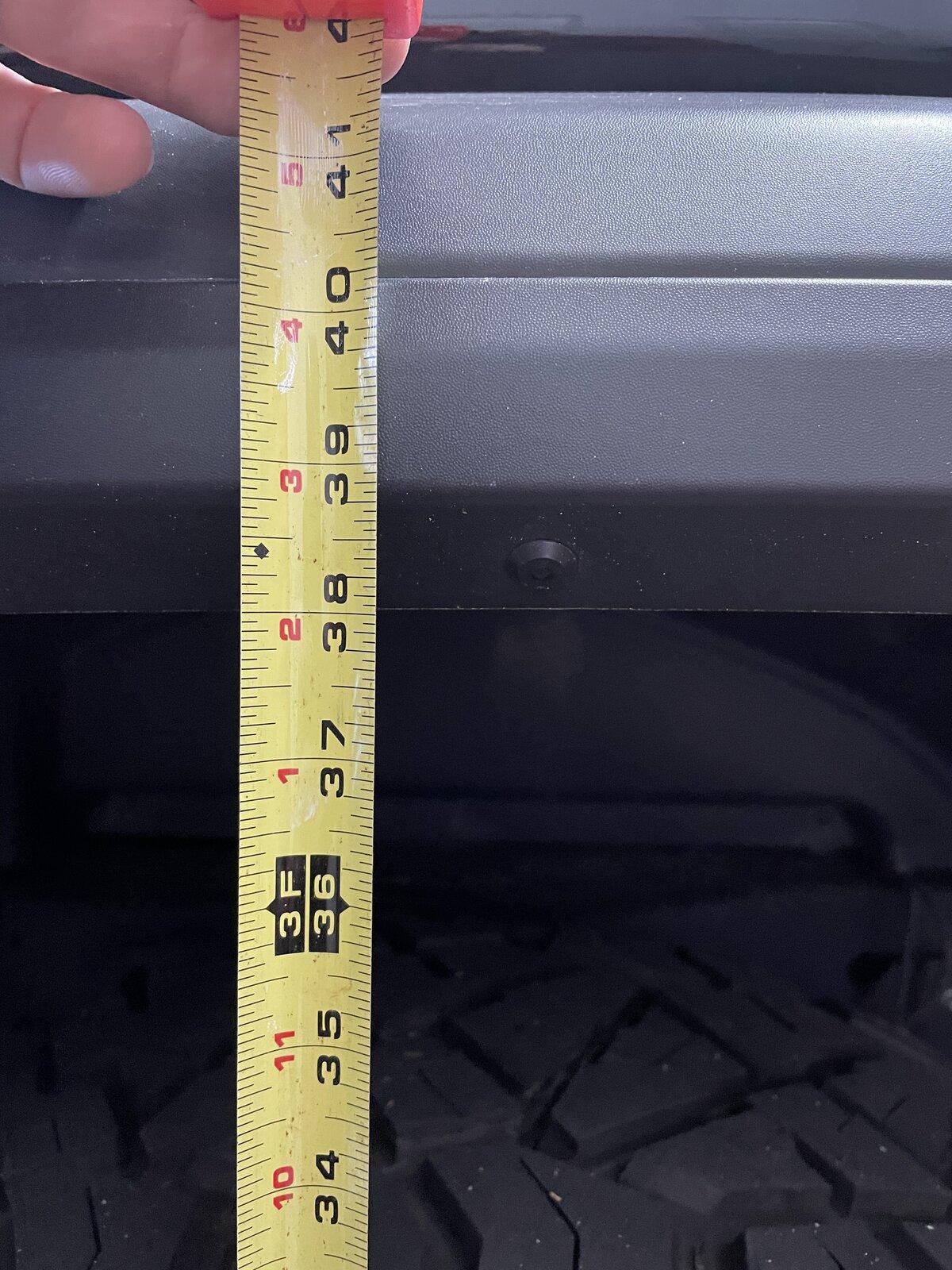

Jeep Gladiator Poll: Do full 1.5” or just 1” for teraflex leveling kit? 20210305_094410

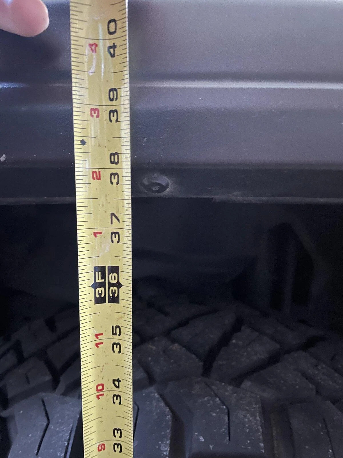

So measuring from ground to bottom of the fender is probably not a good representation of level, I don’t believe the fenders are the same height when the truck is actually sitting level. My front fender height was about 1-1.5” higher when it was level. You need a consistent measuring point on the frame or maybe at the front and rear edge of the pinch seams to tell if the truck is sitting level. With my front fenders higher with my level, my pinch seam was dead on front to rear.
