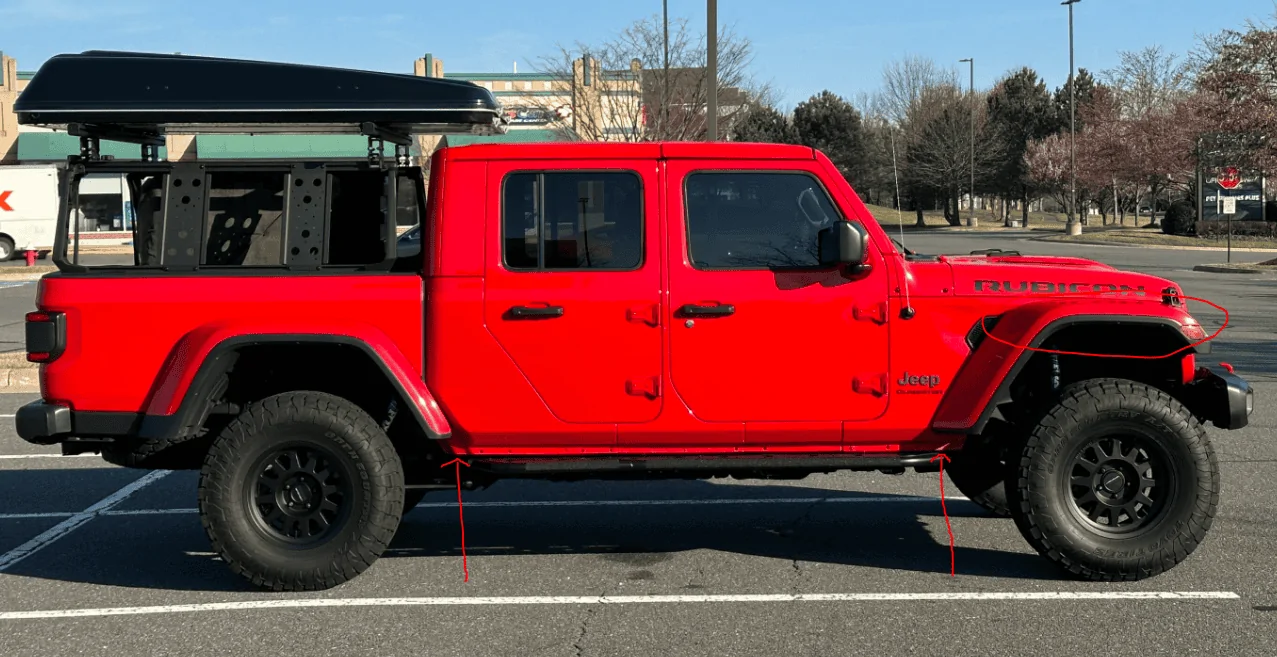

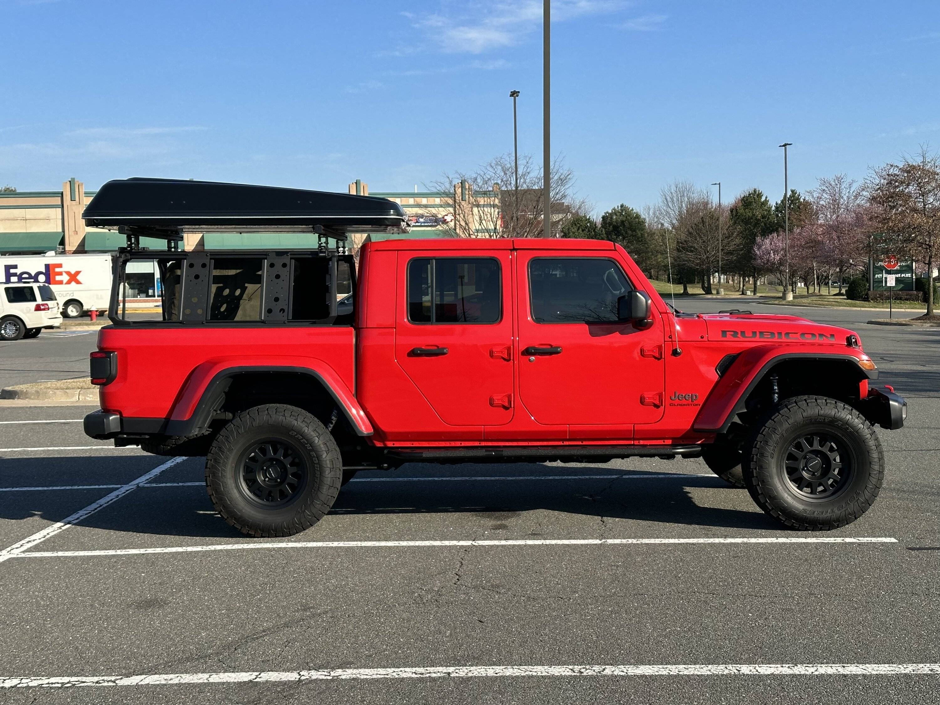

Whelp, here she is as she sits: JKS 3” jspec, Fox IPFs, BDS rear heavy spring, and my VKS sliders ?
All I have in back is empty Decked drawers, fridge/cage, rack, and tent. Picture is in as level ground as I could find. I’m taking recommendations for rear spacers now and a tad unhappy it’s sitting as such, but it is what it is. I thought the front will settle some, especially with bumper/winch once added, but the entire bed, etc is empty and I’m starting off at -1 ride. 1-2” spacers, thoughts?

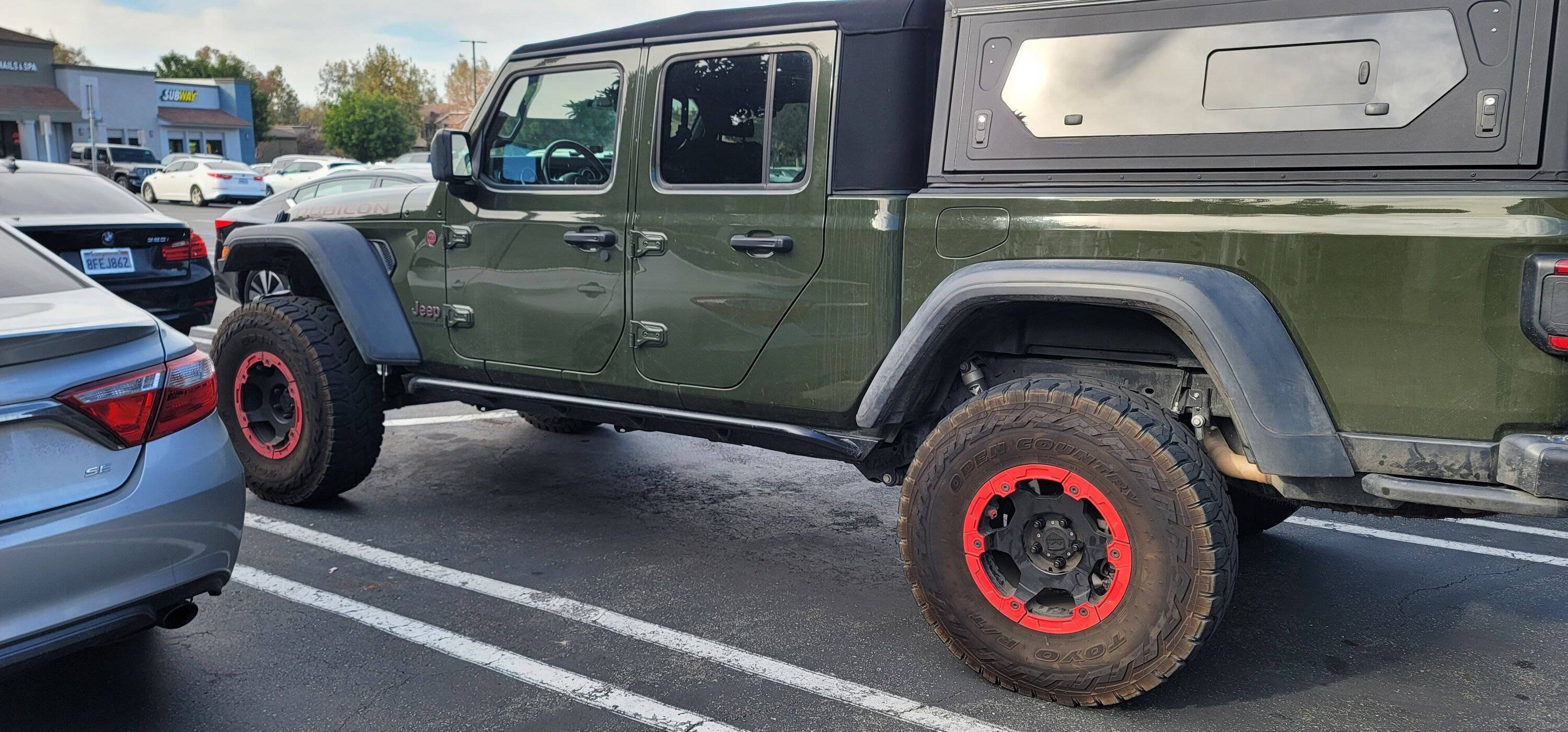

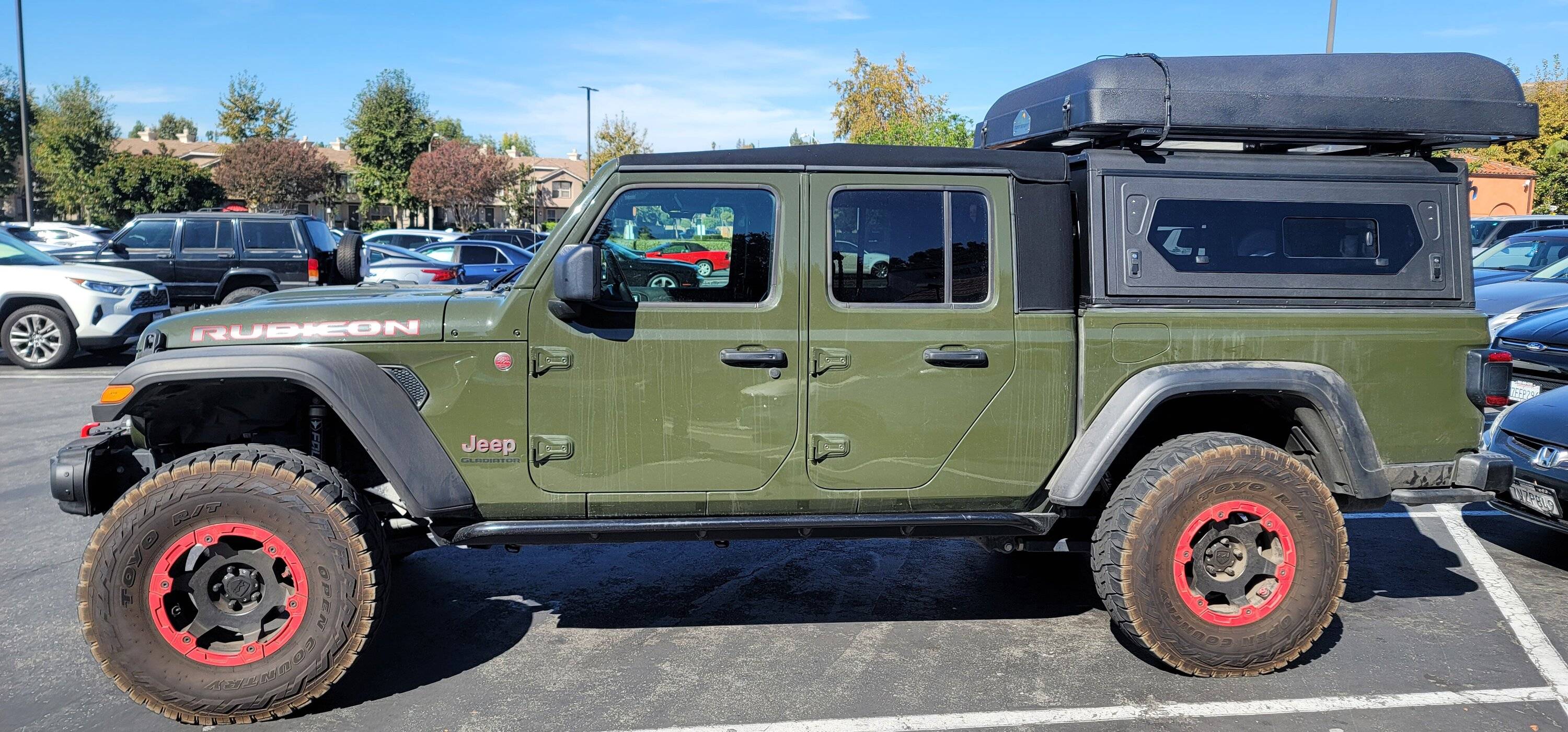

Looks like mine at the beginning with Clayton 2.5" (first photo). Then switched to Dobinson 3" extreme duty (2nd photo). Chose the 3" Dobinson since peeps claim Clayton 2.5" is more like 3". Worked out pretty well. Rides better too. Photos are not at the best angle but I think we can see the difference. I run a constant 500lbs or so, maybe even 600lbs.
What rear spring# of theirs you running? I’m going to start with a spacer first I think, 2” or so. I’ll see how it does and get her new spring info till then. On my GX460 I ran the Dobs 749v and still sagged and she was heavy with the LRA tank and Bush Co tent. Had spacers too; still not it. Eventually got turned on to the OME2899s, a 800-1000# rated spring, and golden. That was the third try at it lol, try and try again right ?
