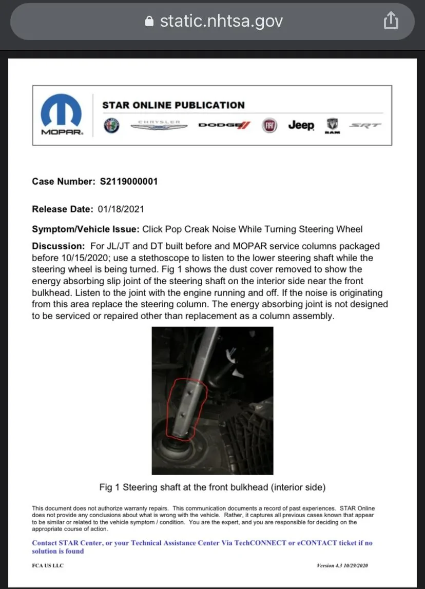

If you’re hearing it when turning the steering wheel then it may be this TSB below. I just dropped mine off at the dealer last night for it. I’ll repost here when the verdict is in.
Link here:
https://static.nhtsa.gov/odi/tsbs/2021/MC-10187056-9999.pdf

Mine does this, so I'm glad you posted it, but I wonder what the fix is. Even still, I wouldn't think it would be confused with the steering linkages or suspension popping. The steering column sound is more of a "click".
From my understanding they will HAVE TO replace the entire assembly causing the issue with an updated assembly revision/design. So repair won’t be an option for the dealer per FCA. Some Gladiators built pre-October 2020 I guess got defective parts.
My noise started as a whining sound that I could only hear in parking garages. It then got a faint click a couple hundred miles later. Now at 1500 miles, the click is a full on pop noise toward locking the steering wheel.
