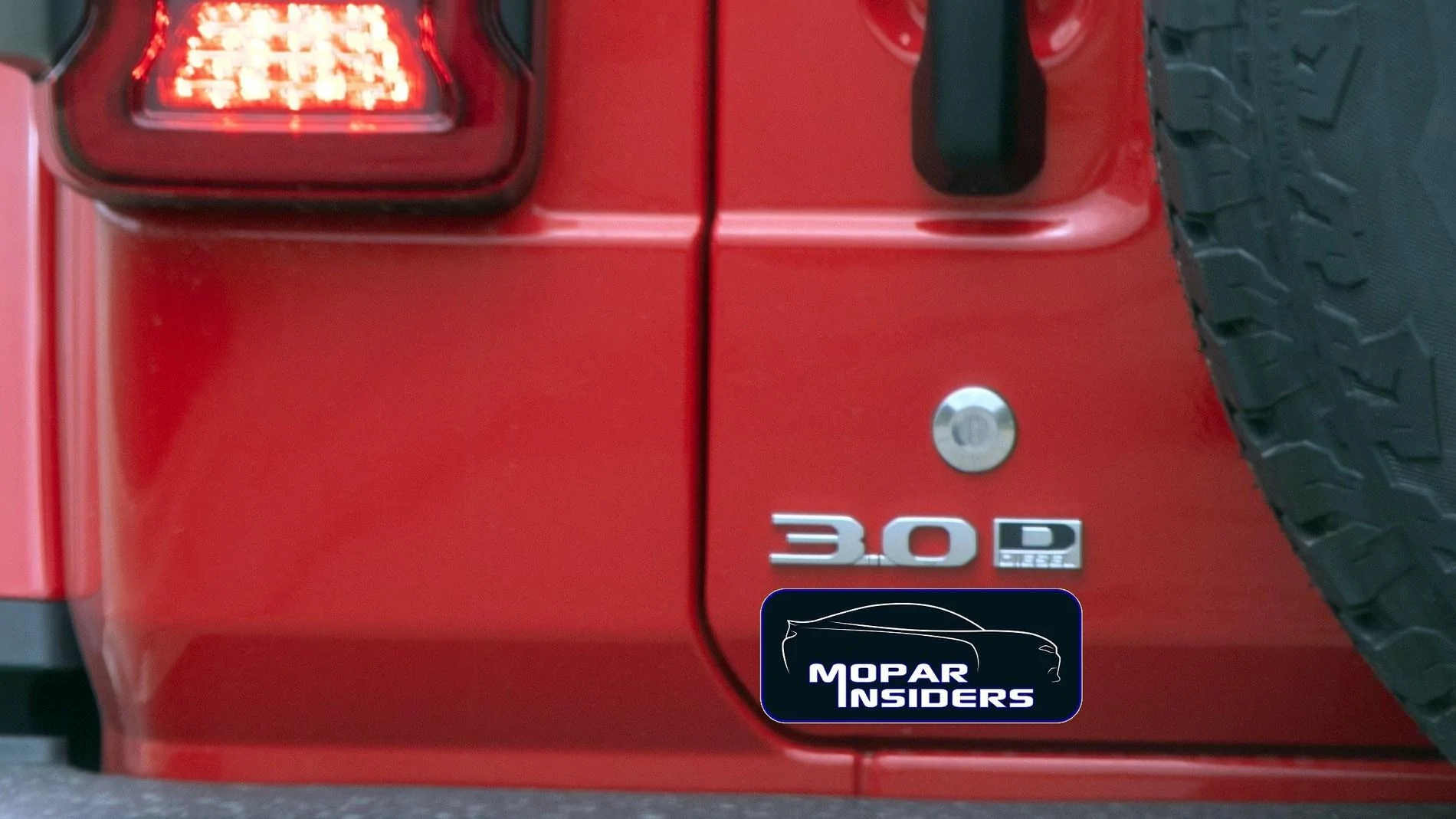

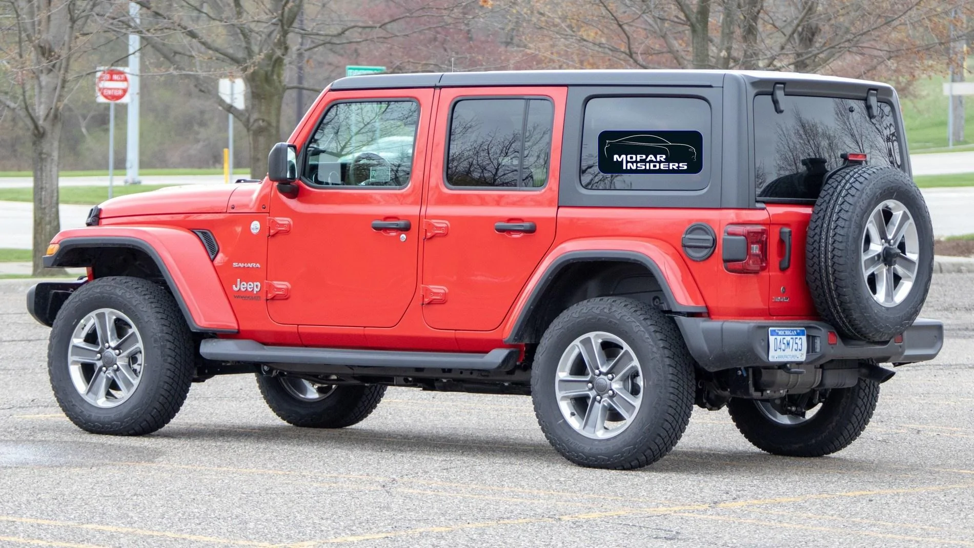

Not sure what you mean? My stance has been Overland (Sahara) and Rubicon every time this question comes up and your pic supports that.....
Just sayin the pic does support the theory. :like:
