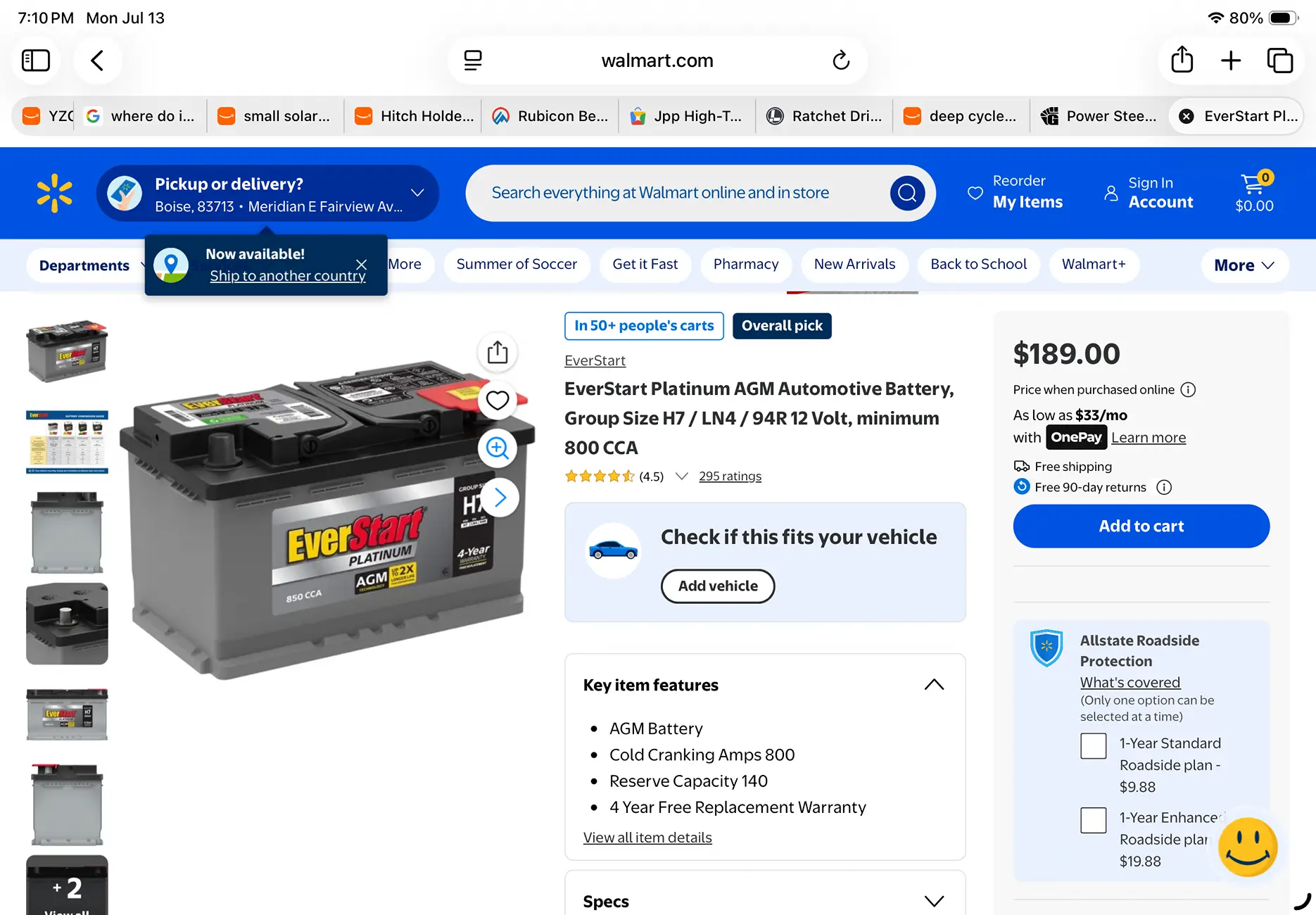

Free install at a Walmart Car Service Center and a 4 year warranty. Delete that POS lawnmower battery underneath the main after you get home.
Jeep Gladiator Power Steering Recall issue IMG_0318
