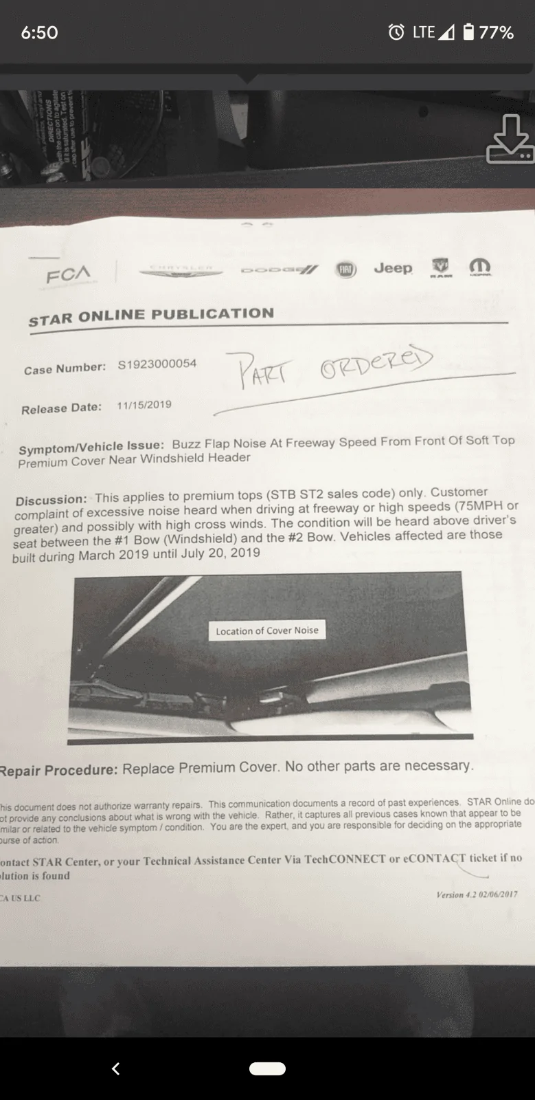

There's another thread somewhere here with a service message about the fix.
Basically replacement fabric

Had this problem and finally got dealer to replace the top with the FCA alert in hand when I took it in. The new top fixed my problem. The weird harmonic was so bad at 75-80 the rear view mirror was vibrating and you couldn’t see out the rear! All good now tho!
