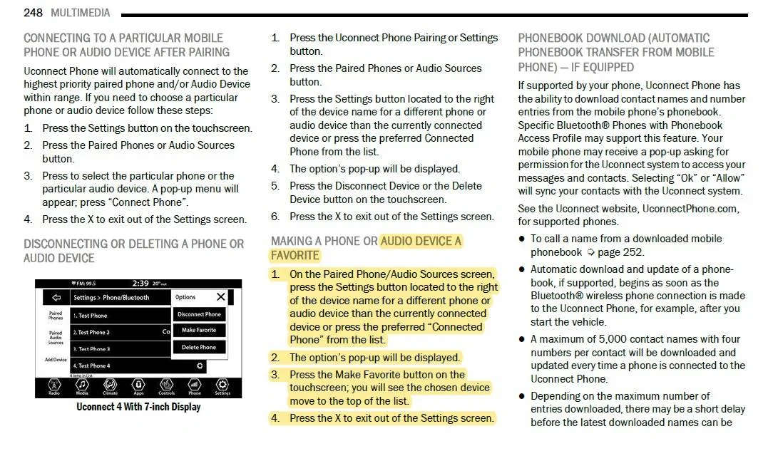

Your situation is weird. I have had both the 7.0 and 8.4 radios and never had it default to radio on startup unless I was on radio when I powered off. I have done this both with my Samsung Android phone BT paired, unpaired and with and without USB cable attached.
In going through the Owners Manual for the Multimedia, I seen a section for making a phone or other audio device a "Favorite" from the currently connected device. Maybe you can play with that setting and see if it helps? Could be set to radio and that is why it defaults to radio at every startup?

Searching this forum, seems lots of others have the same complaint as I do.
The "favorite" setting only makes one BT device preferred over other BT devices. It's not available (grayed out) when only one device is paired. I've searched every menu and tried every option.
