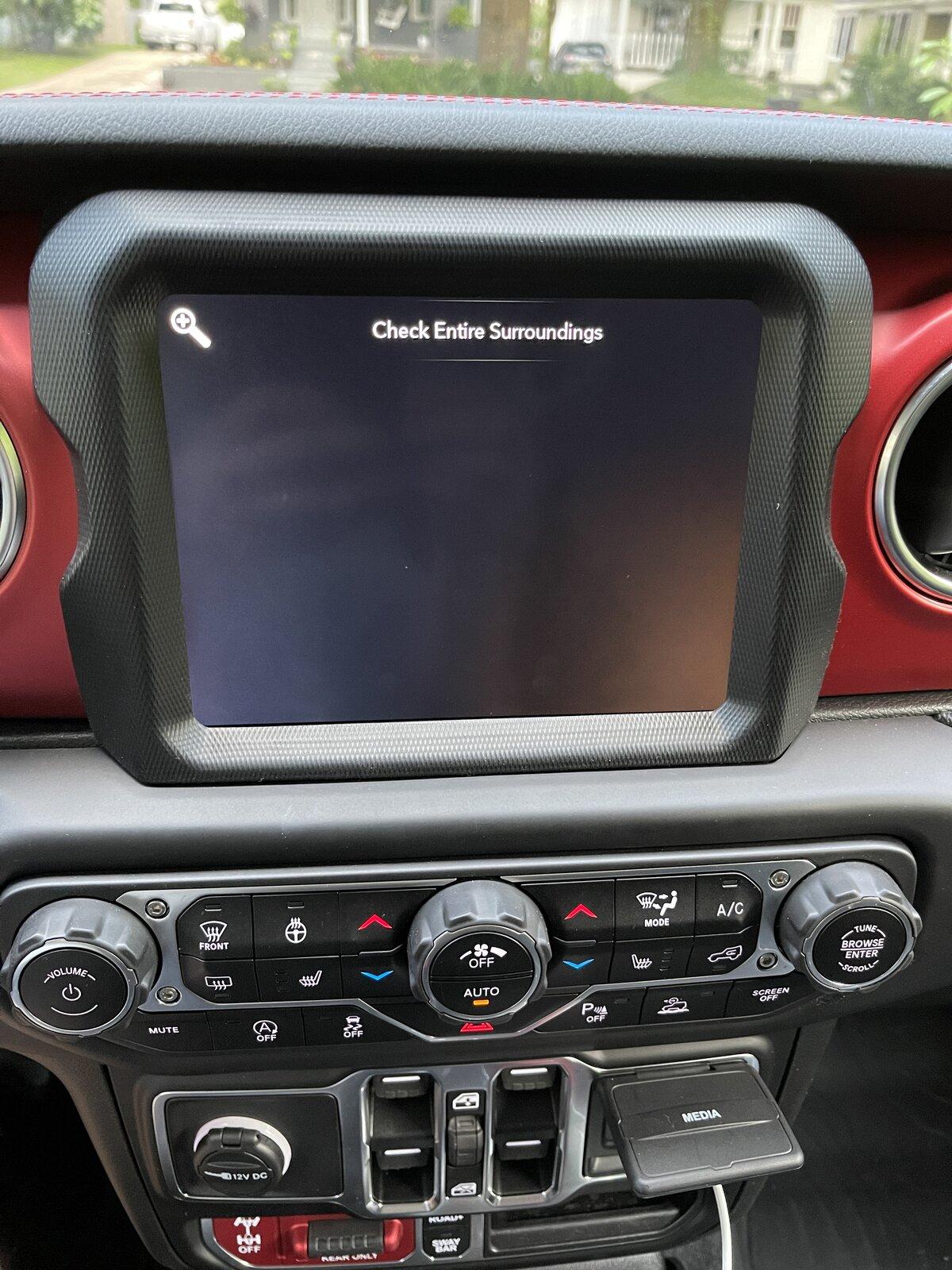

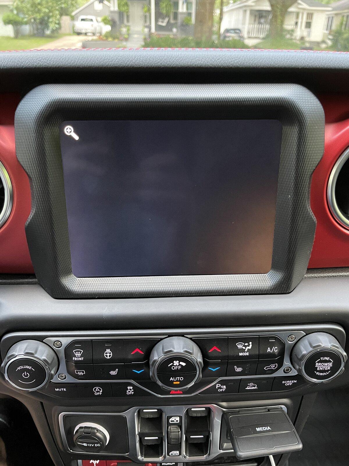

Same problem here (2021 Gladiator Rubicon). Backup camera worked fine all day today, until it didn't. When I put it in reverse now, it shows the magnifying glass and "check entire surrounds". The verbiage disappears after a few seconds. All the while the screen remains black.
Here's a few photos of this behavior.
I'm hoping it clears itself up overnight ... not really looking forward to a warranty claim on a vehicle with only 1600 miles.

... and it's working again. Came out to the truck this morning and it was like nothing had ever happened to the backup camera. Bombed around all day in it and the reverse camera worked perfectly every time.
Fingers crossed that this was an over-the-air software upgrade. If it was, I really wish there was some indication that it was happening.
My backup camera started failing similarly yesterday. Noticed in the morning and drove nine hours and it started working again at the end of the trip. Works this morning too.
Sent a message to @JeepCares. Hope they acknowledge the problem and find a solution.

When mine did that, I took it ion to the dealer. Props to Performance of Columbus. Free rental while they had it all day. They have a diagnostic tree to follow and finally found a loose connector. I'm guessing behind the plate in the tailgate?
