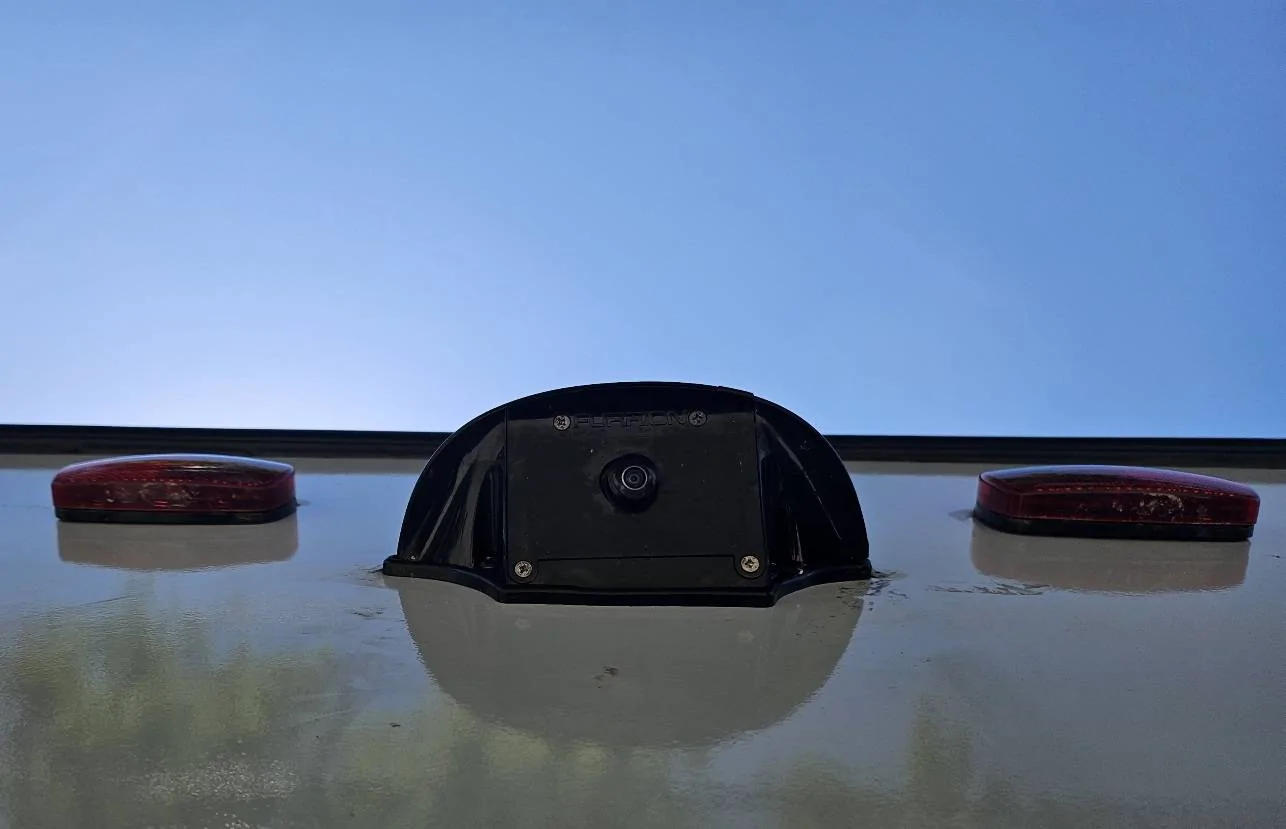

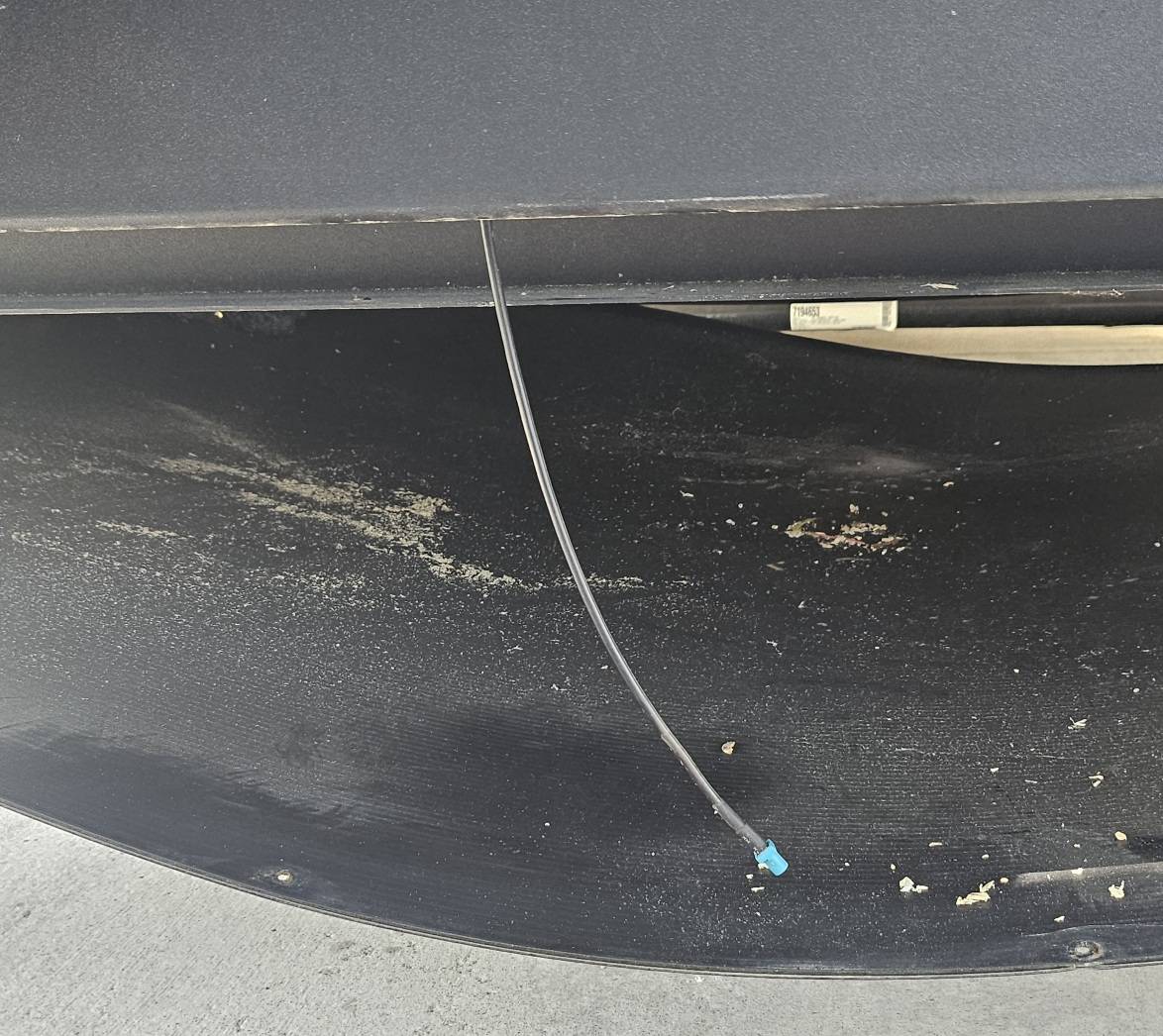

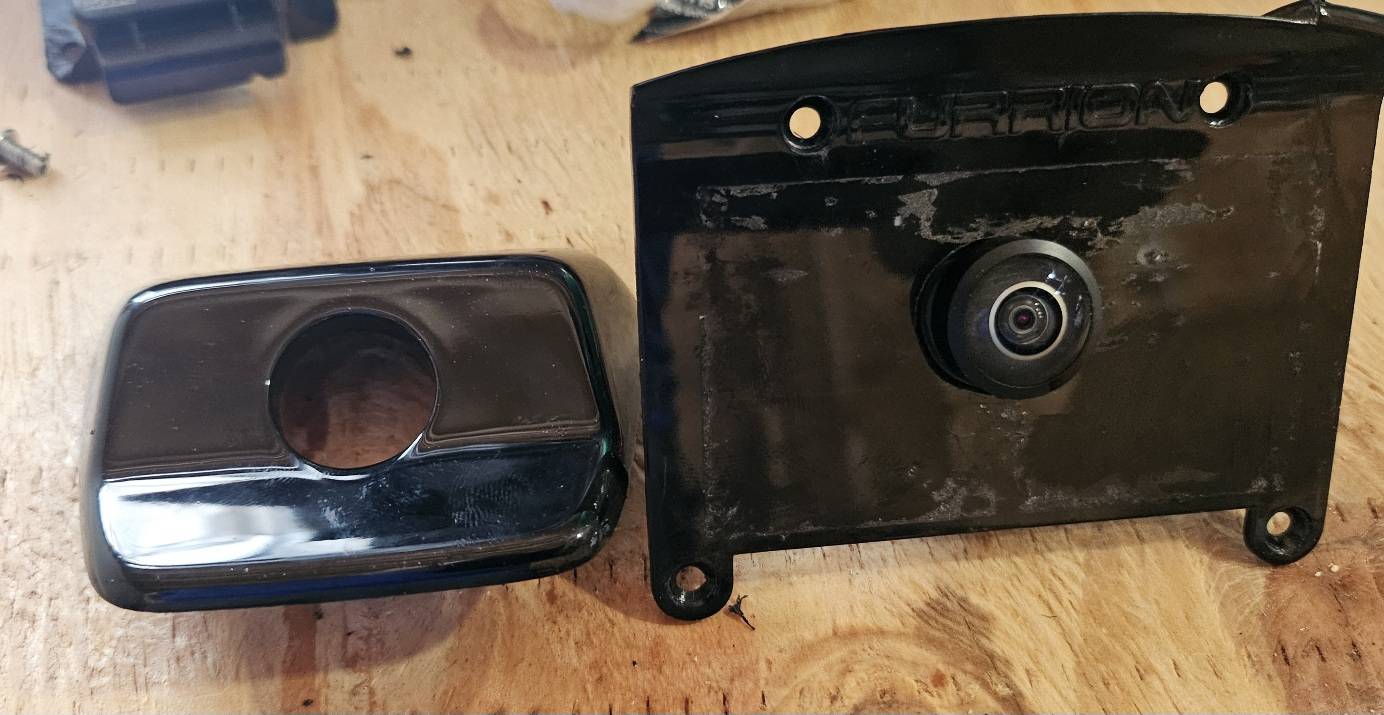

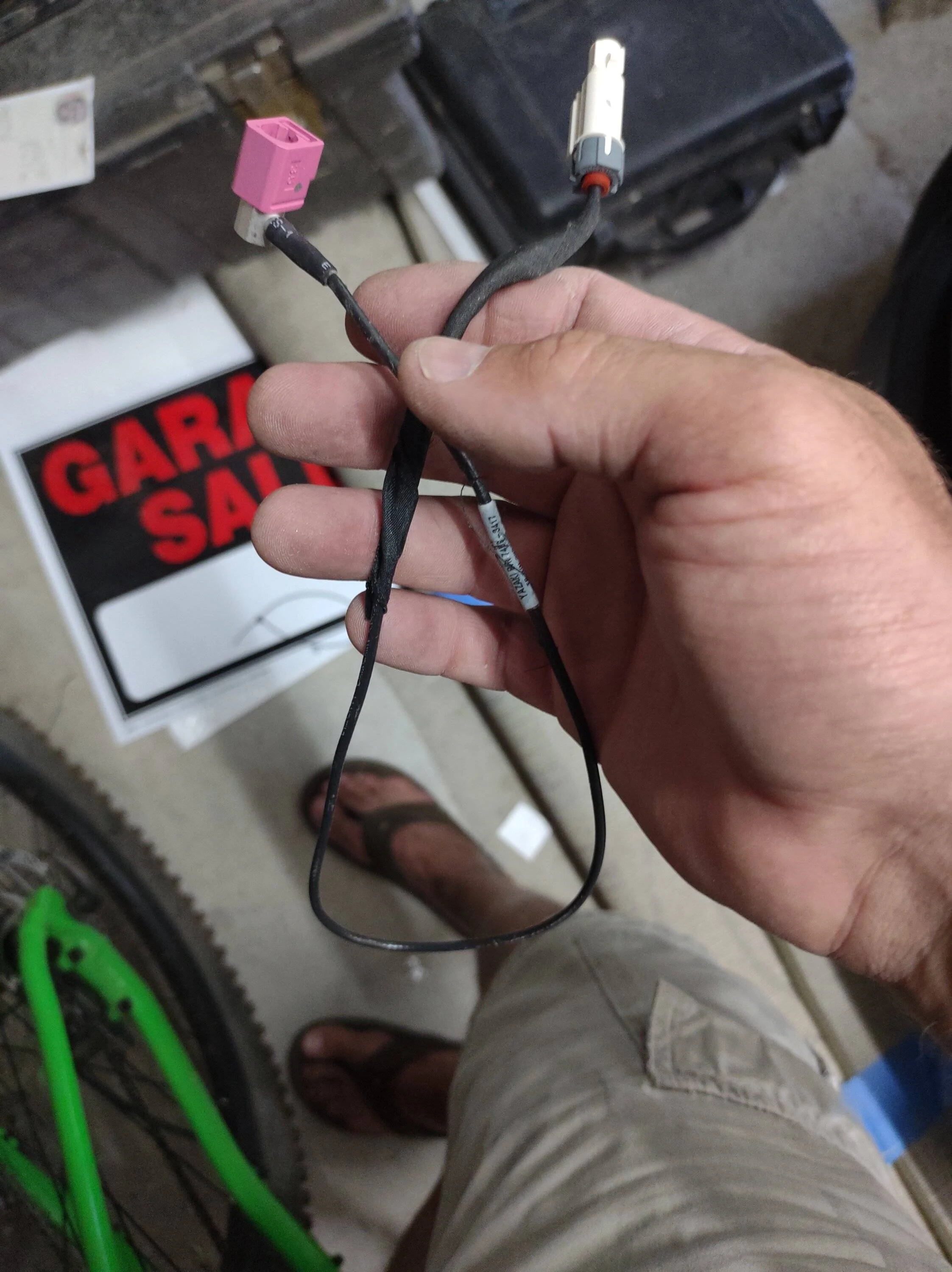

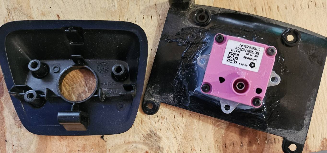

I finally got around to installing this and I'm very happy with how it came out.
Thanks to @Jimmy07 for links tothe right cables and @Free2roam for the short cable! This would now have fit without the 90 degree connector on that piece
I removed the factory installed furrion mount from the camper, and fished the 25ft coax thru the wall to the bottom. Then ran it under the camper above the enclosed underbelly panels. When I hitch up, I have a 6ft coax to go from the truck to the end of the 25ft coax
I removed the oem camera from the included bezel, drilled a hole thru the furrion mount cover plate, and glued the camera in. I don't think anything will move as it's pretty tight inside that mount. Very happy with how it turned out.
