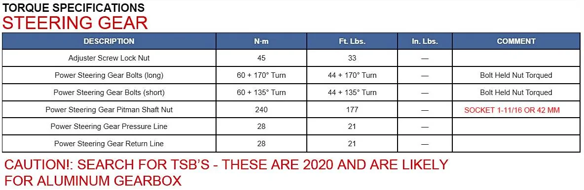

If people knew what they were really "adjusting", they'd see why dealers don't do it.
It's a process that no one is following. They are risking the health of the steering gear/steering sector when adjusting that.
Likely they don't know how, and also likely they don't care to remove the steering gear to to the adjustment properly.
You don't just "tighten that screw" until it feels good. No dealer should be touching that.
You first, with the steering gear disconnected, adjust the worm shaft bearing preload, then when that's done, you adjust the over-center force and the spec for that is a combination of the two. So you can't do one unless you do both. And if you tighten that over-center force too much, you will end up wearing out the steering gear faster than normal, or even cause it to bind on center.
Having rebuilt a few steering gear - not going to argue because "I adjusted mine and it works fine" is what I'll hear. Yeah, ok, whatever.
Who knows what Jeep does with the steering gears that get replaced - likely go back to Saginaw or whoever makes them for root cause diagnosis, forensics.
But a dealer adjusting? No way. I don't want them doing that detail work that requires taking things apart, knowing how to use and read a torque wrench, and actually possibly messing it up in the process.
It's very possible that those who are "fixing them" by just tightening a screw (a screw which they have no clue at all what it really does!) are just masking the underlying issue. But it's their truck as long as no one else gets hurt because they make a corner and then can't straighten it back out.
