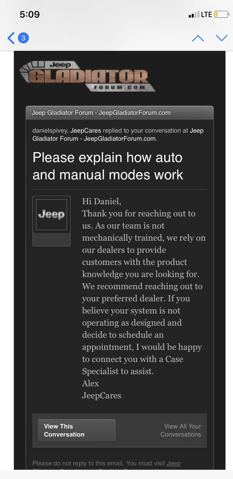

And the verdict from Jeep cares is....
So basically whatever your dealer says, which as we all knows CAN vary dealer to dealer! Back to square one. Honestly, that probably was the worst answer they could have of given us :(

I didn't expect them to take a stance. To me, the Jeep tech's response is much more telling.
Dang, I guess should have suspected that. They are more a go-between than technical adviser. Yeah, I'd not even want to ask my dealers here- one of whom didn't understand "hard reset" for the uconnect, kept telling "well we don't do updates" and I said NO, RESET and he said "you'll have to wait and they'll send you the update - I walked away.
Which will be all over the place depending on who you ask. Don't bother with a sales person, and don't bother with the service writers, and even in the back where they actually get dirty - I've found them shrugging at certain questions. Stuff I almost know more about than they do. THAT is scary.
Sad that the response is so vaque- the dealers have an “instruction manual” (for lack of a better term) that I looked through on the sales floor that explains how all the systems work so they can talk intelligently to the customer. Why @JeepCares can’t quote from this reference is beyond me. Perhaps all dealers don’t use this manual or the service department doesn’t have a copy, which would explain the poor responses provided when taking these issues to the dealer.
