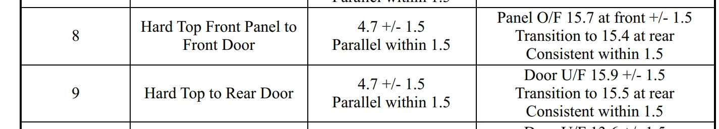

My next step if I can muster it - remove the freedom panels (dr. says no lifting over my head over the weight of a gallon of milk) and measure some areas and see if I compare that to others.
I finally got the folks at the dealership to accept that the freedom panels will fit fine because they don't rely on the side rails at all - just the front of the hard top and two spots at the top of the windshield frame area. So there's no relationship. For a while they said if freedom panels fit then all is fine. Not true.
Can you do a swap with your gantry crane?
40,514
54,043
My next steps would be - remove freedom panels, get that 8' level or some other long straight edge out and lay it across certain areas and measure down - such as lay a level across where the panels mount to and measure down from that to some other point, like the sill of the door opening.
Then - compare those measurements to another Jeep where a top fits perfectly.
Gantry crane is a bit bulky, the chain hoist is off of it so it would need to be lifted up and put back on it (requiring a ladder), then moving the gantry crane into the shop................ almost as much work in the end!
Will check the panels to these specs, then measure with panels off - tops of the roll cage side bars down to the sill or rocker upper pinch weld area, that sort of thing.
