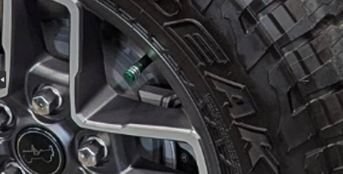

You could get the green valve stem caps if you want to spend more. 😆
The caps are green, but only because I wanted green caps that were aluminum with plastic liners to prevent them freezing onto the stems.

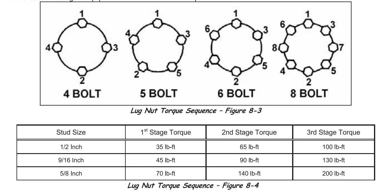

Check the owner's manual or any placards on your specific trailer to see what the lug nuts are supposed to be torqued to. There's a very good chance the correct spec is higher than 100ftlb. As an example, the ones on my 16RD are spec'd at 120ftlb.
Depends on the size of the bolt. Don't go too high on a smaller bolt.
For my Aluma trailer, here's the spec - (I opted for the aluminum wheels)
For Aluma trailers with aluminum wheels, the lug nut torque specification is typically 90-100 foot-pounds when using 1/2" wheel studs.
My trailer is a 5 bolt wheel and the lug nuts are handled by a 3/4" (or 19mm) socket so...how's that fit into your equations?
40,494
54,056
Go by the stud size, ignore the socket size as that can vary even with the same stud size.
