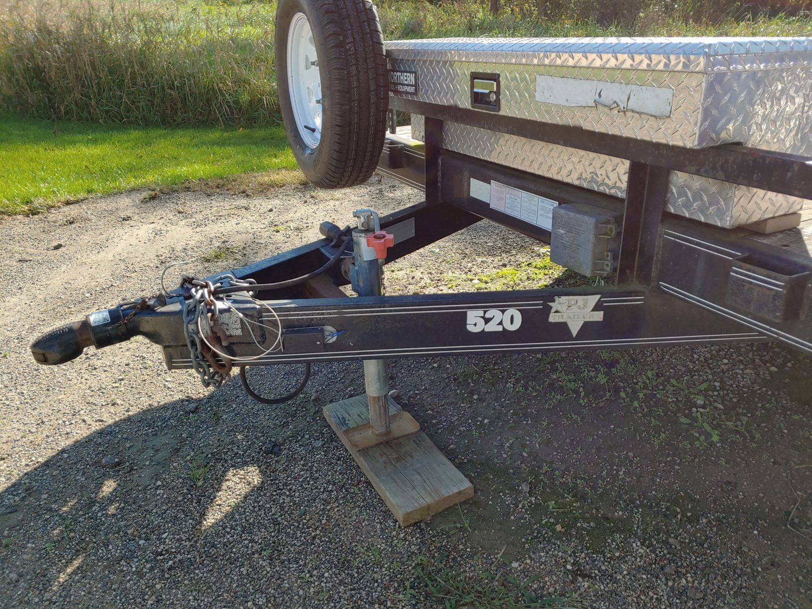

The PJ trailer I had -

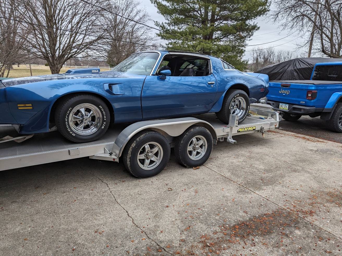

Aluma tilt-bed I have now. It was a short run so I tossed the spare in the back of the truck instead of mounting it on the trailer's spare tire mount seen in the pic

I typically lift the trailer off the tires for the winter, keep the tires covered unless using it and keep the spare in the garage away from light. Grease gun in tool box along with a hydraulic jack and other stuff.

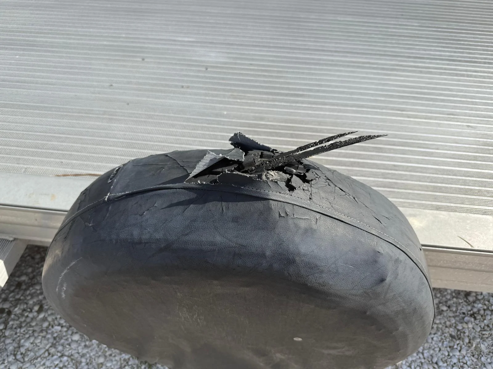

Noticed this about a week ago. Spare tire went boom just sitting next to the house. This was the last of the tires I got in 2022 from Simpletire.com that was date coded 2017. Never buy tires from that place. They were already 5 years old when they shipped them to me. I'm still pissed about it.
