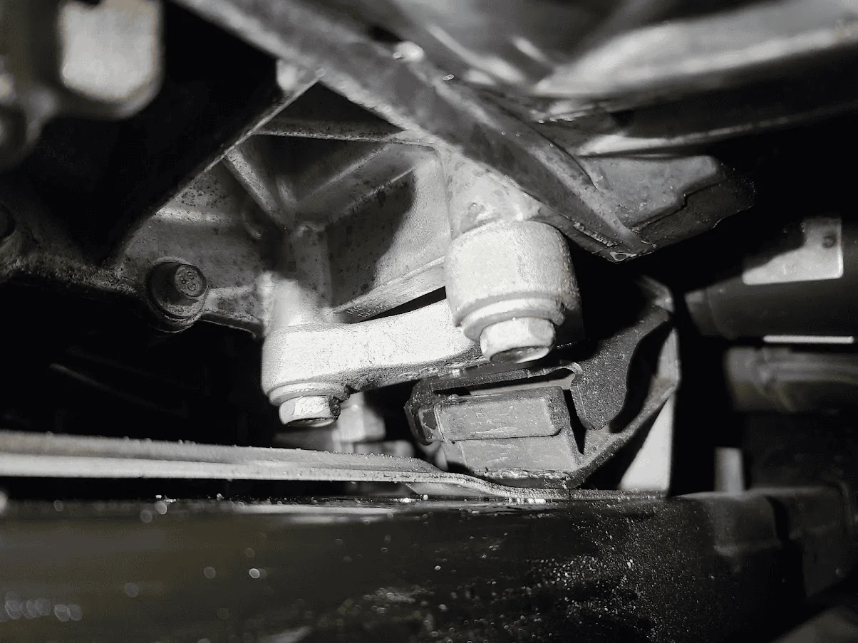

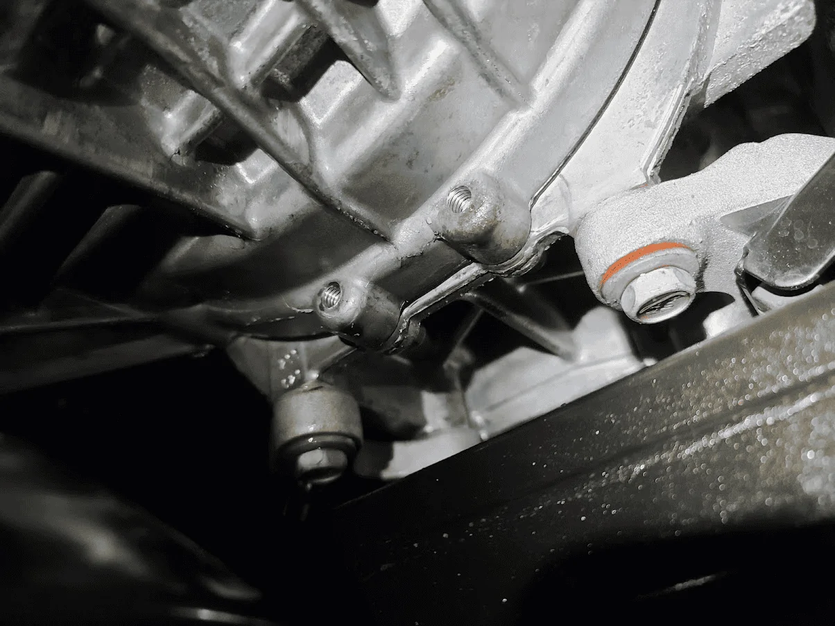

After a 2,500 mile road trip I found a leak that appeared to at the seal between the transfer case and transmission. I could see trans fluid from the transmission drain plug back to the transfer case crossmember bolts. It was not a drastic leak but a few drops, enough to catch my attention. After a trip to the dealer they could not initially determine where it was coming from either. They topped of the transmission, added dye, and told me to drive around for a week. I just got back from my second trip to the dealer and it seems as though the transmission drain plug is the culprit. It is torqued properly so there's something wrong with the plug/washer itself. After some digging my tech told me that this has happened to other gladiators as well but other techs had decided to do new seals and the plug. We are going to start with the plug (which seems to be the issue) and go from there. Of course it will take a week to get a new plug/washer so I won't have an update on that success/failure for another week or two. Once I do I will update this post. So, if you find a small leak don't freak out too much, it's likely the drain plug.

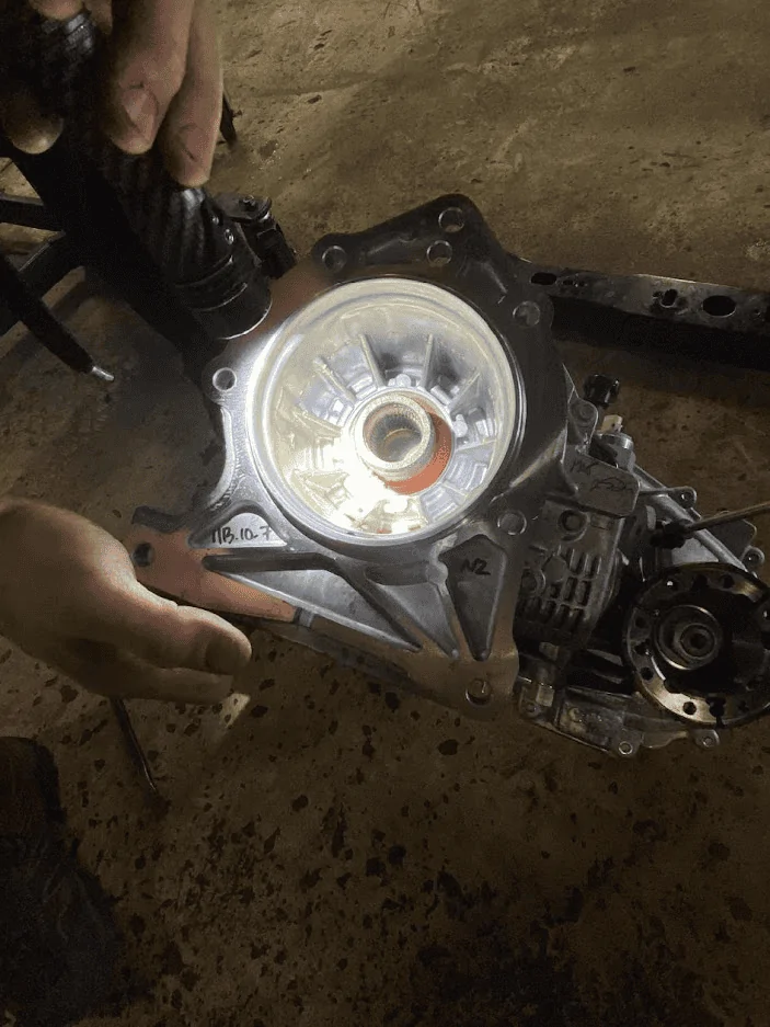

Hey, @RodRecket, did your leak look like this? Mine looks like ATF fluid from the transfer case, not the 6MT itself.
Did your new plug fix the issue? I just found a small puddle of ATF on my driveway...
Also, was there a TSB or any other documentation from the dealer you can share? Might make my appt go faster...

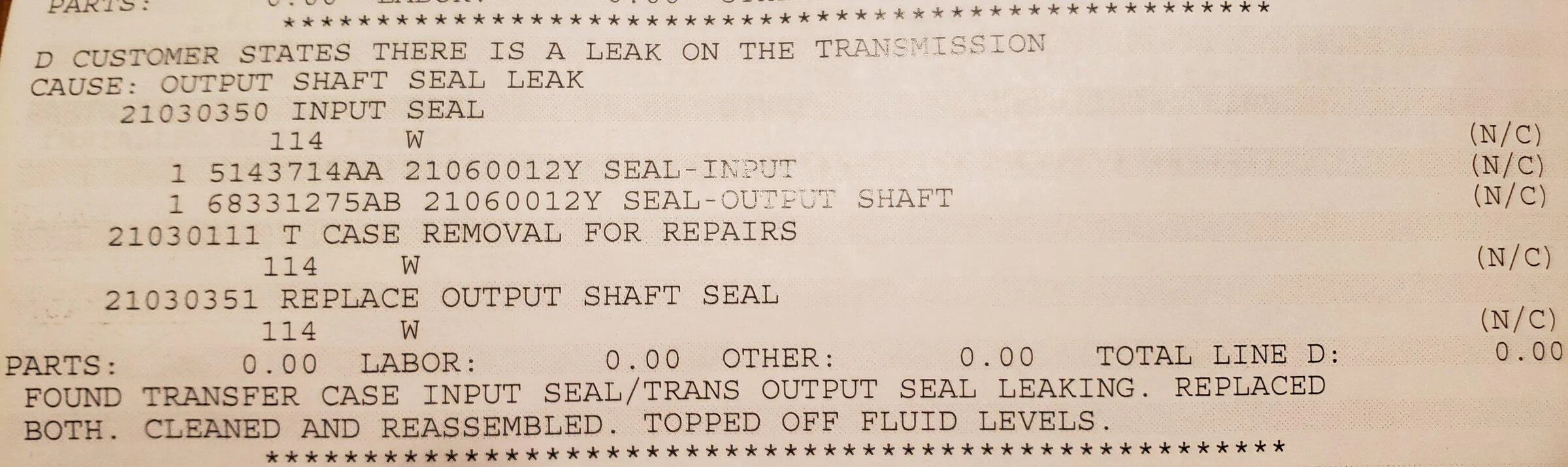

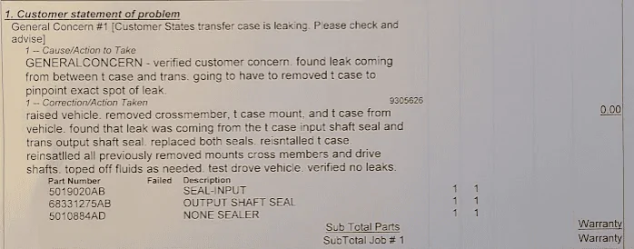

Yep, that's what it looked like when mine was leaking. It wasn't a lot of fluid but enough to be obvious. It was more than a plug issue, the actual trans/Tcase seal was leaking. My dealer service department was great to work with and everything should be covered under warranty for you too. Minimally, your the second person to have this happen so there is already some record of it. See pic for part numbers. Hope this helps

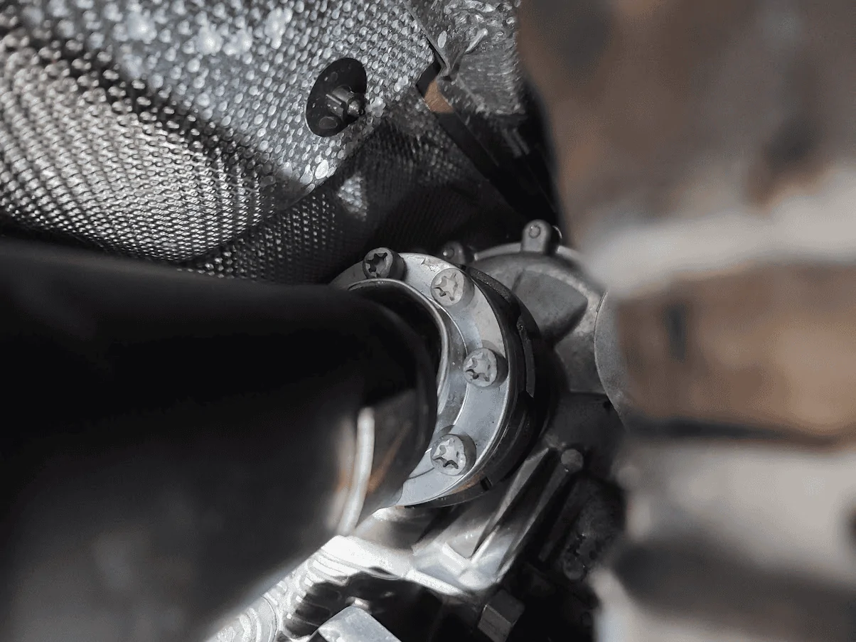

I was concerned they would try and blame the front driveshaft output. I bent the flange at the CV joint when I did my lift (lowered the axle toooo much! I was paying attention to the pinion side and not the CV/Xfer case side ?‍♂) The flange is warped a bit, but the CV boot is completely intact and there is no sign of fluid anywhere near the output.
Here's a pic... bonehead move (but the driveshaft still spins without any binding)

Update... Looks like an input shaft leak.
Jeep Gladiator PSA: For Anyone With the 6MT 1642690959873

Got it back this morning... seems to be good so far. Looks like the transmission output seal was replaced, same as @RodRecket. In my case, the leak was not the transmission (otherwise, in my mind at least, the leak would have been brown like motor oil not red like ATF) but they replaced that seal anyway.
They also replaced the input seal on the T-case, which is what is in my picture above with the bell housing and input shaft. I think that was the true root cause, but if they want "belts and suspenders" replacing both seals is fine by me!
