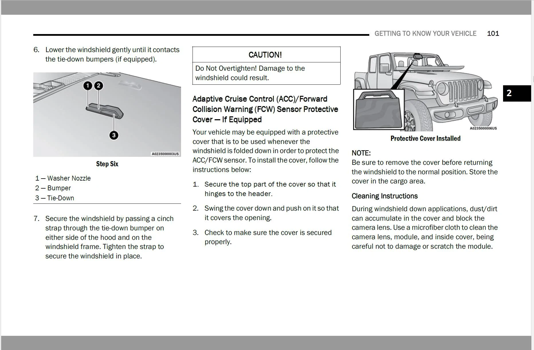

If I put the windshield down on my JT with adaptive cruise/forward collision — besides covering the module box is there anything else I need to do? Will the system automatically recognize this and shut itself off?

It’s a car cruise. I don’t need forward collision. I’m asking if I need to turn it off or if it will automatically turn off? I don’t want my truck beeping and at me nonstop bc it thinks there’s something in front of me bc of the cover. I would hope the system is smart enough to turn off automatically with the windshield down.

There should not be any wires connected to the actual windshield frame. I have lowered mine a couple of times. The wiper blades do need to come off to fully lower the windshield. My JTR came with a cover to protect the ACC module and camera.
Don't turn on ACC, no issues. You should be able to still use the standard cruise control.
And the adaptive cruise just recognizes that the cover is on and to turn off the system, I guess?
You have any seal issues or anything afterwards. I’ve read these newer models don’t have the same issues as the older Jeeps models.
I didn't drive with it down. I was running wires and having the windshield down made it easier.
On my JTR, I have the standard cruise control and ACC. I can use the standard CC or use ACC. ACC doesn't come on until you press the center button in the ACC switch cluster. If using ACC, I turn it on, set my distance and use the set buttons on the standard CC cluster. If using the standard CC, I turn it on with it's switch and set my speed. ACC doesn't do anything at that point.

Thanks, yeah, I keep saying ACC bc that’s the system but I’m really more so wondering if the forward collision is going to be going crazy with the cover on. I don’t plan on using any cruise control lol

The system uses both the camera and the radar. I would think that absent of a camera image, it won't do anything. Of course, you could just turn it off.
