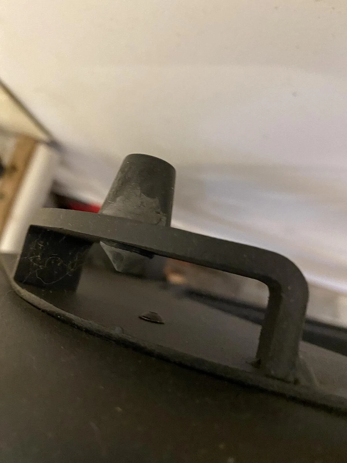

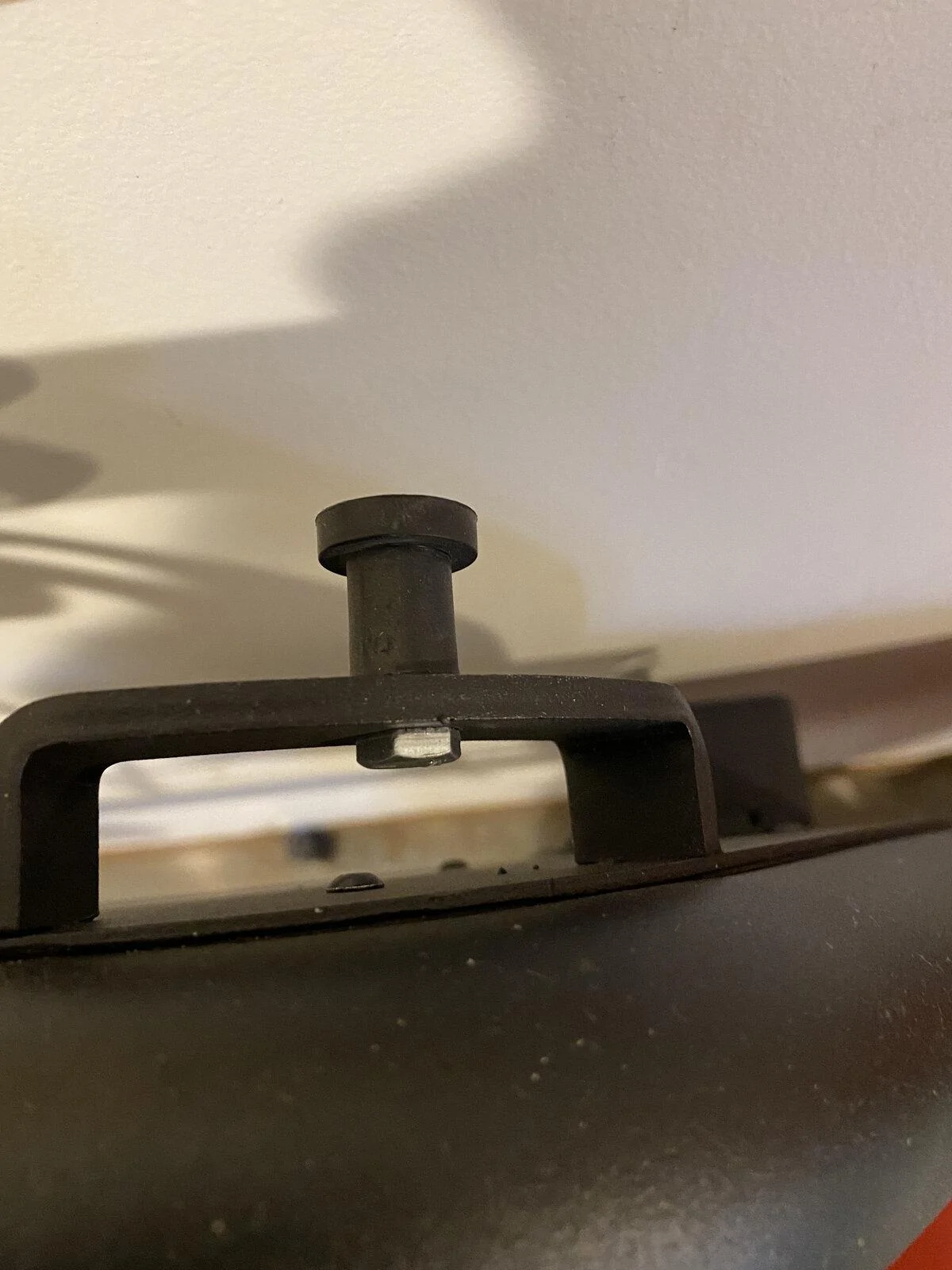

Yes, same issues on mine, the stop doesn't extend far enough to hit the frame. That being said it hasn't caused a big issue for me with vibrations (only on the passenger front door) but still annoying. Glad to see I wasn't the only one since I was confused when I watched the install video as well.

Another member who purchased them bought a larger rubber nub from his local hardware store so it looks like it should be rather easy to do that and/or just thread a new/longer bolt on there, might have to lop off the end of the bolt if you can't find a double male-ended piece. Either way, at least I know I'm not crazy and not the only one who had to make it work.
Here you go...
Jeep Gladiator Quadratec Tube Door Issues IMG_3508
Jeep Gladiator Quadratec Tube Door Issues IMG_3507
