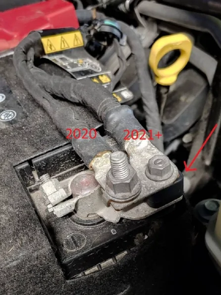

Yes. The monitoring of amps in and amps out is measured at the negative terminal. The item pointed to in red is the sensor, everything that comes out of or goes into the battery runs through this. It is always monitoring even when truck is asleep. If it didn't monitor when the truck was asleep, you could have parasitic draw and it wouldn't know how much charge to input back into the battery and could over/under charge and ruin the battery/cause fires/etc. This is why it's important to always connect anything to the top side of this battery connector and never at the post side.
Jeep Gladiator Question on IBS when trickle charging over a few days. gladi-bms
Also, ignore the years in the photo, thats for aux deletes on a diesel.

so I guess the question is how do you have it wired up? If through the IBS then if should recognize the state/ charge.
There is power available at the 7-pin trailer plug all the time, I have my charger connected to the pos and ground via this plug (make connecting the charger easy).
From reading JTdirtyD's response, it looks like the IBS can sense this and I'm good to go.
Thank you sir, this tells me exactly what I need to know.

Can you clarify rhe last three sentences in this post, not computing.
The black piece in the photo is a shunt. It measures amps coming out of the battery by systems using power, and it measures amps going back into the battery from the charging system.
To put it simply, it acts as a counter with simple math. Lets say your battery has 100ah (amp hours) of power. If something is using 10amps (measured per hour), then over the course of 1 hour the shunt will measure 10 amps removed from the battery, so the IBS knows your battery now has 90 amps remaining. Now put a 10amp charger on it (again, measured per hour), over the next hour it sees 10 amps going back into the battery, so its "count" is back to 100.
If you connect something to the battery side of the shunt, then the current isn't passing through it for it to measure and the IBS doesn't know how much power has been drawn from the battery. This can lead to a improperly charged battery because the counter is now off. Thats why it's important to always connect wires to the top side of the shunt, not the battery side. Everything power related has to travel through the shunt in order for the IBS system to work properly.
Theres more to it than that, but thats the simple version of how battery monitoring systems work.

Is this all stated by Jeep or is it a theory? I don't know the facts about IBS but I believe the IBS does not "count" how much current goes out vs in and instead when you start the vehicle it comes alive and measures battery voltage and charge current to know the approximate battery state of charge at that point in time. The amount of current out vs in is not the same as it takes a charge about 1.5X what you take out to charge to 100% and that will vary with battery type and age which the IBS is not aware of.
