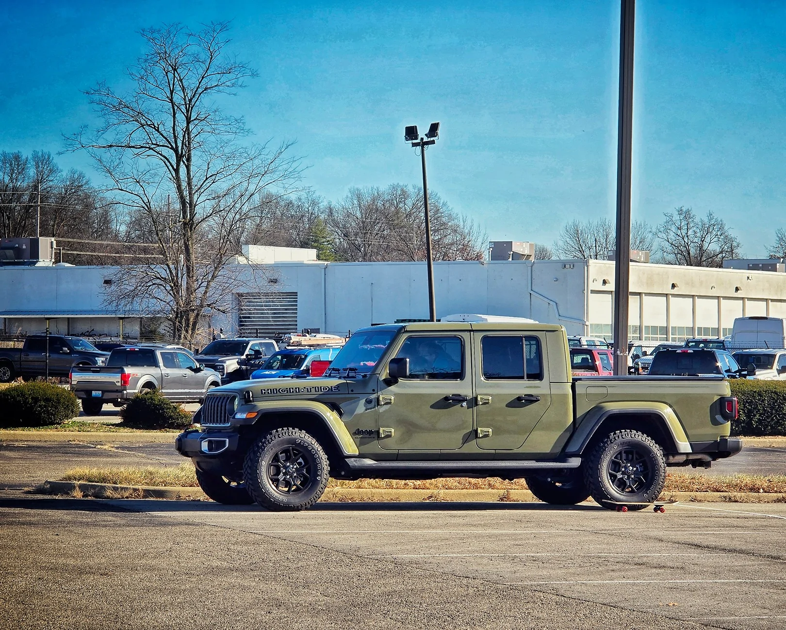

I've got the sport fenders and just did the leveling kit a few weeks ago. Really like it!
1.5" Teraflex leveling kit. This kit has the option to do 0.5", 1", or 1.5". I did the full 1.5" to get best value for my money.
I measured my truck a few different ways and averaged them altogether - By my calculations before leveling my rear sat 1.9" above the front. Now after the level install the rear sits ~0.3" higher.
I love the look, the suspension rides the same, my skidplate/splash guard has better ground clearance. Only negative is perhaps a tad more wind resistance.
IMO if someone made a 2" leveling kit I would have gone with that AND the 0.75" rear kit. THAT would be the perfect combo.
FWIW, I come from a "truck" background, not a "Jeep" background. I didn't initially have any interest in leveling kits and shared a "trucks are built for rake" mindset. However, every time I saw a Gladiator with a stance I really liked, it turned out the thing had a leveling kit on it. So while I agree theoretically with the leveling-kit-haters, in practice they just work.
Do it!

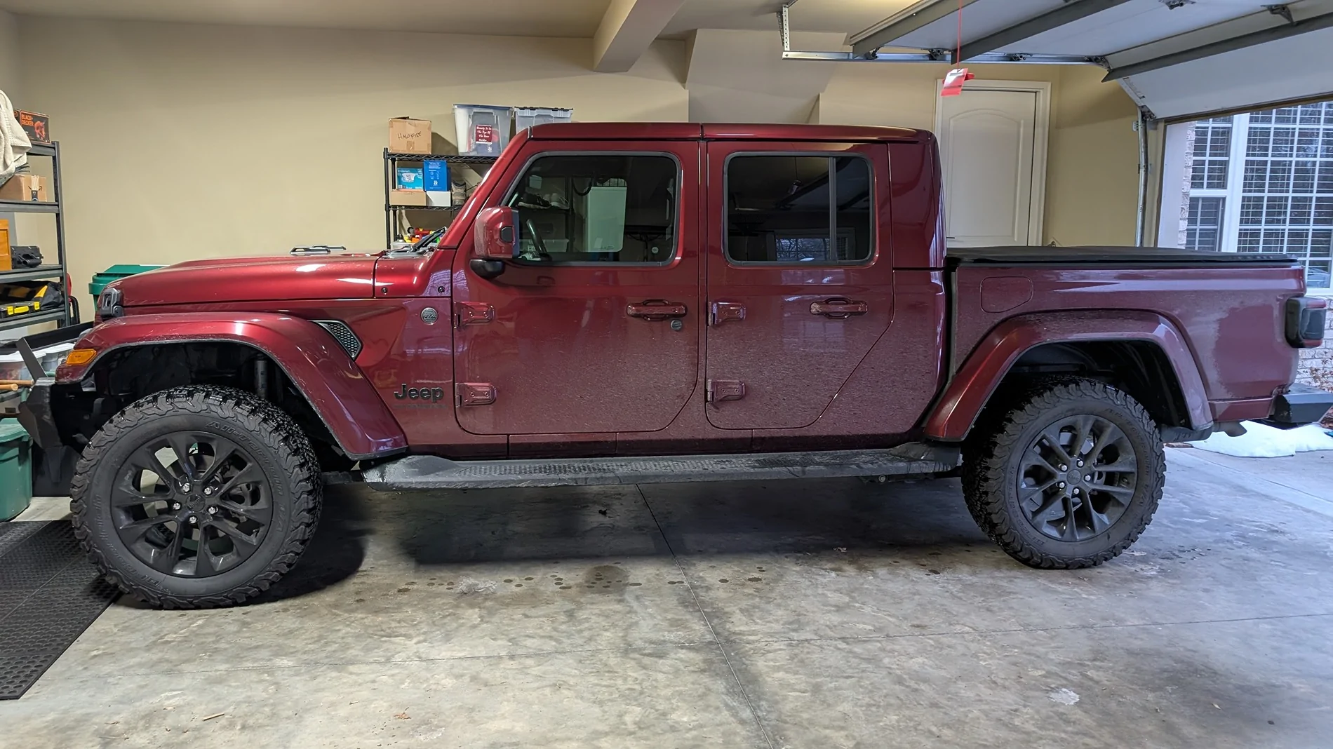

Just did a 2.5" leveling kit on our High Altitude. I was a little worried about being too much, but with steel bumper and winch it got the stance where I wanted it. Running 33's now.
Added "after" picture but can't find a good before picture.
Jeep Gladiator Question regarding leveling kit 1000004302
Photos or it didn't happen!!
