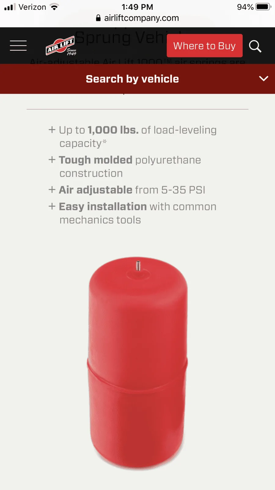

Shadow what about using an airbag helper spring? Like this? I have one on my ram 1500, from back when I trailered my old wheeling rig. If I put it on the trailer a little to close to the truck it would sag it. Put these in and all was good.
I appreciate the tips, helps, etc. thanks - at least those work with the springs and spring supports and a person could route the hose to a single point. Install between the coils, plumb them, done.
I prefer to not add things that I'd need to maintain or deal with - adding air when hooking to a load, getting done, letting it back.

IF I had to go this route, I think I have an old Eagle automatic leveling system (minus the shocks - I don't like air shocks) that a person could hook to the bags and there's a link that runs a compressor if needed. I may even have the compressor and switches and harness.

I put these on my Ram somewhere around 2012, found a pressure that worked all the time and left them there. Haven’t touched them since. Just a thought. I might be doing these if I decide to get the overland instead of ordering the sport s.
I used those on my 07 Toyota Seqioa worked awesome very easy to air up & down

Am working on spring options that I think will resolve my own needs and "issues" with my Overland - but I did visit their site and agree - using the hose/line kit a person could round the filler to a convenient spot and fill, or release air, in seconds.
It's still an option I guess - prefer the spring route but "options" or "plan B's" are never a mistake.
oh I agree with you , I also owned an Excursion that was a great tow vehicle but it would always squat a little at the rear when towing probably could have used those bags but never caused an issue ever towing.
