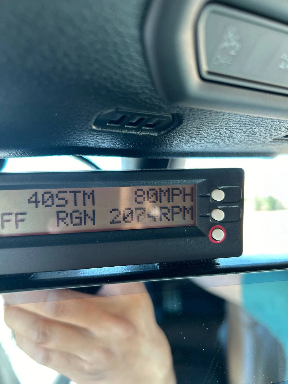

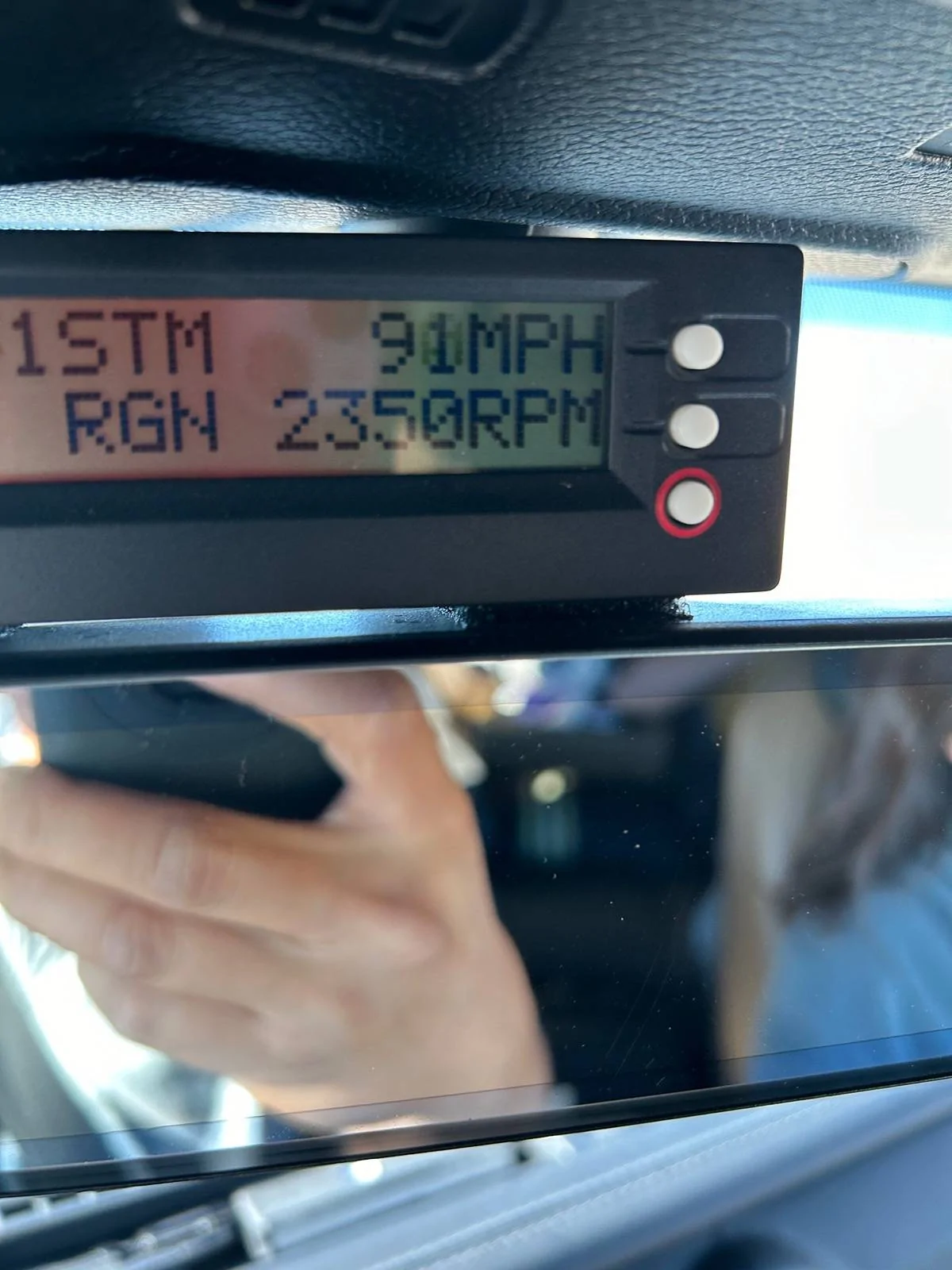

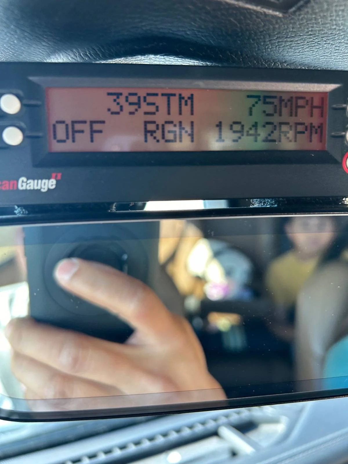

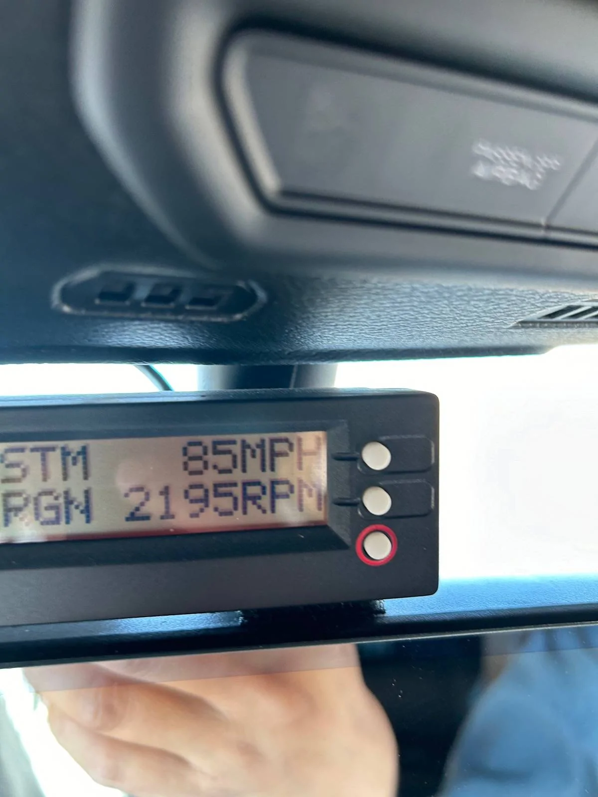

This question pops up quite often and no one will have the correct answer for your usage needs. But, here are some data for comparison with what you're currently running. I took these reading after a few seconds holding at those speeds.
Diesel 4.10s on 37s that has approx 25k miles, so the rpm might be slight higher due to worn tires.
Jeep Gladiator Re-gear JT Rubi on 38/40's?? IMG_0213
Jeep Gladiator Re-gear JT Rubi on 38/40's?? IMG_0212
Jeep Gladiator Re-gear JT Rubi on 38/40's?? IMG_0210
Jeep Gladiator Re-gear JT Rubi on 38/40's?? IMG_0209
Thank you for the input and the data to show. Very much appreciated.

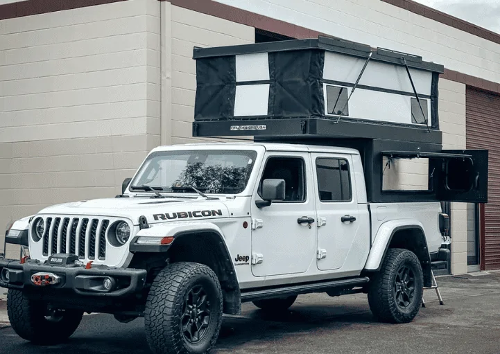

I think the 4.56 will be the way to go for me cause I am really considering go to 40's, I forgot to mention I do tote around the decked drawer system stuffed & at some point will want to add one of these too.
