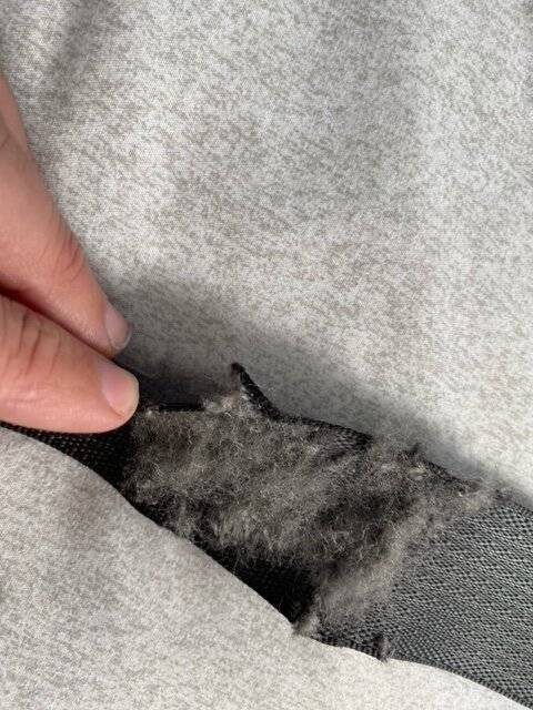

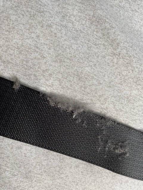

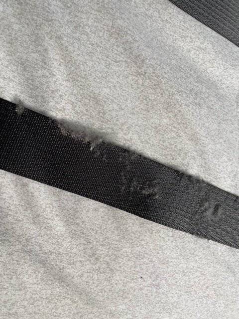

Here are some pics of the other belt. The damage here are slightly different.

I truly think this damage happened down near the retractors themselves, and there's probably something either on the retractor or nearby on a vehicle panel that is wearing through the belt. With the fray lines happening at your ~6" intervals, it tracks that something rubbed (or chewed, ie a critter) through the multiple layers of belt wrapped on the retractor. I'd seriously consider having your mechanic (or even better Jeep Tech so they can document it) look it over so it doesn't happen again to your new belts.

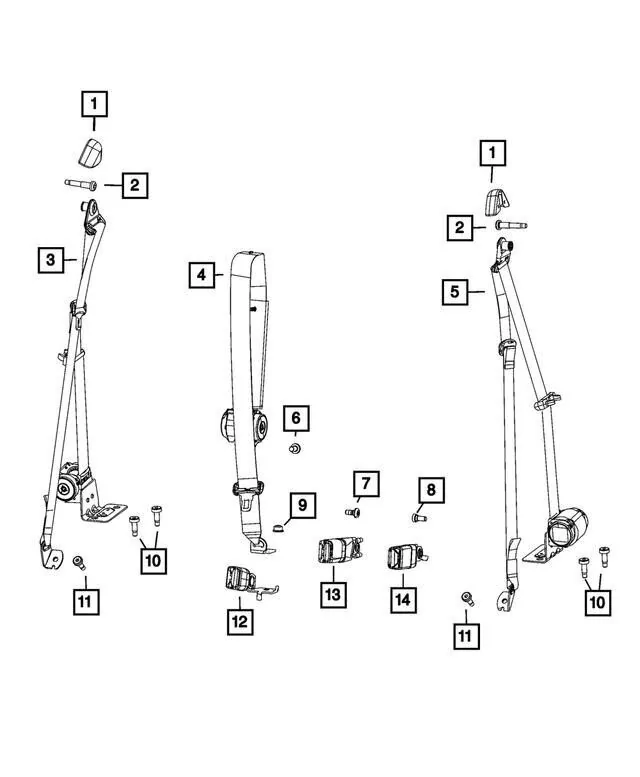

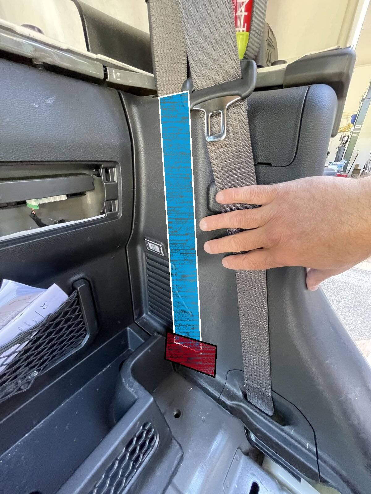

Here's the seatbelt diagram for the rear belts in the JT... there's really no way for someone to reach the retractor with all the body panels in place. And another pic showing where the belt (blue highlight) passes down to the bottom of the cab where the retractor mounts (red).

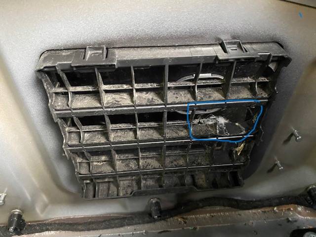

Ok... so today we finally figured it out. A few days after the repair my 6 year old tried to use the seat belt and it was ripped again. WTF. That night, I also noticed rat shit on the floor- so I set a trap and killed the rat very quickly. The next day I brought the truck back to the mechanic and he was dumbfounded. He took everything out and saw more rat shit behind the seat AND this plastic vent that goes to a small space behind the truck bed. The rat had gnawed through this vent and gotten in the car. It was eating the seat belt. It also chewed threw an antenna wire that is back there.
So- it would seem this is not a safety issue at all... but just a bad design maybe? Now I have to pay for another set of seat belts and more labor to install.
While I'm happy its not a safety issue... im still extremely frustrated at the Service Manager of my local Jeep Dealership. He was so confident that my imaginary fat relative had sliced the belt with a razor blade. Had he taken the time to inspect the area- this all could've been avoided. Also, wtf is someone designing a plastic vent like this behind the seat that can be so easily infiltrated by rodents? A mouse could get through here easily too.
The mechanic recommended I try to place some type of maulable chicken wire over this vent (there are 2 actually) to prevent more intruders.
