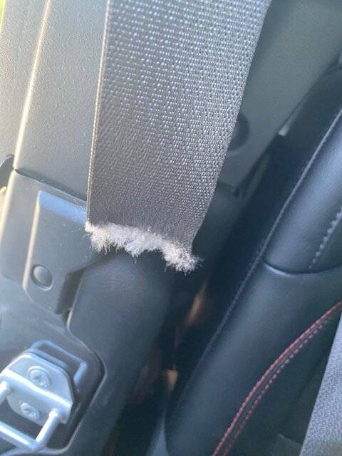

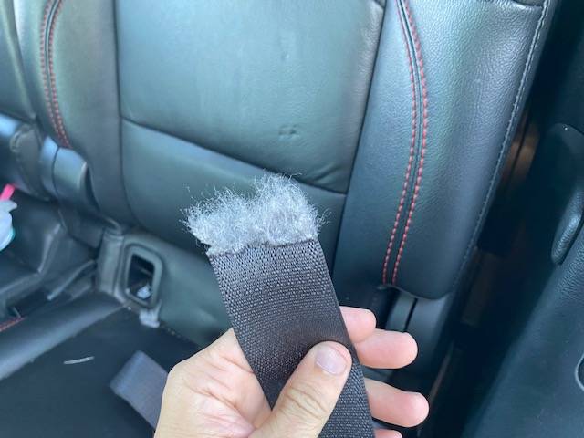

This is what both sides look like
Did they rip ? Or is that possibly the end and they pulled all the way out ? I've never seen the "end" of the belt inside the houing... so just a thought.

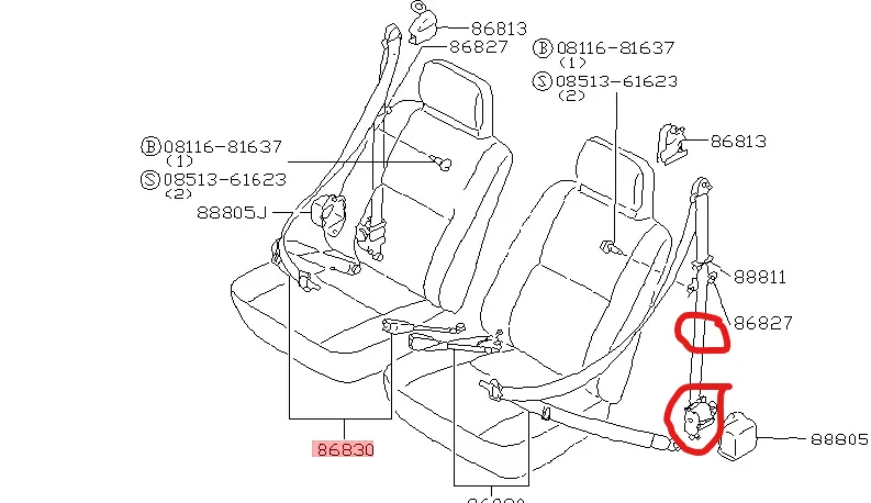

So... i think i ripped in 1 of 2 places. Below is a diagram i found online. The red circle is where the potential rip occurred. I feel like it is prob more likely that it ripped where the strap attaches to the spring retracting device.. but i really have no idea because all of this is behind a plastic panel.
That's what I was thinking... just never seen it in person.

DUDE. THats really weird. Friction would show melting wouldn't it?
JRobes
Oct 27, 2019
947
1,505
South Dakota
Enginerd
If it were a fast aggressive friction yes, but if this was caused by repeated soft abrasion by some hard edge inside the panel somewhere I'd think it would look exactly as his pictures show.
I wonder if the jeep engineers changed a part's design behind that panel and it caused the abrasion on the seat belt, might make sense if the part was changed on both sides and it wore through evenly on both belts.
Or maybe something is just assembled incorrectly inside the panel on both sides?
