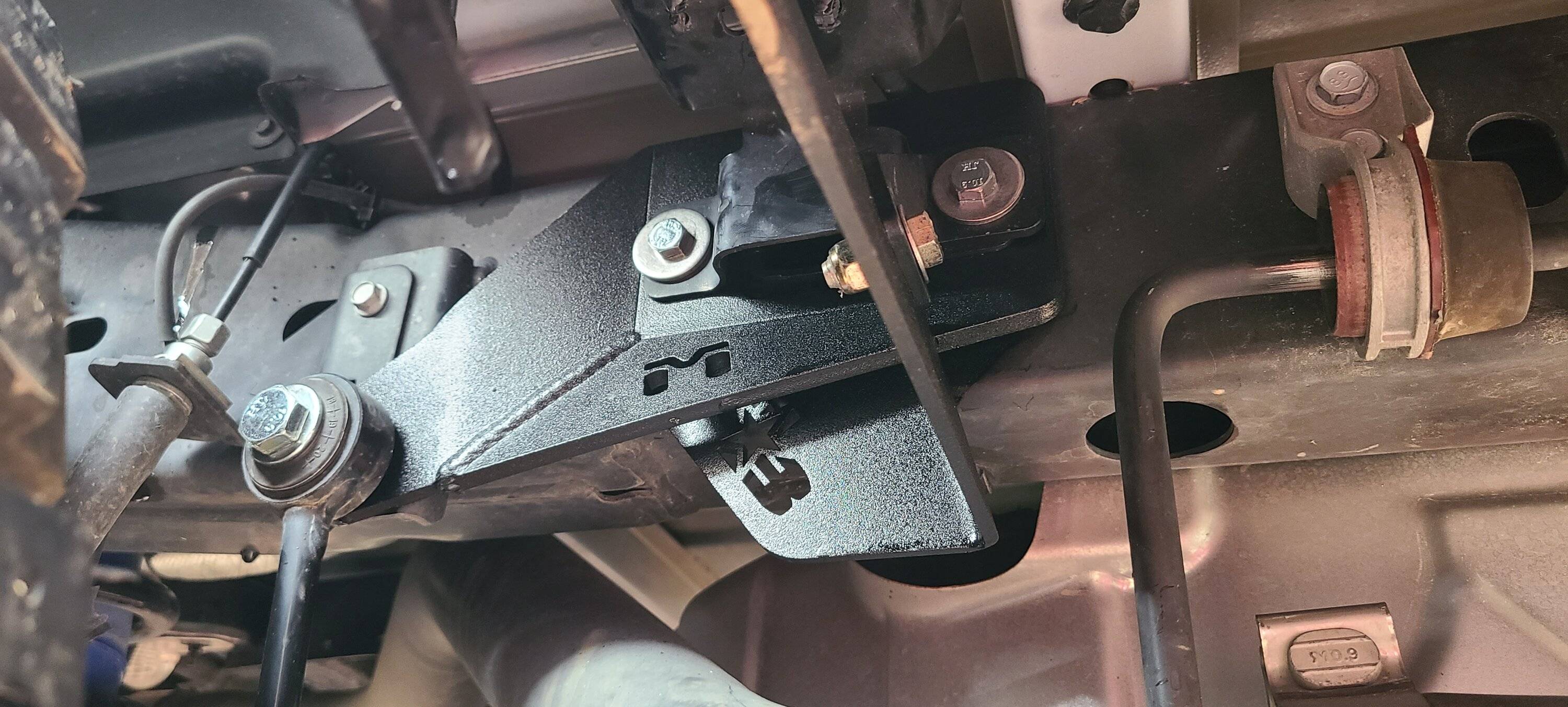

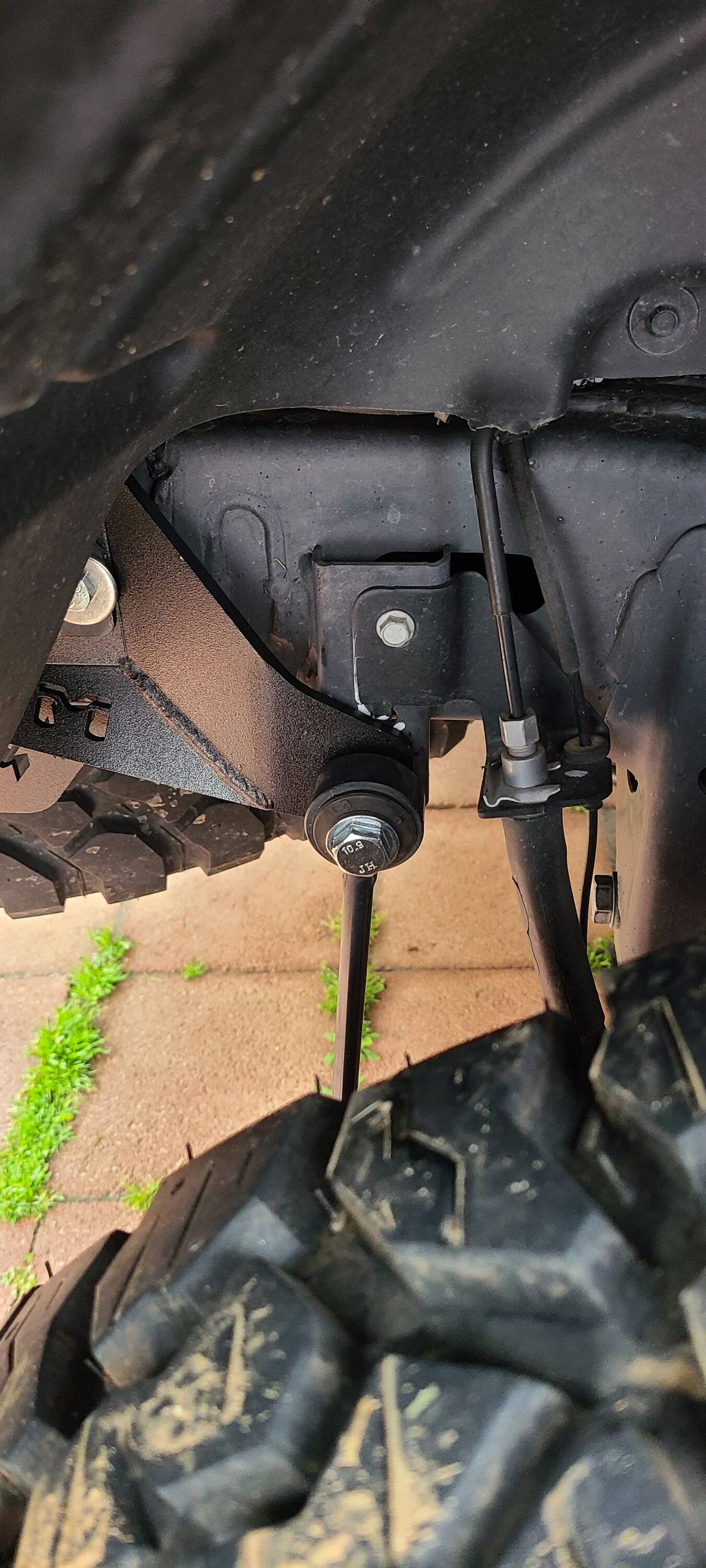

I took on installing the metal cloak braces today. I saw in some of the older posts that people had to buy longer bolts for the end links but two of those bolts were provided in the most recent kit. The only issue I had was that one of the two smaller stock bolts snapped when I was tightening it down. I went to the hardware store and grabbed a new higher grade M8 bolt that was stronger and about 10 mm longer paired with some larger washers. Luckily I had enough stud still sticking out to pull out the broken bolt. But yeah super happy with how these came out.

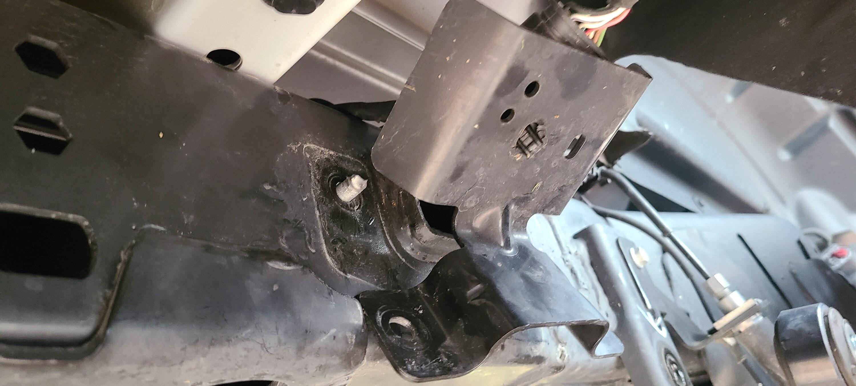

It's been awhile but as far as I remember that if you buy the current edition of the kit there was no modification needed.

Get them Bobby they will fit but you might have to make a little cut in RockBlokz bracket , that had no effect on mine over the years . A lot have that what looks like a cut, I think mine were that way from factory also.....Jack
I did post pictures of what you have to do to make them fit, little searching should find it.
